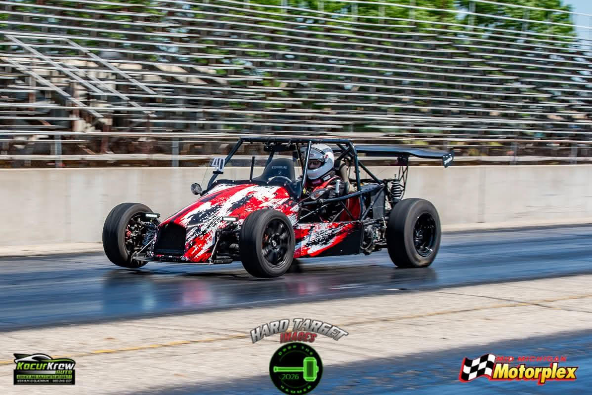

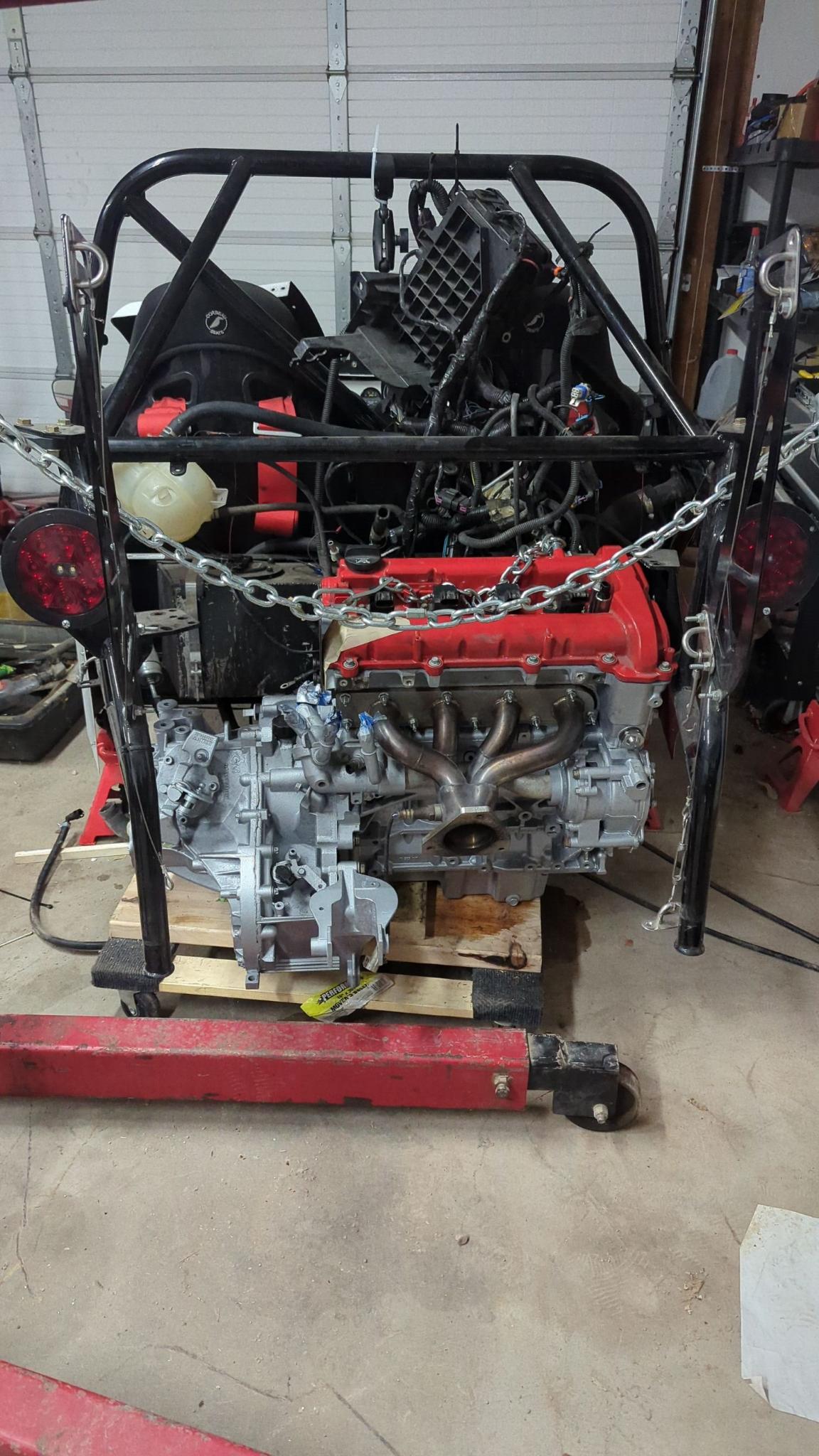

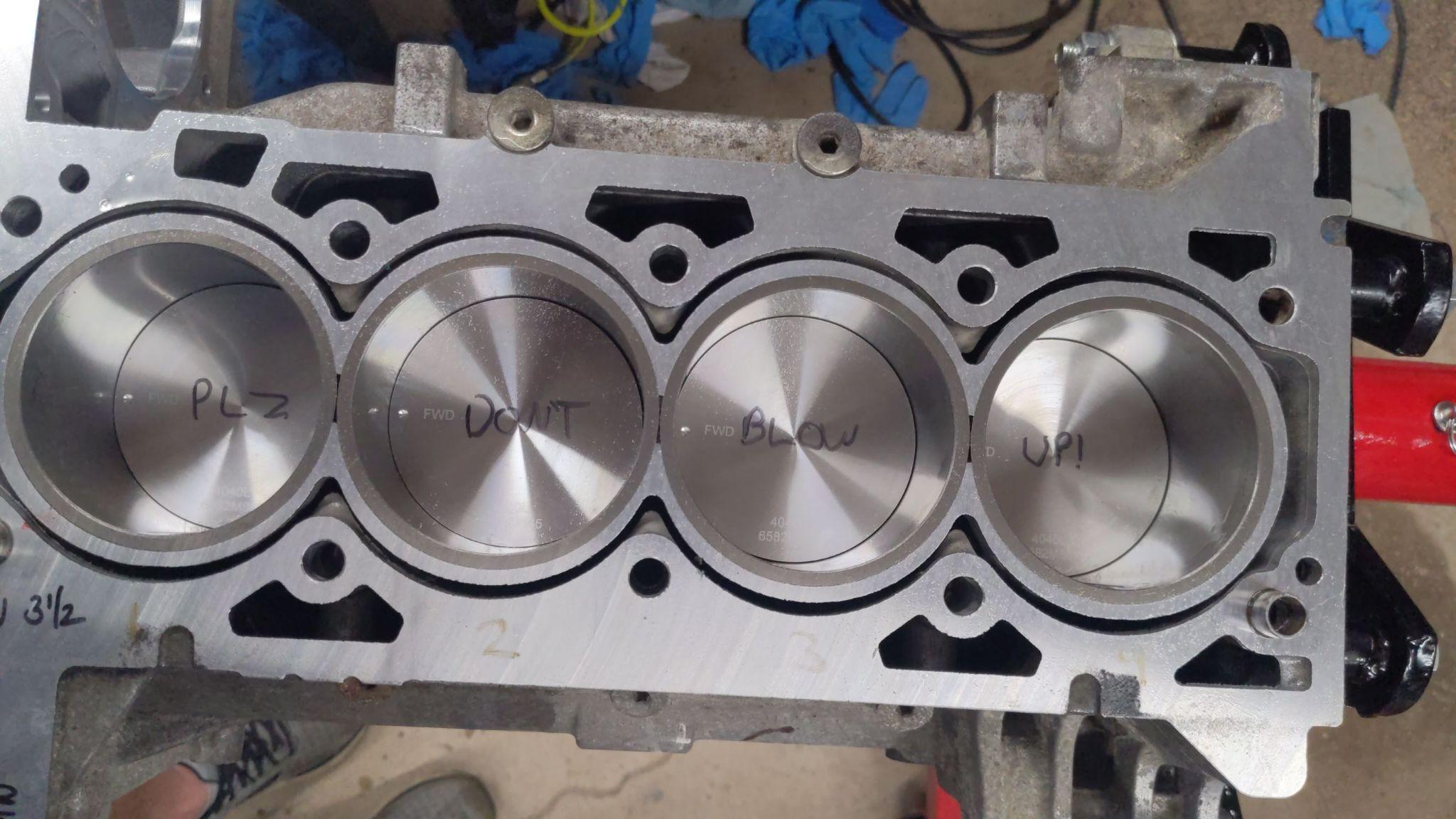

- Forged internal 2.2 that's been N/A, M62, TVS, and now turbo (~350-400hp)
- Folding hood working with a front splitter
- Custom 3d printed dash
- Drag racing oriented setup with slipper clutch and 2 step
Any memorable trips, races, or events?
- Sick Michigan Miles 2025
- Drop the Hammer 2026 (2nd place Stick Shift Class)
