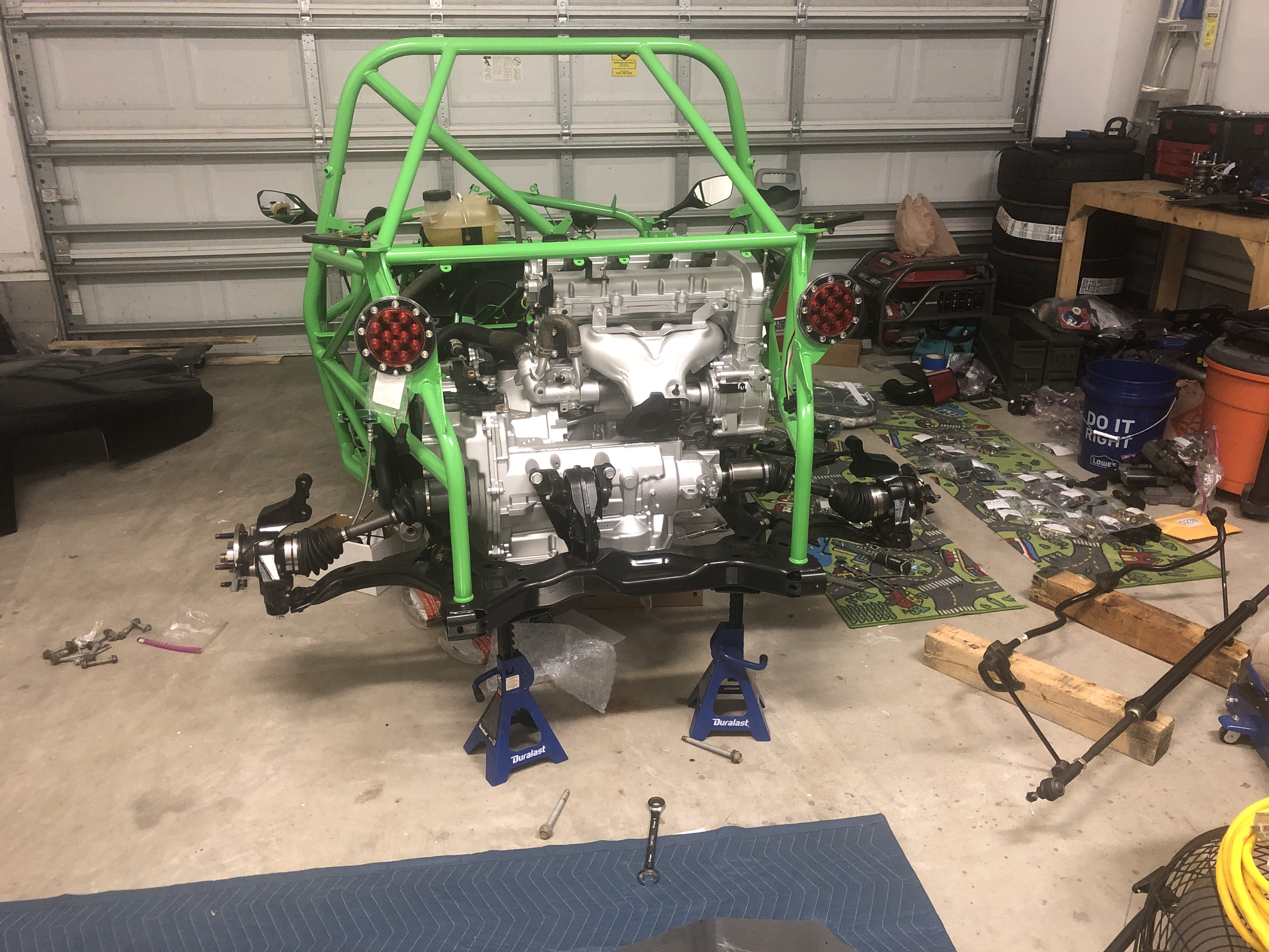

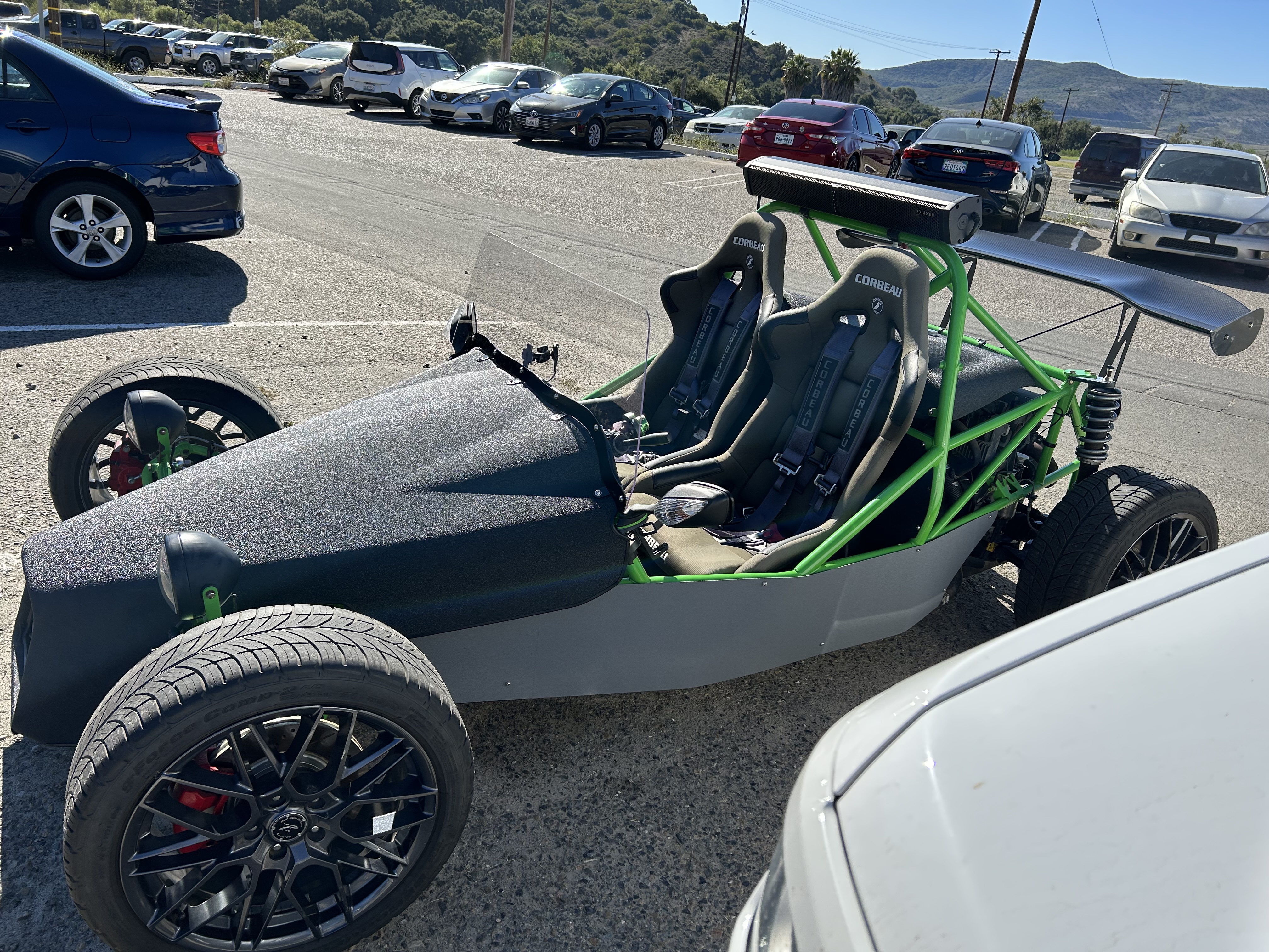

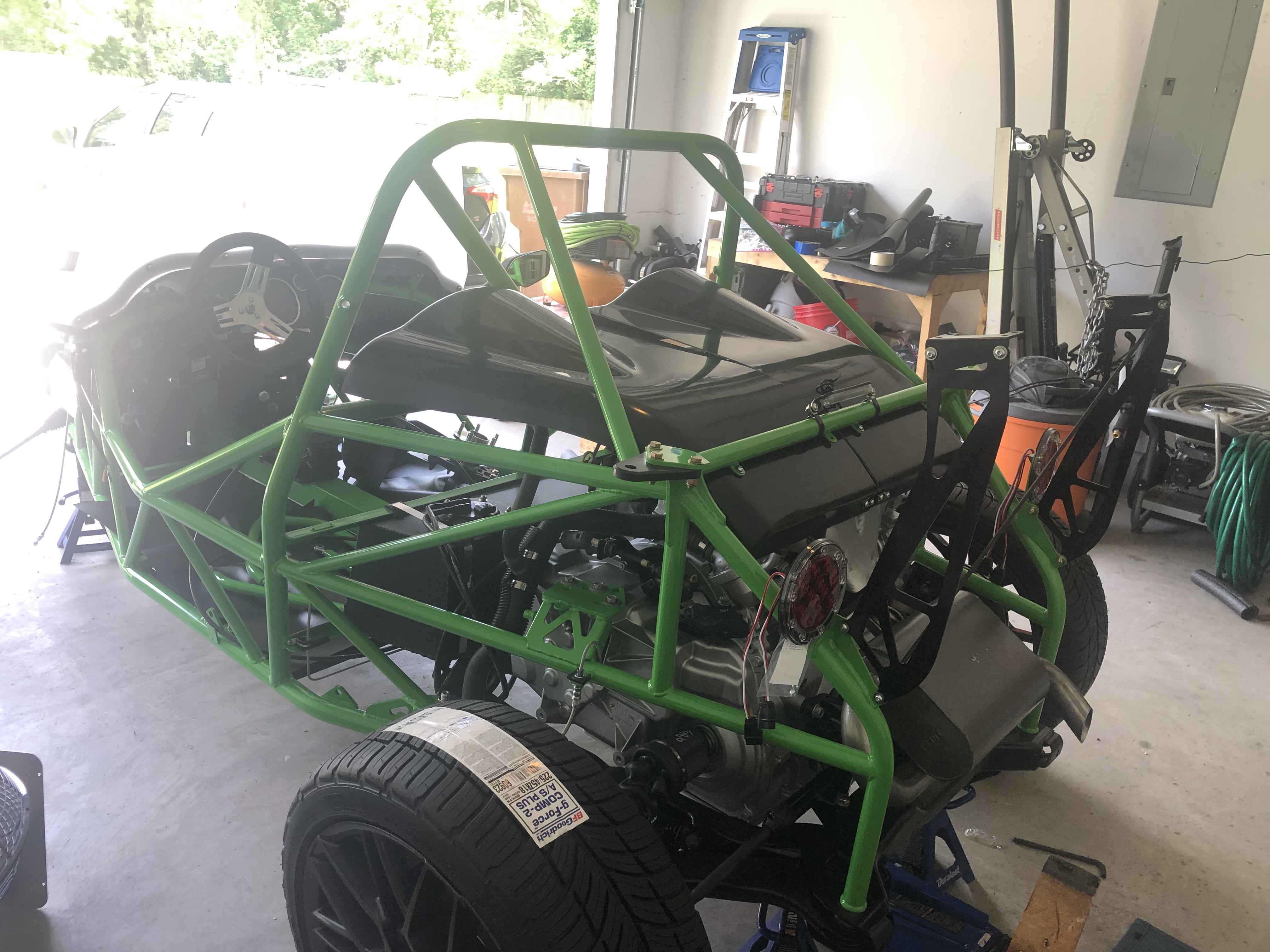

It was originally a 2.2l N/A that has been supercharged with stock internals. The rear engine covers have been cut to allow the removal with the water to air intercooler. A small oil cooler has been installed behind the seats above the gas tank instead of just looping the system.
Any memorable trips, races, or events?
I have driven it across country multiple times through questionable weather when going to and from duty assignments.
Favorite aspect (design, performance, or community)?
I like the rear engine concept and the ability to make easy repairs or upgrades.
Any future plans?
Need a better tune and will probably upgrade all of the internals to support higher boost pressure. Need to do research to see how compatible my frame is to add a manual transmission.

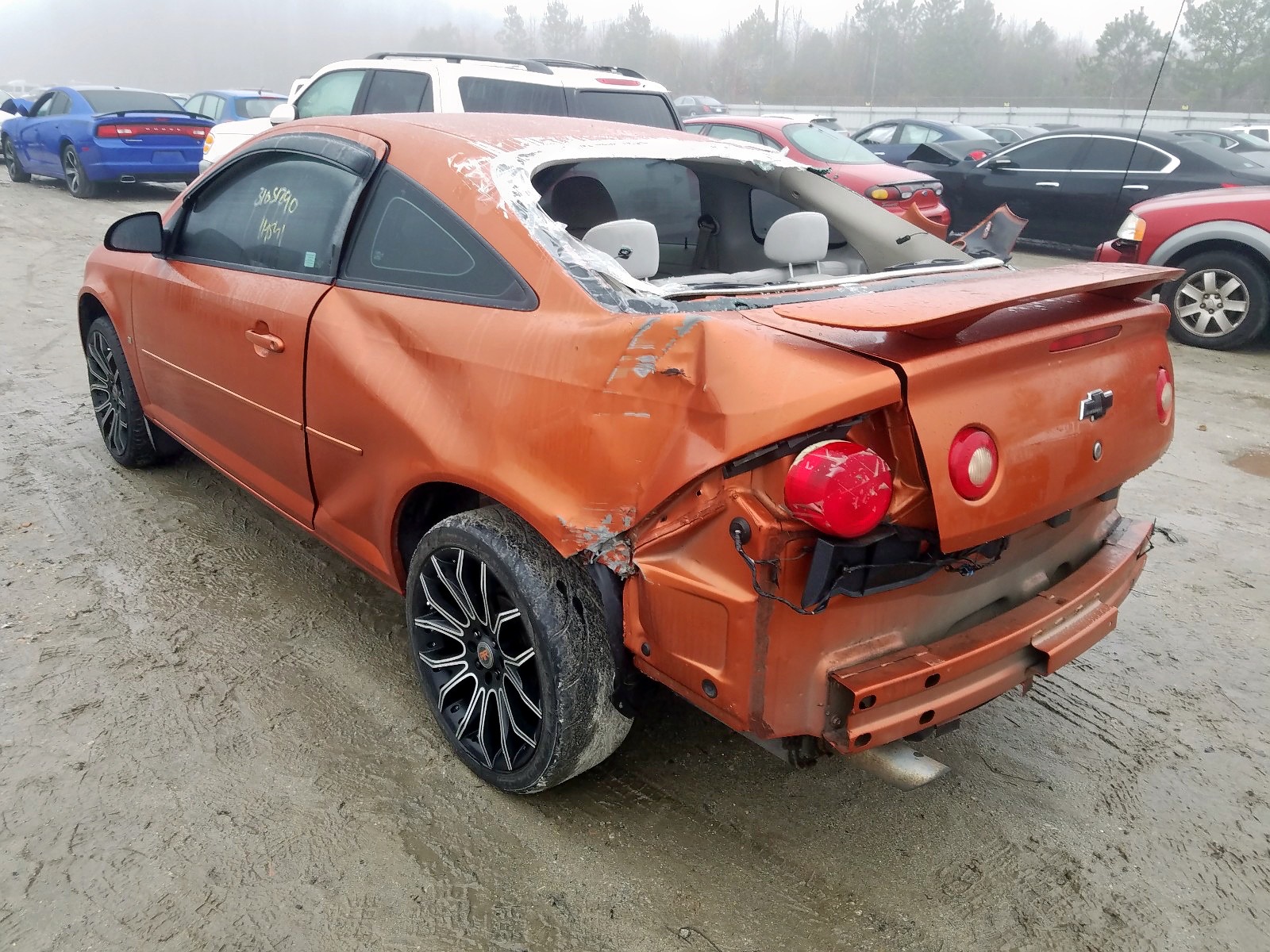

2007 2.2 Automatic Cobalt
Mileage at teardown
115,000
Where you bought it
Virginia
When you bought it
2020
Condition when you bought it
Salvaged
