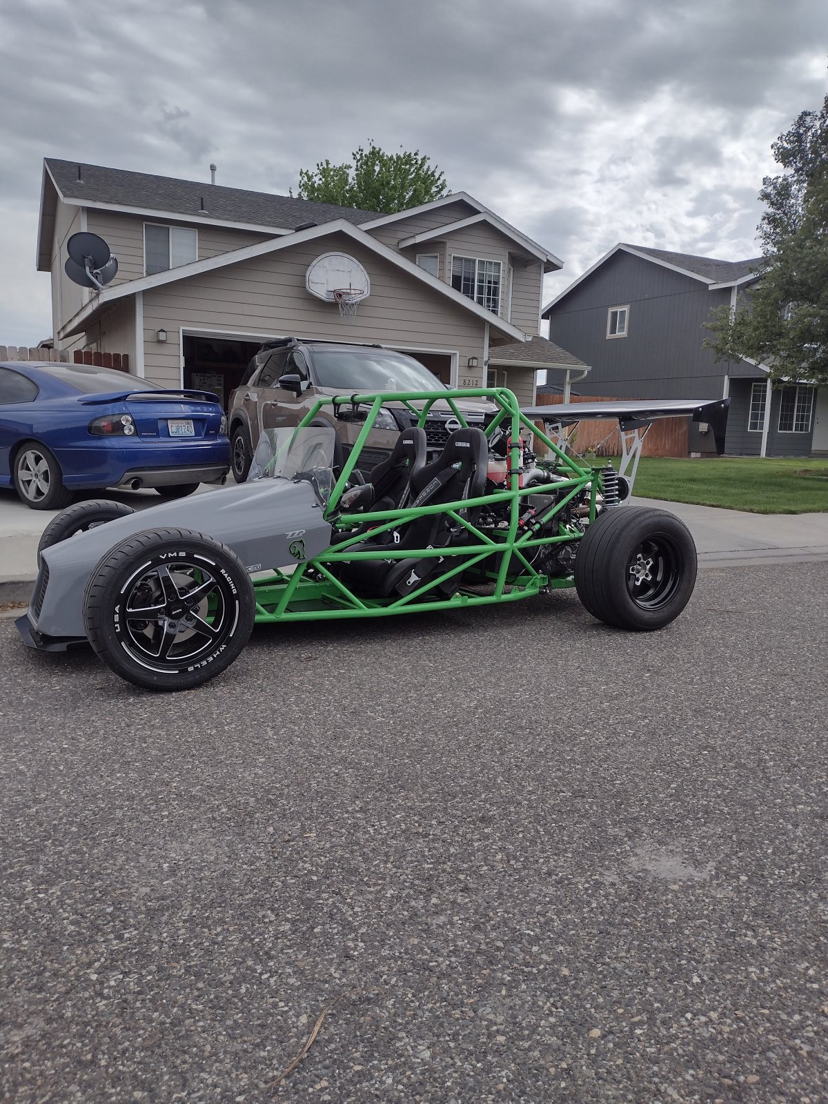

What have you modified that sets it apart?
Forged 2.1,balance shaft and water pump delete, 82lb valve springs, GTX3576 @28psi, E-47, ZZP stage 2 cams, LT1 fuel pump. F23 transmission with Quaife LSD. Plenty of other mods.

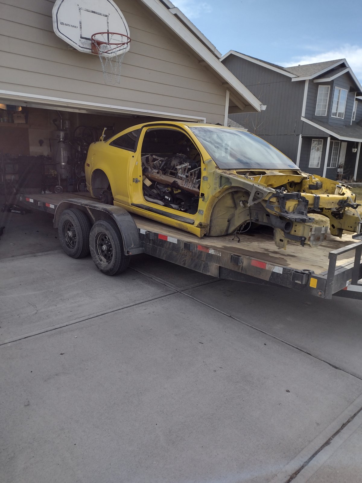

Donor Info
Donor trim
2009 2.0 SS/TC Cobalt
Mileage at teardown
155,000
Where you bought it
Arlington, WA
When you bought it
2/2023
Condition when you bought it
Highly used
How much you paid
3,200
Donor status
Stripped
