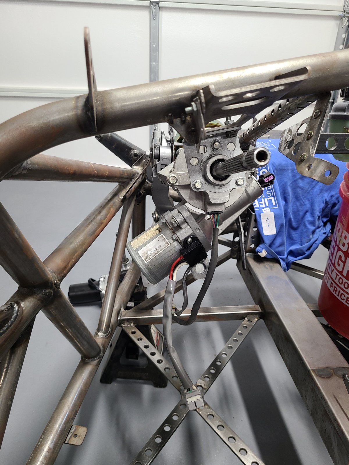

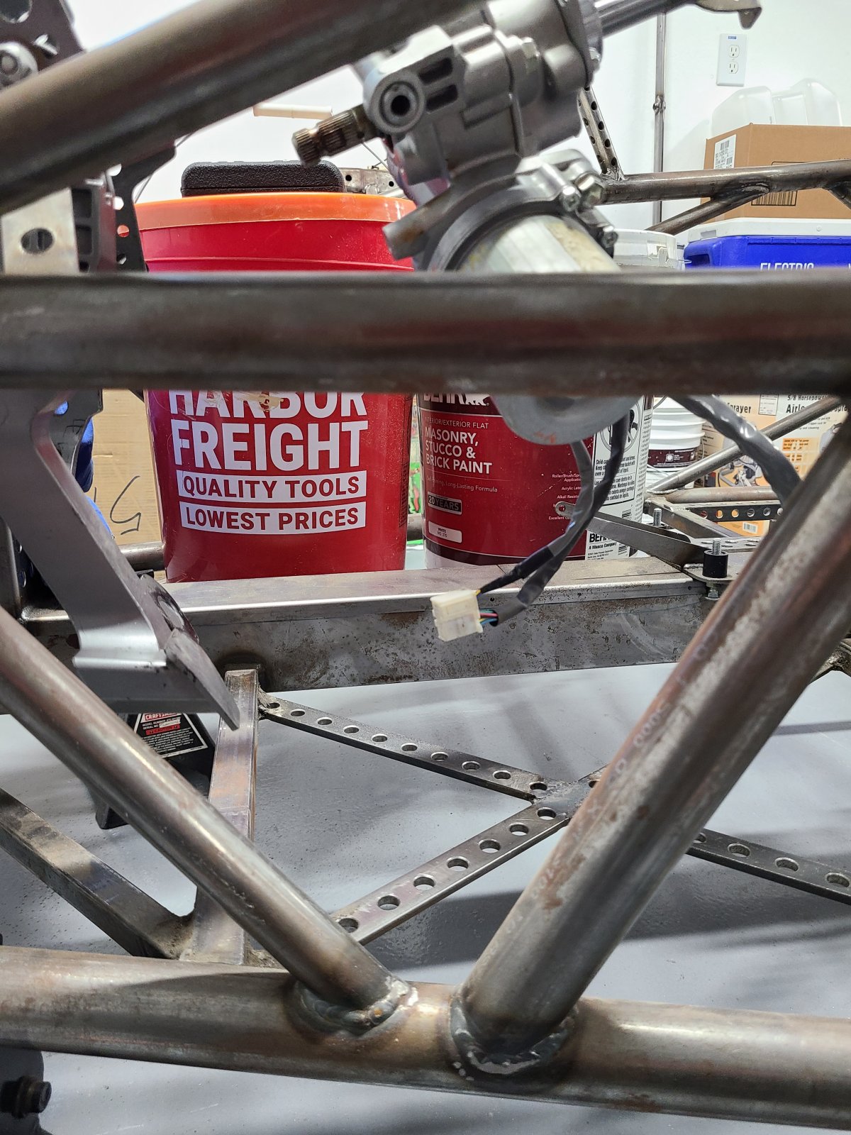

Back to the Vue EPS, seems the holes to mount the DF bracket are rotated out about 45ish degrees. The Vue EPS motor hangs down quite far compared to the Cobalt EPS. It is too low for my squatch feet! Make a new bracket?

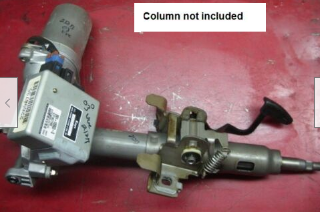

Hmm, your correct, it does look different. Bought off ebay (of course), was listed as '07 Vue EPS. Now that I compare with Rockauto listing, it looks like a '08 and newer Vue EPS. Dang, and it's been too long to send it back - face palm - should have double checked this before. Now I need to get funds to purchase the right EPS, and get this one sold. The fun of building a car!!!
