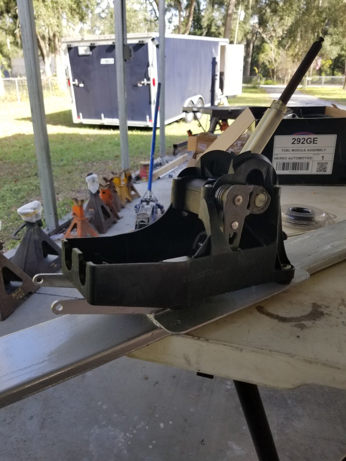

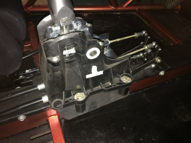

My doner is an 05 SS/SC. Looking at my shifter, it looks like I have to cut a lot of the front of the housing off to clear the metal ears on the tunnel cover. As always, I searched the forum, but did not find any mention of this. One picture showed a shifer that looked like it fit without cutting. Anyone experience this?

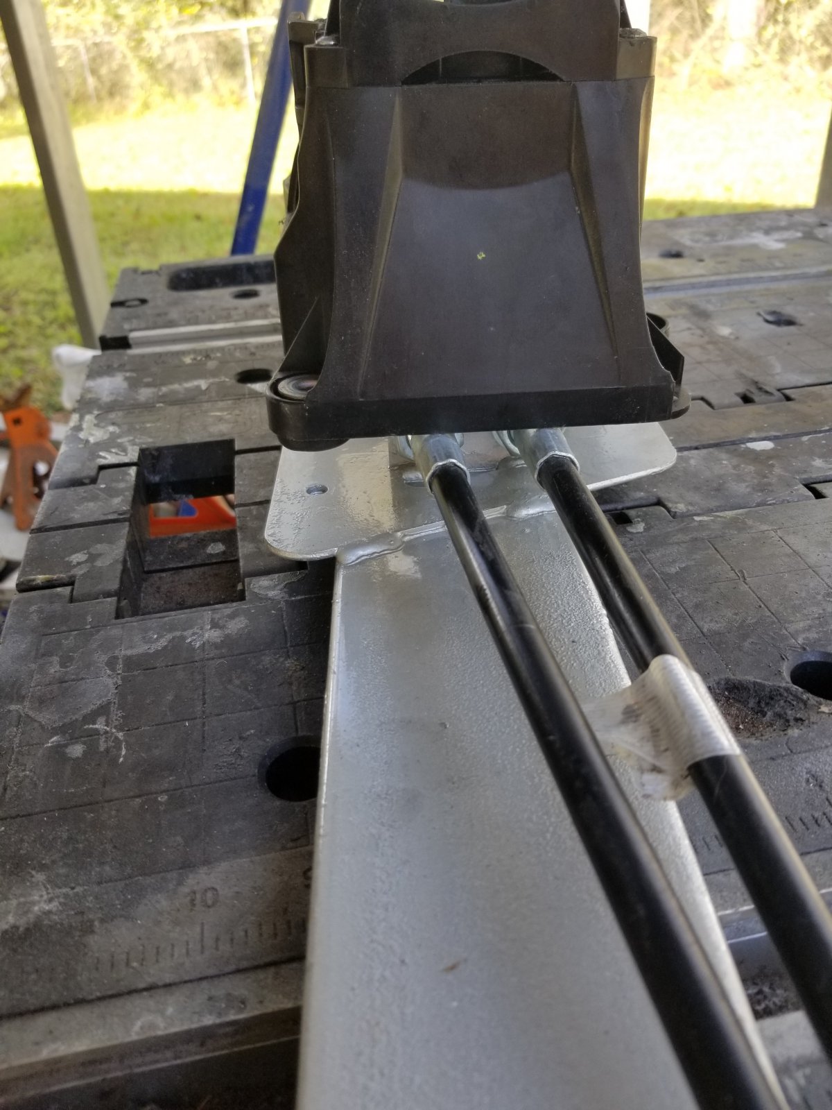

Looks like I will have to cut the back too. See picture. HASN'T ANYONE HAD TO DO THIS!!!!

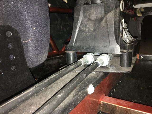

J

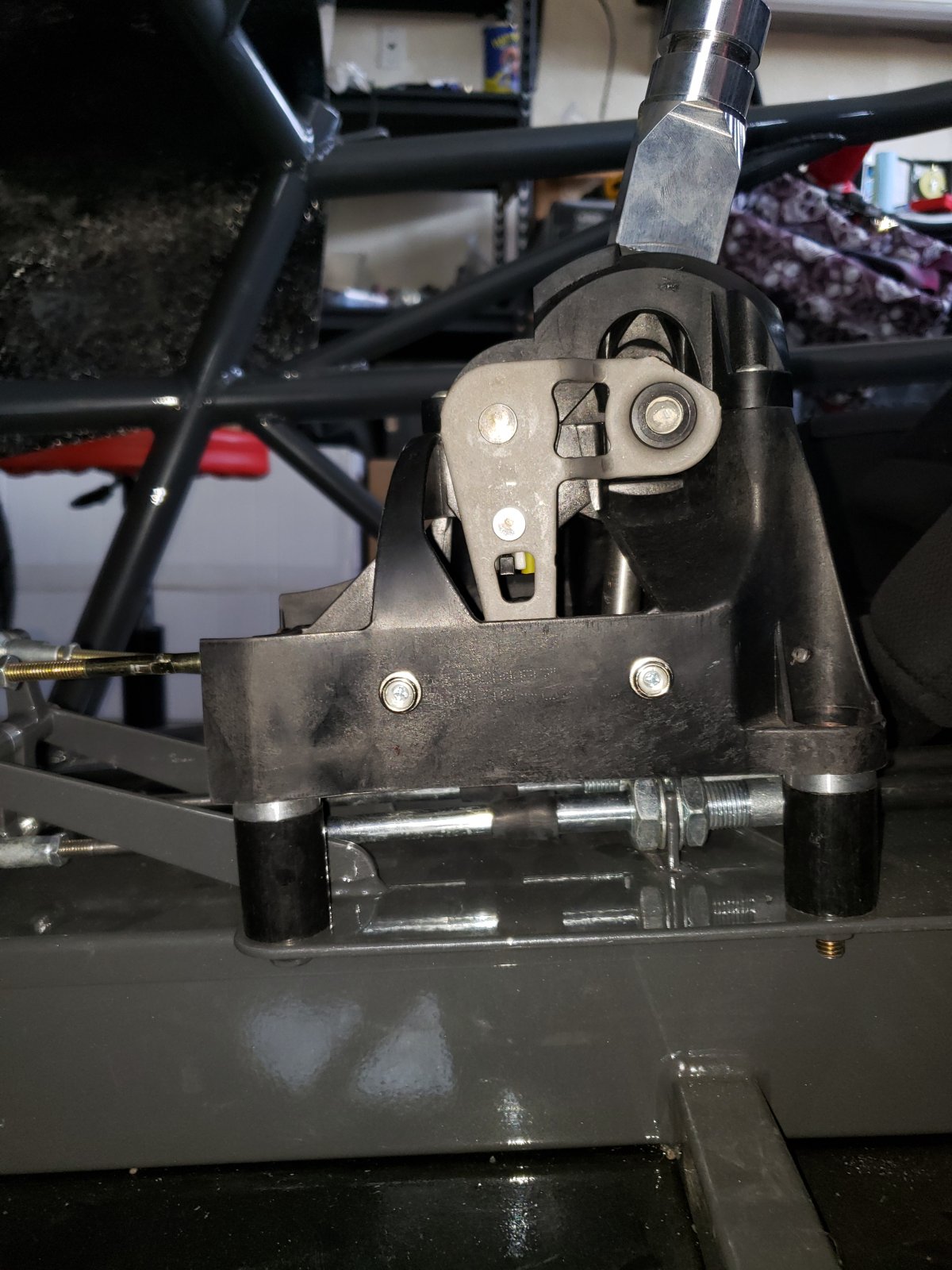

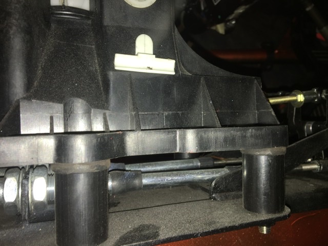

There are 4 black plastic spacers that go under the shifter to allow the cables to run under it. And yes I did have to trim the front

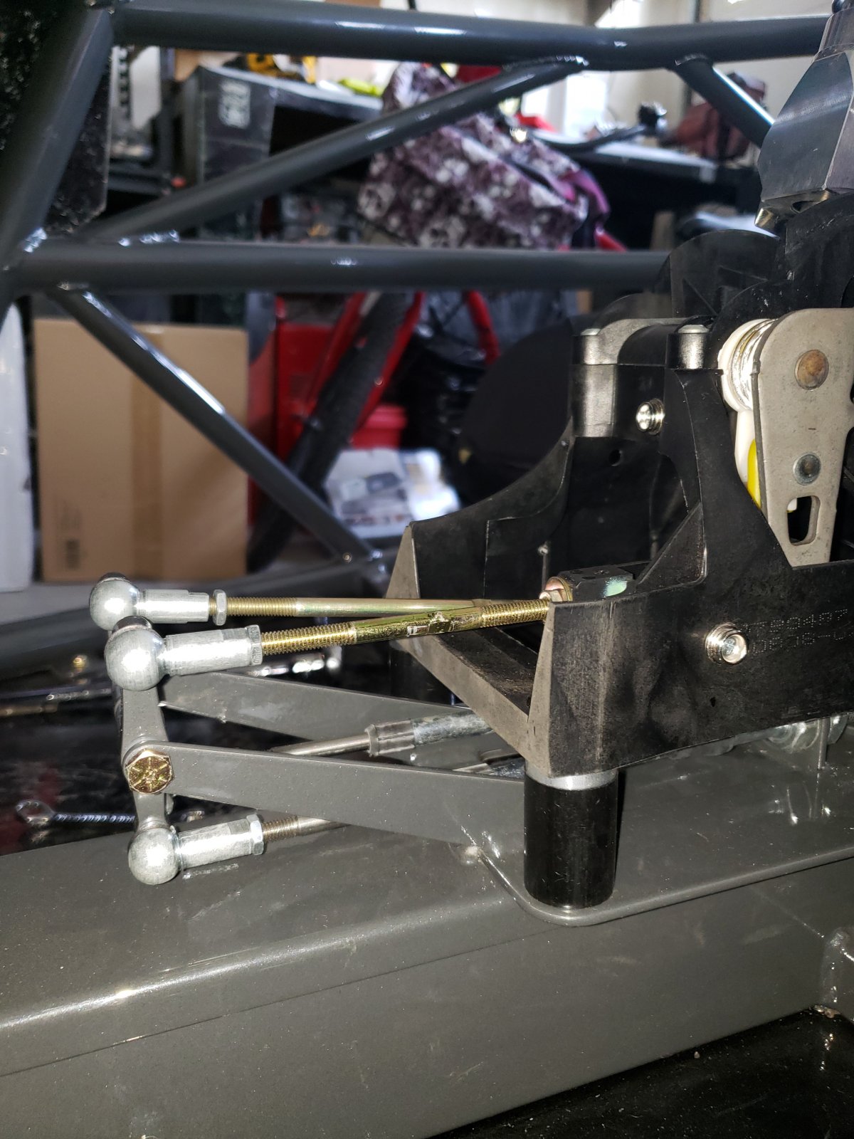

Ok, I finally figured out how this works. There is no left hand thread rod ends. You reuse the plastic original ends on the LEFTHAND THREADED ROD, using the DF hardware, which consists of a spacer, and 2 washers and left hand nuts times two. One washer would not fit in, so I substituted a smaller one. Its tricky, an exercise in patience assembling these things!

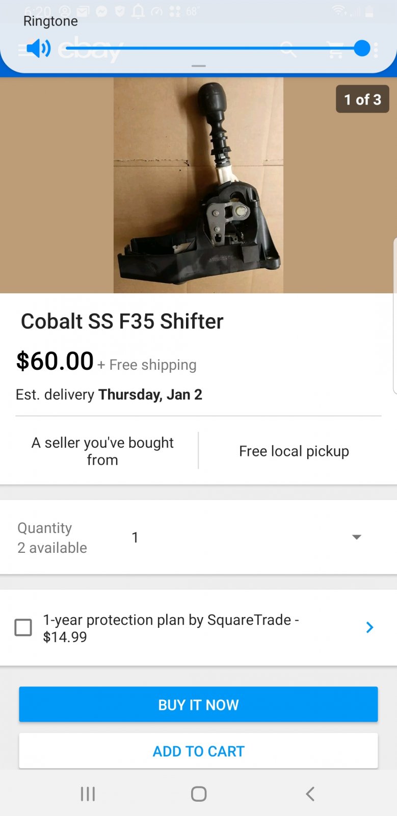

Sorry to hear that. There is probably one cheap yo Ebay.
