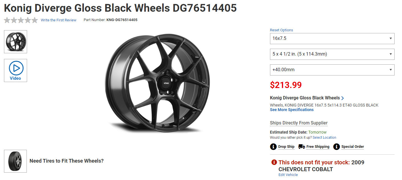

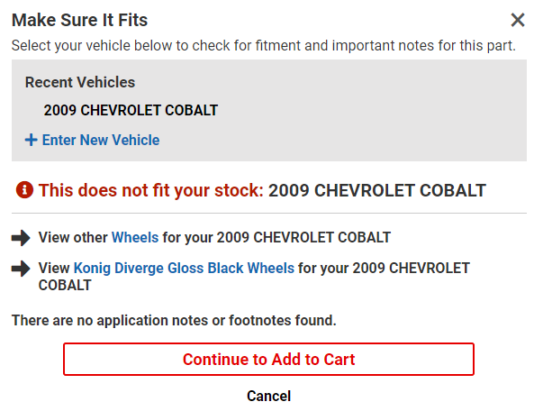

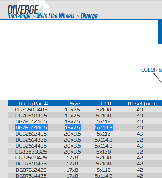

I am attempting to purchase wheels and tires for my goblin but the first hurdle is, I really don't know if these wheels I like will fit. Summit says they won't fit the "stock 09 SS Cobalt" but I am assuming because it isn't considering the change I made to 5x114.3.
The next thing I am wondering is, will this wheel be an issue for me if it has a "40mm offset"? I am not too familiar with wheels and tires to know if this will bite me in the ass when getting tires.

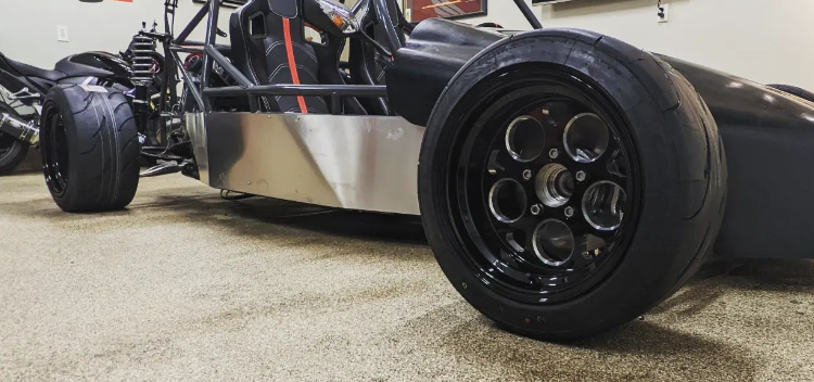

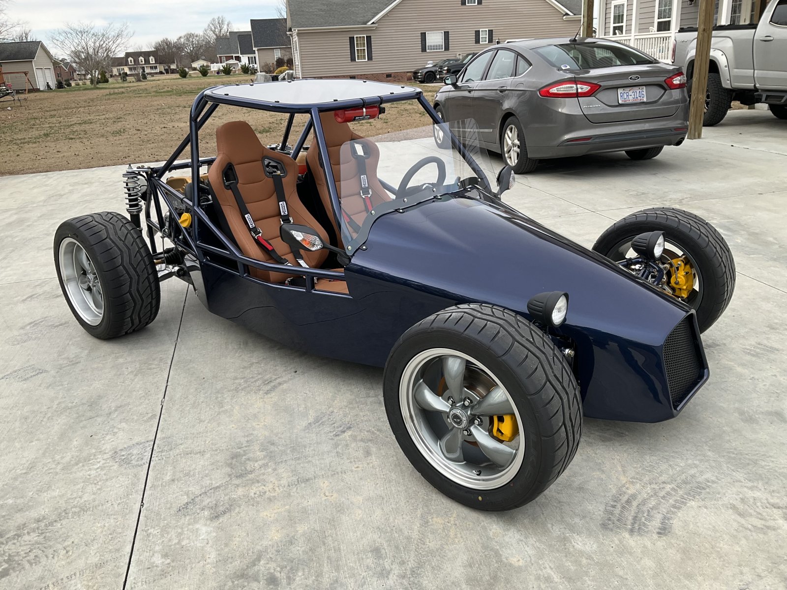

The last thing on the brain is, I REALLY like the look of a "fatter" tire (included picture below) but don't know how to verbalize that to someone who knows what I mean. I like the look where the tire is almost protruding the wheel a bit. Help would be greatly appreciated!

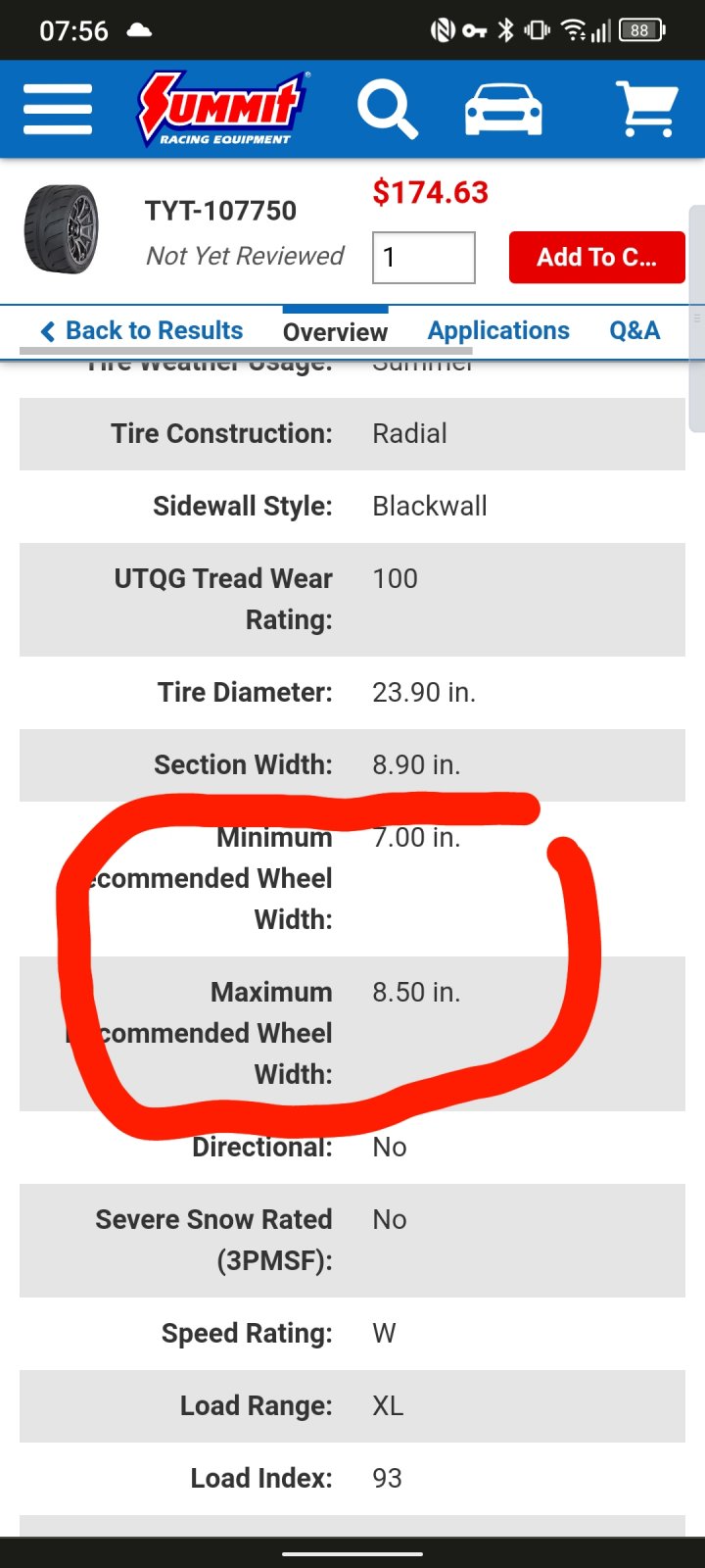

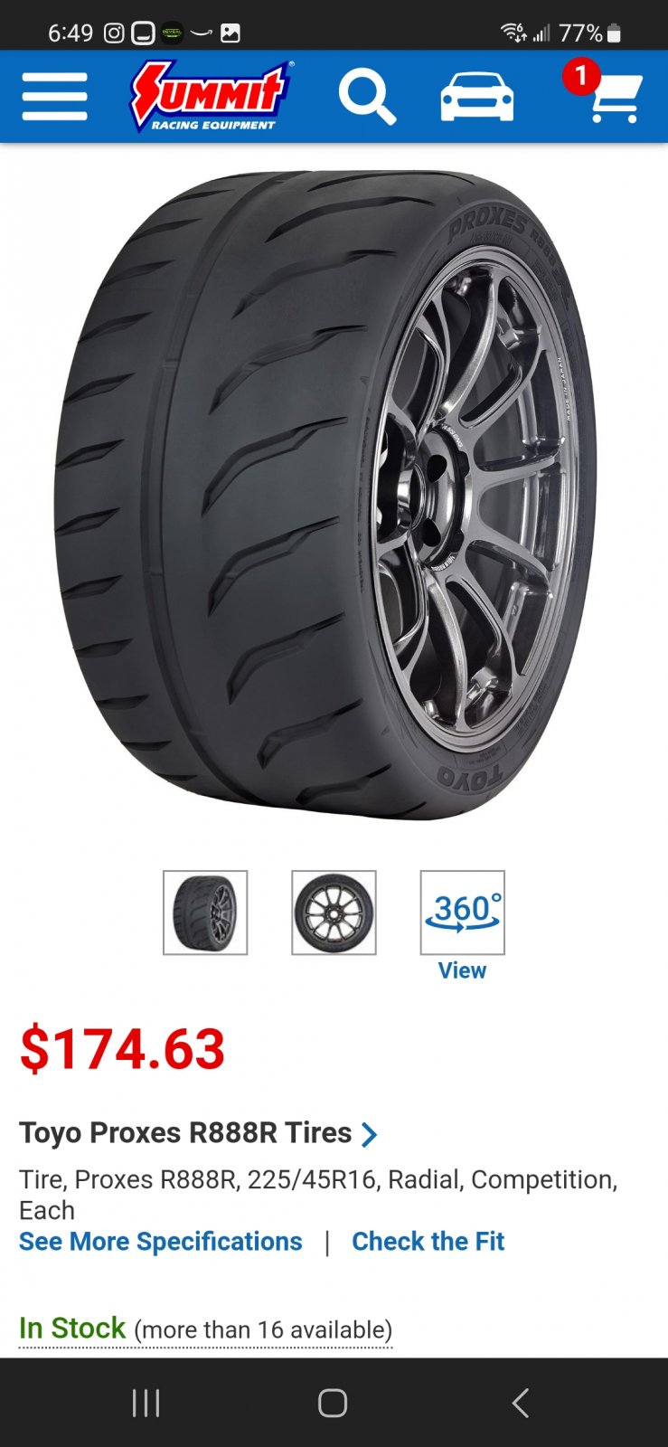

I found these, I just don't know if they will fit. Can someone let me know if these tires will fit that rim?

The wheels you picked out should work just fine. I think stock offset is 42mm, also on a 7.5" wide wheel, so that wheel would sit 2mm further outboard than a stock SS/TC wheel, and Goblins are made to generally fit Cobalt wheel sizes. If you go significantly higher in offset, it pulls the wheel inboard and you can end up contacting the wheel and control arm.
From that picture I'm not sure if by "fat tire" you're referring to bigger sidewalls or stretch or poke. The thick sidewall is a function of taller tires and smaller diameter wheels. Stretch would be a narrow tire for the wheel width, like a 205(mm) wide tire on an 8" wide wheel, and poke would be the opposite, like a 245(mm) wide tire on a 7" wide wheel.
From the attached screenshot, that tire should be fine on that wheel. At the narrower side of the window, it shouldn't have much if any sidewall stretch. Stock Cobalt tires are about 25" tall, so your speedometer will read about 4.4% faster without adjusting. You're also giving up some sidewall thickness (for looks) by not running a taller tire.

The wheels you picked out should work just fine. I think stock offset is 42mm, also on a 7.5" wide wheel, so that wheel would sit 2mm further outboard than a stock SS/TC wheel, and Goblins are made to generally fit Cobalt wheel sizes. If you go significantly lower in offset, it pulls the wheel inboard and you can end up contacting the wheel and control arm.
Perfect! Thank you very much for the response and the screenshot! That answered one of the big questions I had!

If I’m interpreting what you’re meaning by “fat”, then you’re asking for a tire that is wider than the wheel and makes the sidewall bulge some. If that is correct, the 225 you picked should give you some but wider would give more. For reference, I’m running a 245/45 17 on a 17x7.5 on the front.
Nice! That is such a clean look, with the wheels looking RIGHT for the car, plus great color!
