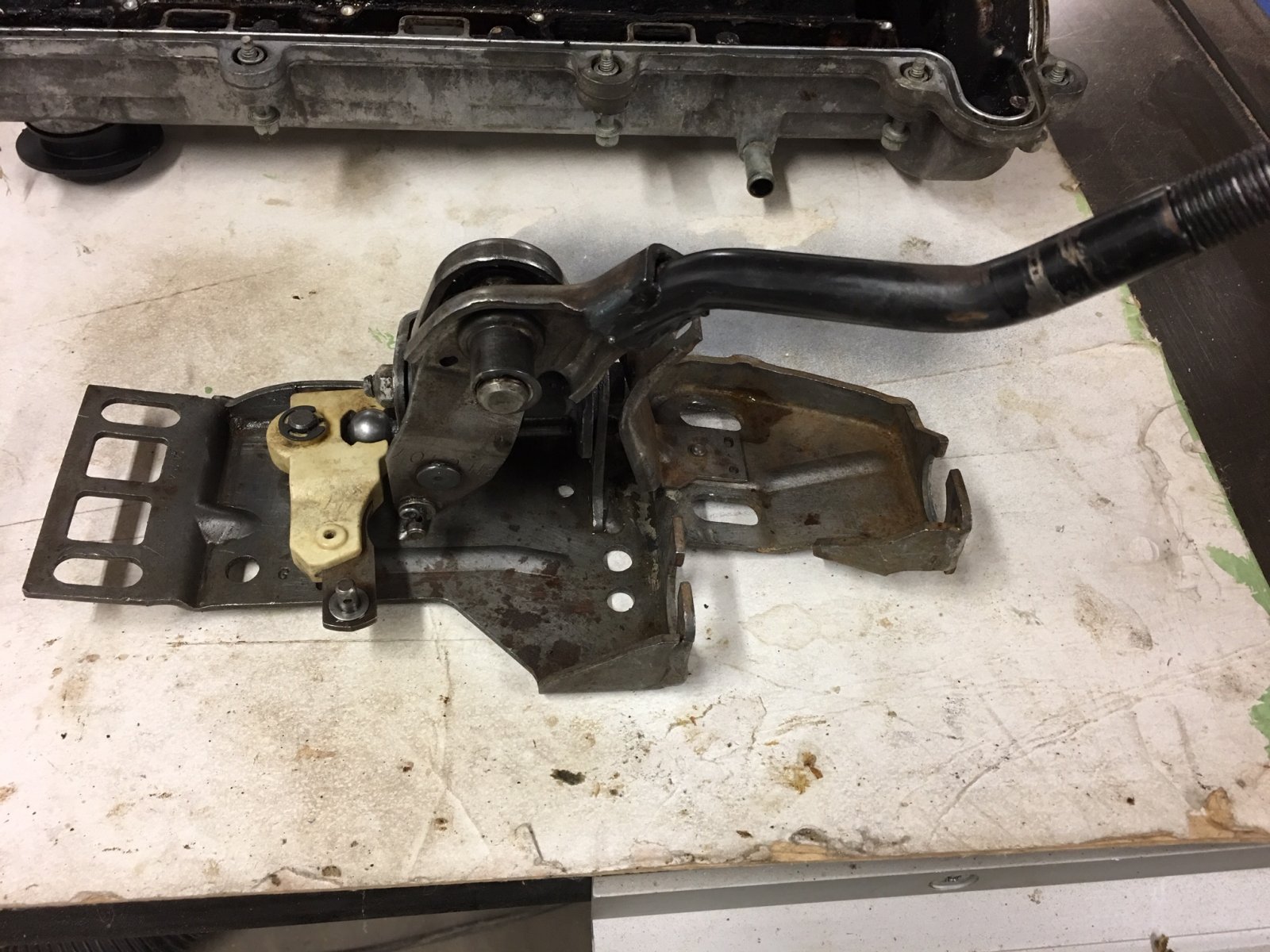

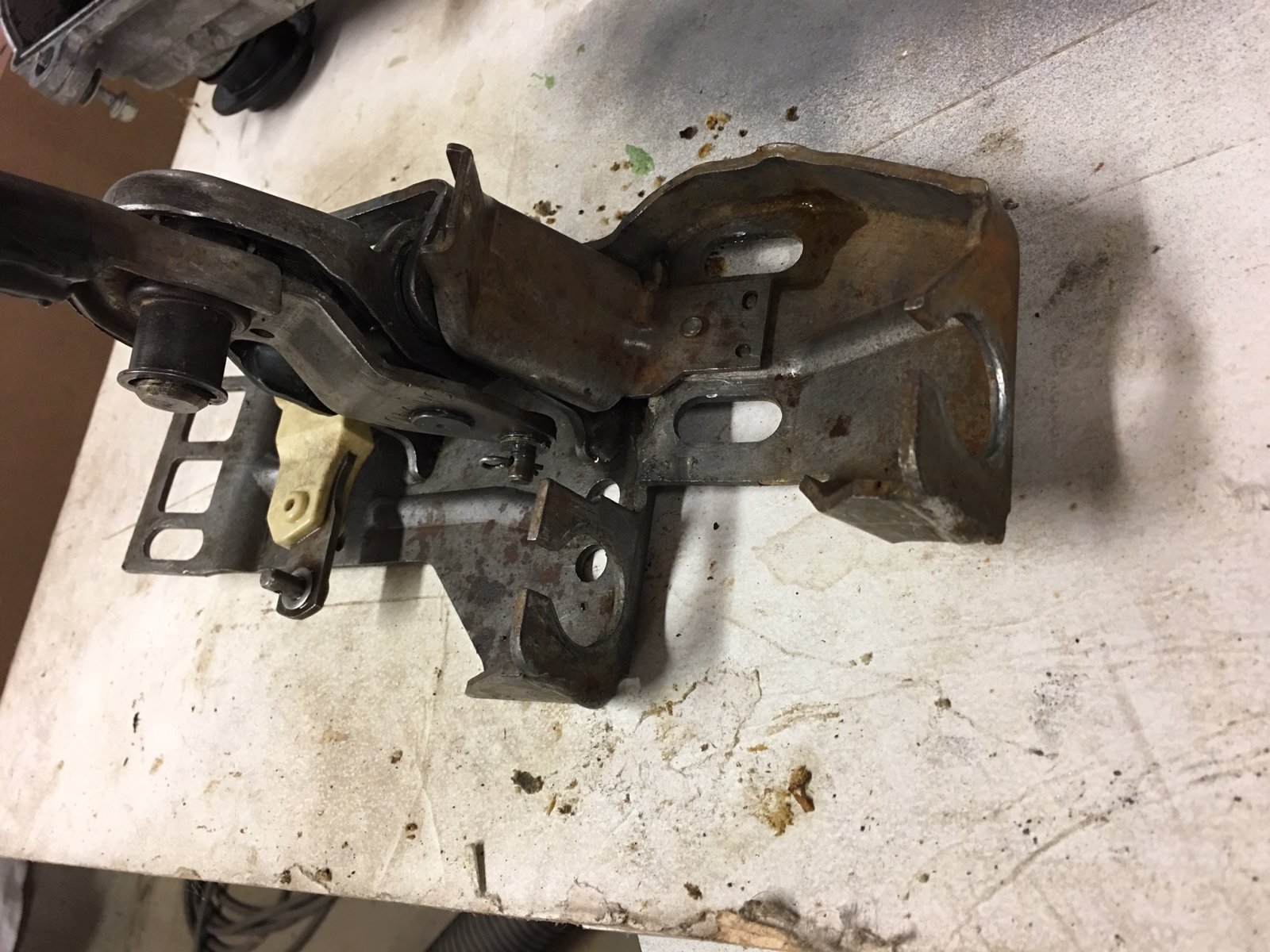

Has anyone looked at possibly using the stock Fiero Getrag shifter on the F23, F35 or F40 transmissions? FieroGuru has a kit that uses the stock 5 speed shifter as either a 5 or 6 speed with a reverse lock out. The nice part if it works, you would run the cables directly forward and into the back of the shifter. That would eliminate looping the cables around the back of the transmission to the DF supplied bell cranks in front of the stock Cobalt shifter. Seems like a really nice setup... (seeing that the Fiero’s shifter is setup for rear cables and connecting to a front wheel drive transmission mounted to the rear of the car).
I picked this one up just to play with....
THX,
Bruce
