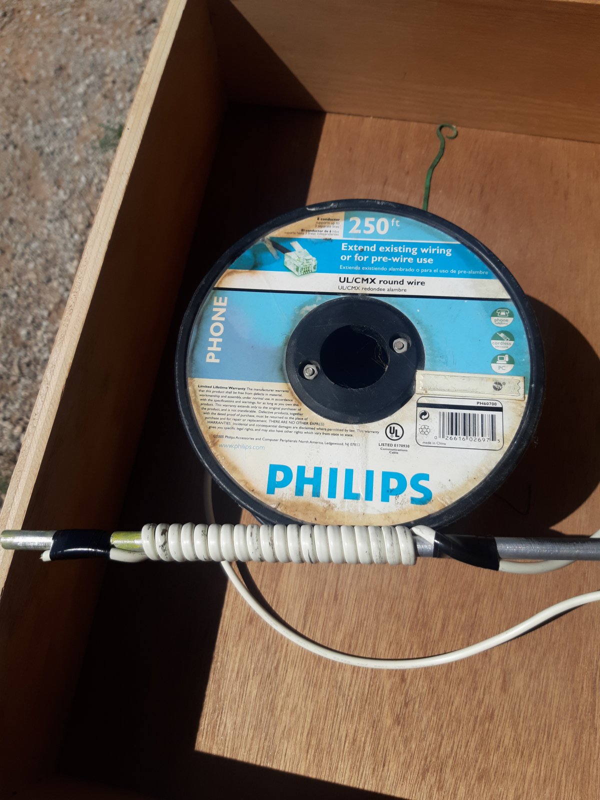

Started out using this old telephone wire as I had it laying around and I was delusional enough to think I may include the cruise switches in the steering wheel. I would recommend just a two wire thinner wire. I wrapped it around a bar and used a heat gun on it to get the insulation to take as much of a set as possible.

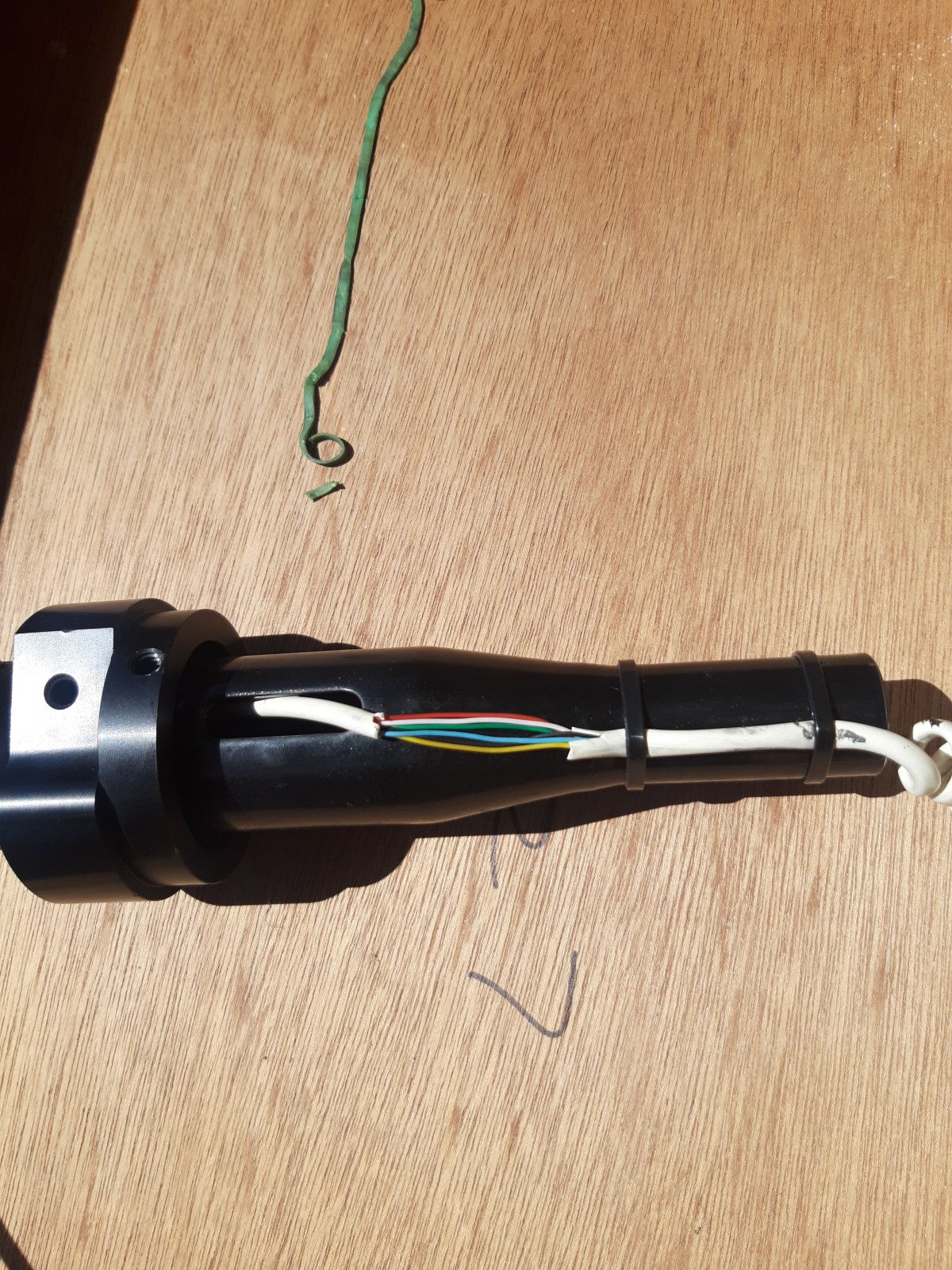

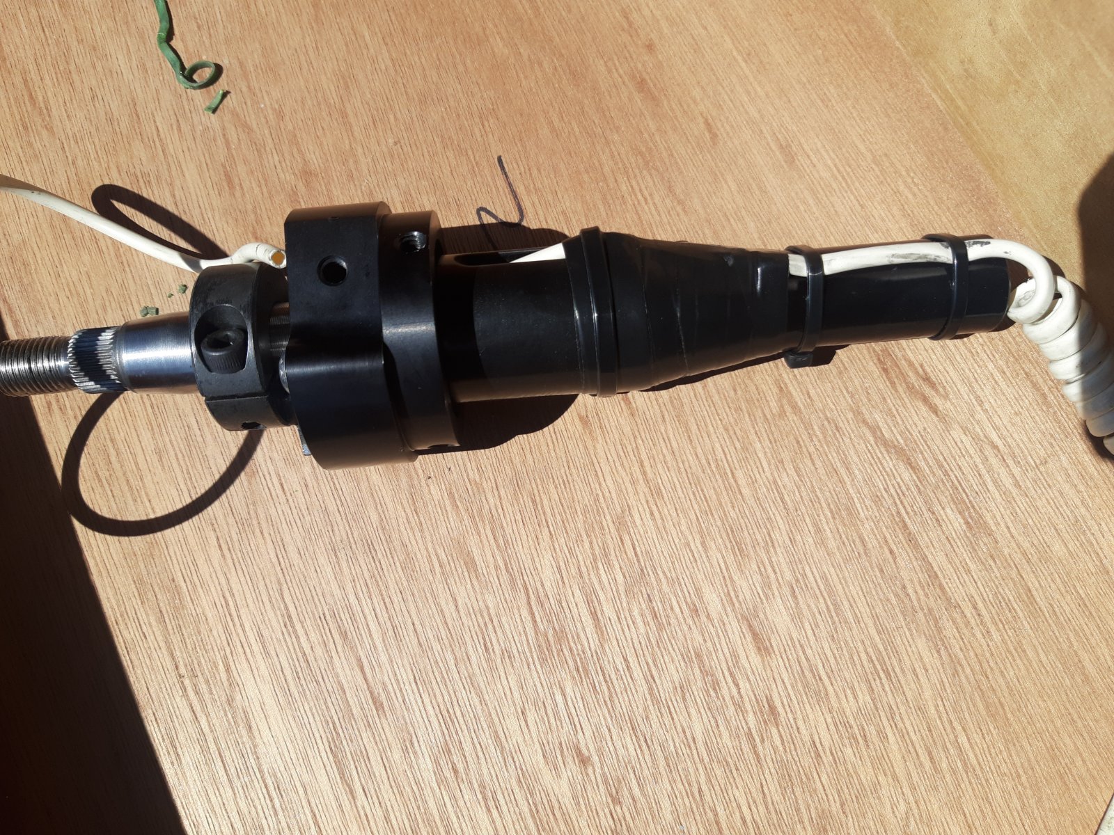

I did run a drill bit down the center of the origional steering shaft to clean up the hole from any burs that might cut the wire and had to remove the exterior insulation as pictured to avoid it catching on rotation. wiring secured with electrical tape and zip ties to the steering shaft. This gets you to a position where you have a wire through the rotating steering shaft with the coiled end at the bottom.

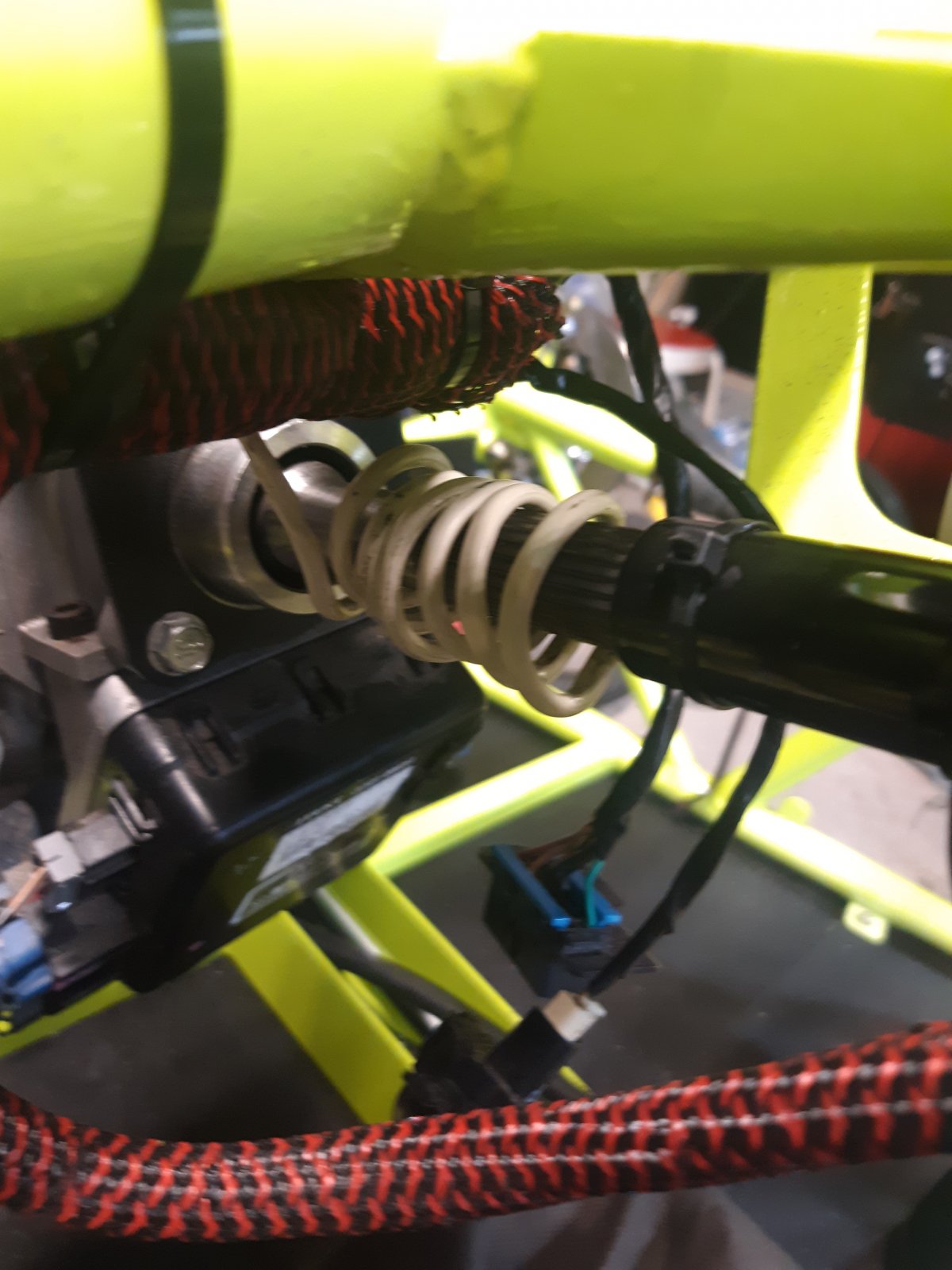

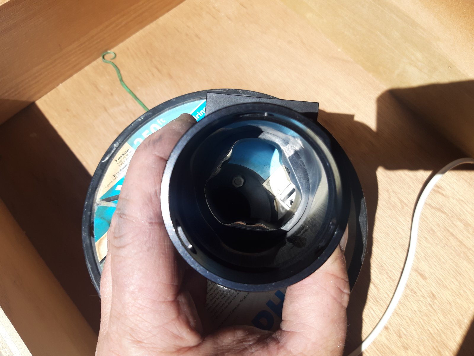

I did clearance the DF supplied column as shown to provide additional relief for the wires strapped to the exterior of the steering shaft as it is very close tolerance in this area. When installing column the power steering unit shaft inserts through the coiled wire as shown. make sure to verify wheel can turn steering stop to steering stop without this coil binding or unwinding to far to provide future problems. Wire and secure lower wiring to corn wire and ground and attach securely to maintain coil shape around lower steering shaft.
