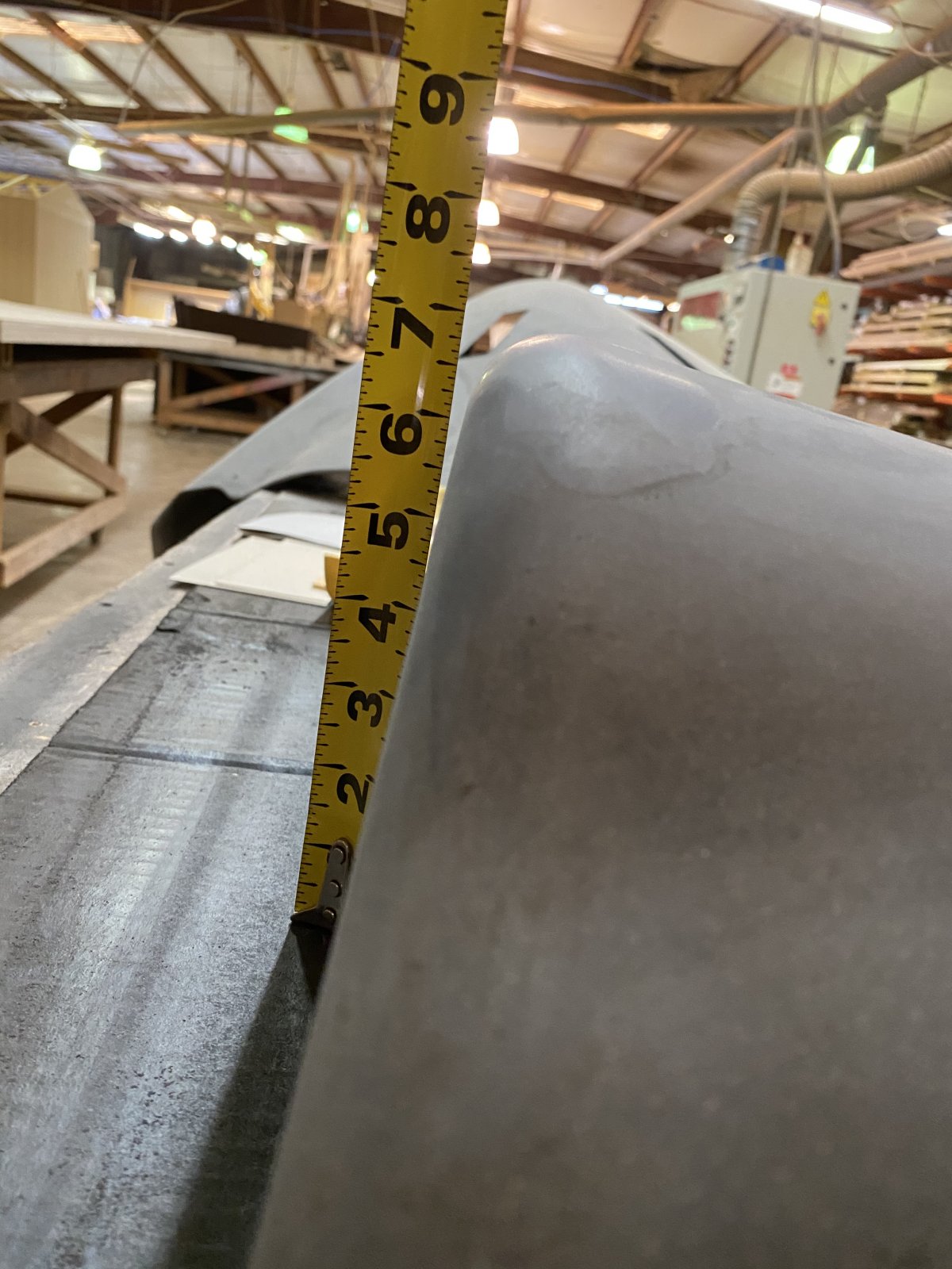

Can anyone tell me how tall the engine cover is from the bottom to the top of one of the humps?
I have a wild idea and need to know if I should have Adam throw one on my pallet or make my own.
Goblin Graber
It's about 7" tall with a little round over at the top edge.
Thanks. It’s going to be really close. I want to fill in the bottom and put one of these kicker subs in each hump. Looks like I’ll have to go to my local Kicker dealer and measure one.
SACTX
The total is about 7 inches. It has a three-quarter radius on it.

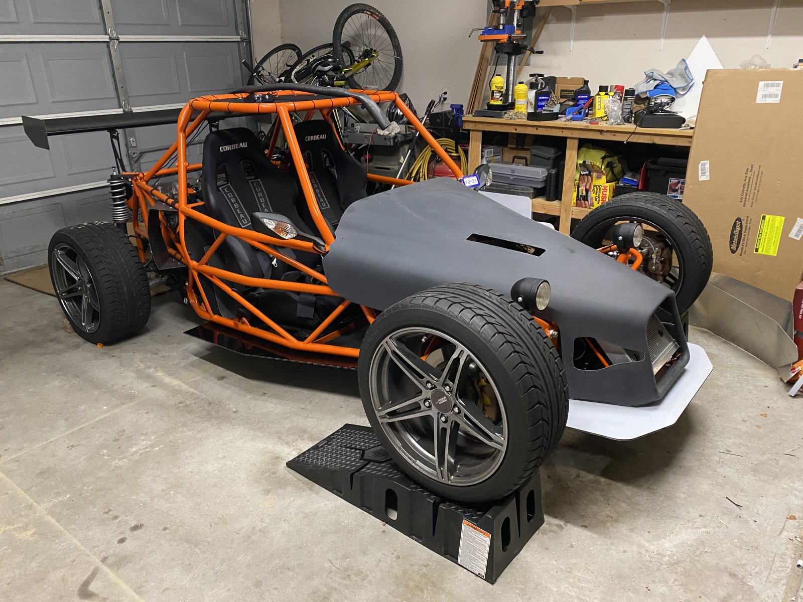

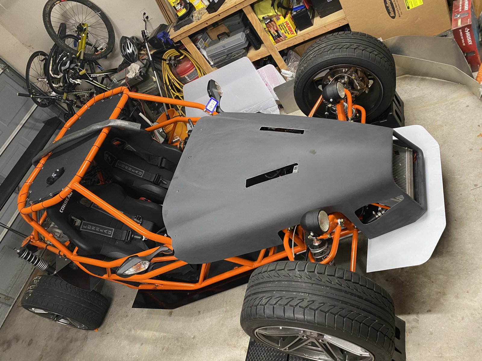

I have some vents from Runcool (http://hoodlouvers.com/product-category/side-louvers/) that I'm putting in there. Expensive but the perfect size and very well made. They'll be installed to face backwards

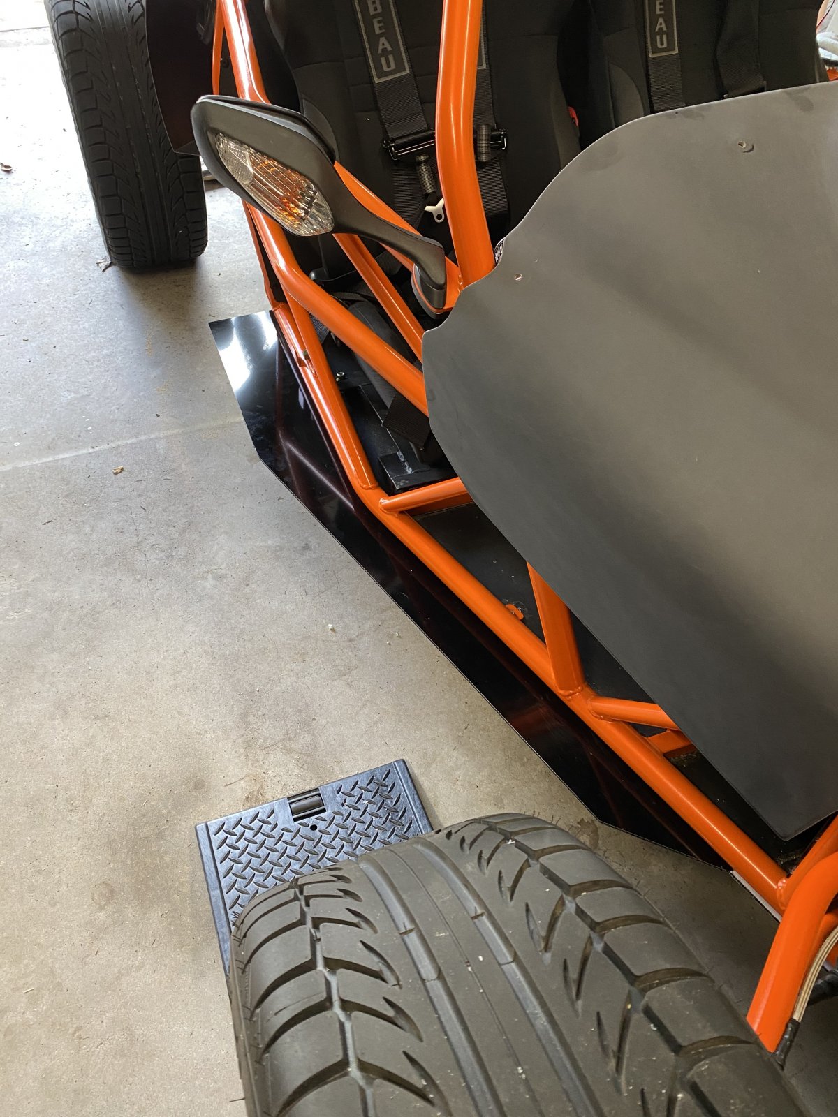

I fabricated a splitter/front floor to seal off the floor area in the front and installed a hood scoop backwards to funnel the intercooler air back. It's 6mm alumalite. The footwell cover is installed and sealed at the front and I have a section of insulation between the hood and the footwell behind these vents. The air entering the radiator will exit the wheel wells or be pushed out of these vents (they're facing backwards) and over my full windshield. I also included floor extensions to help separate the messed up air coming out of the wheel wells from the air under the car and I'll have my sides sitting on the floor extensions.
I don't have any pictures with the vents installed but I've put them on to confirm fitment.
The white is peelcoating.
I'll be updating my buildlog with more details when the body is painted and installed.
