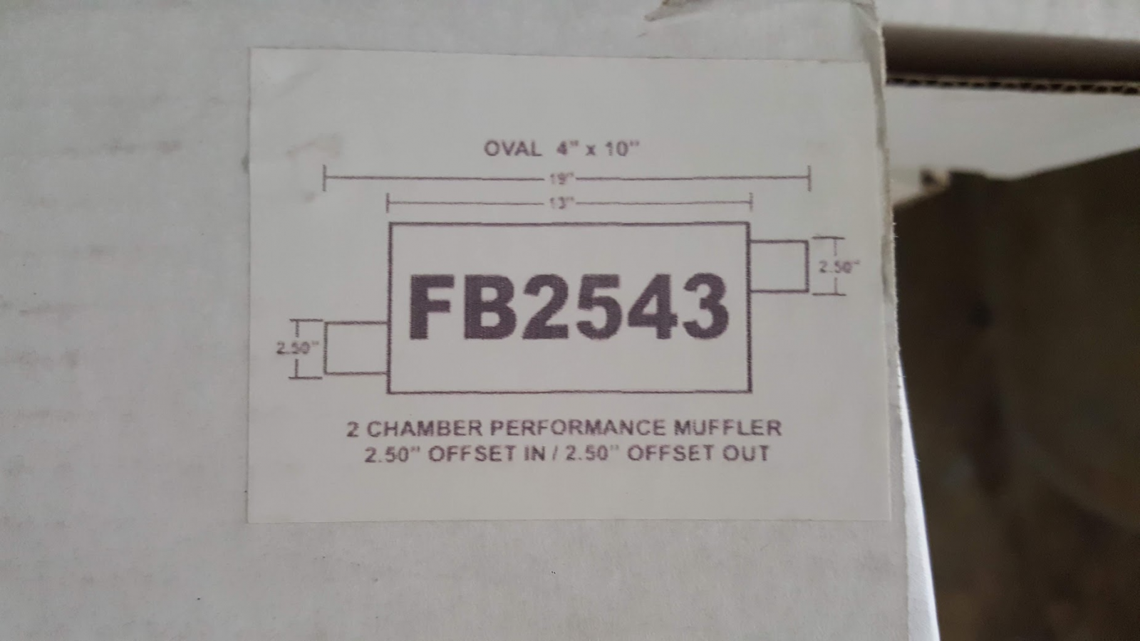

I'm never on the forum!
But if I were, this would be an image of the end of one of our muffler boxes that I would post.
Adam says we buy our mufflers from Jones Exhaust.
12887
If you want, I can get Adam to contact Jones Exhaust to see how they handle situations like this.

I would really appreciate it if he did contact them, I've only got 750 miles on the car so far. Looking at their warranty looks like 1 year from the date of sale so were past that.
No big deal though. Thanks for the part number!
