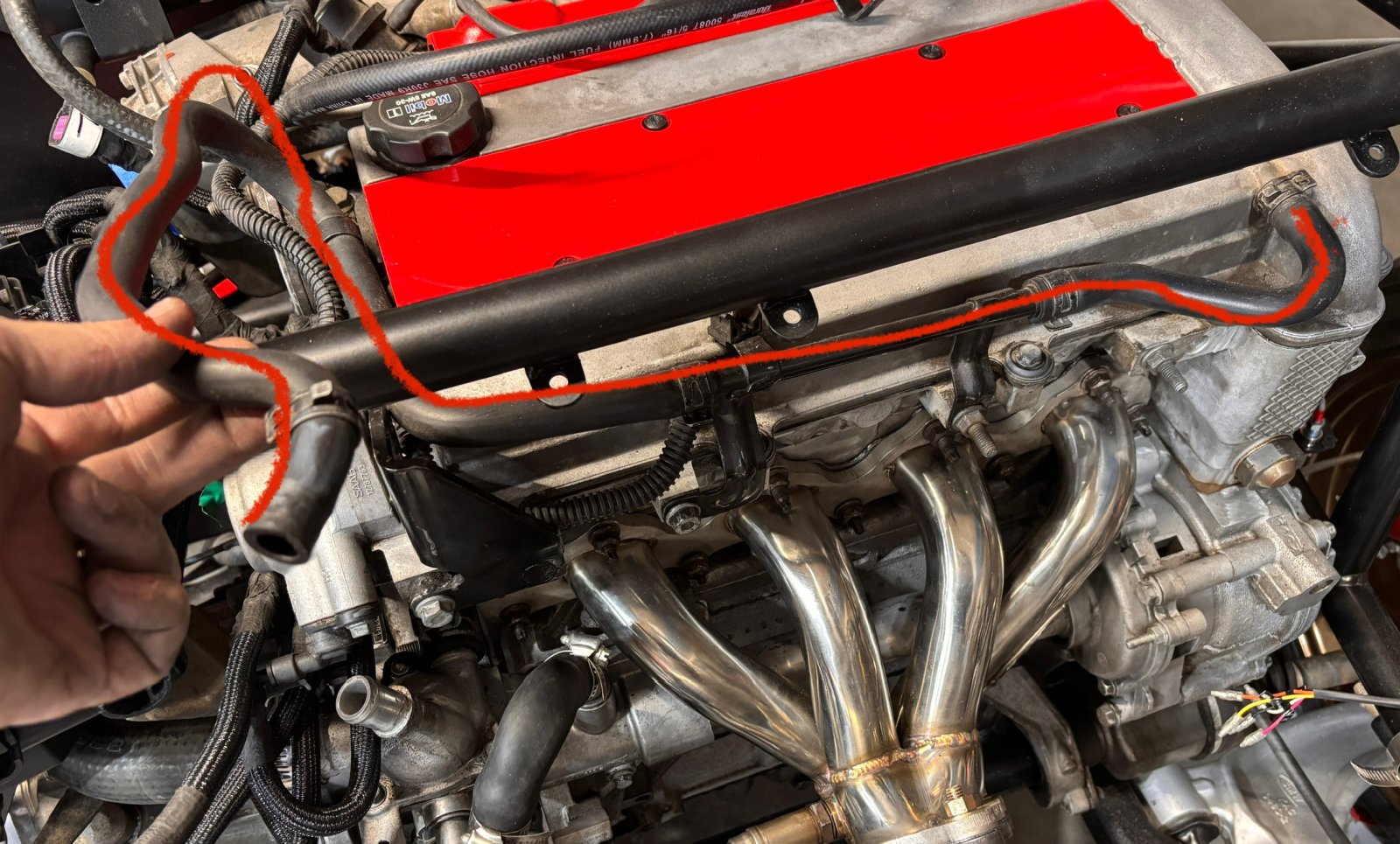

Item 1:
Where does this hose go that runs along the back of the head?

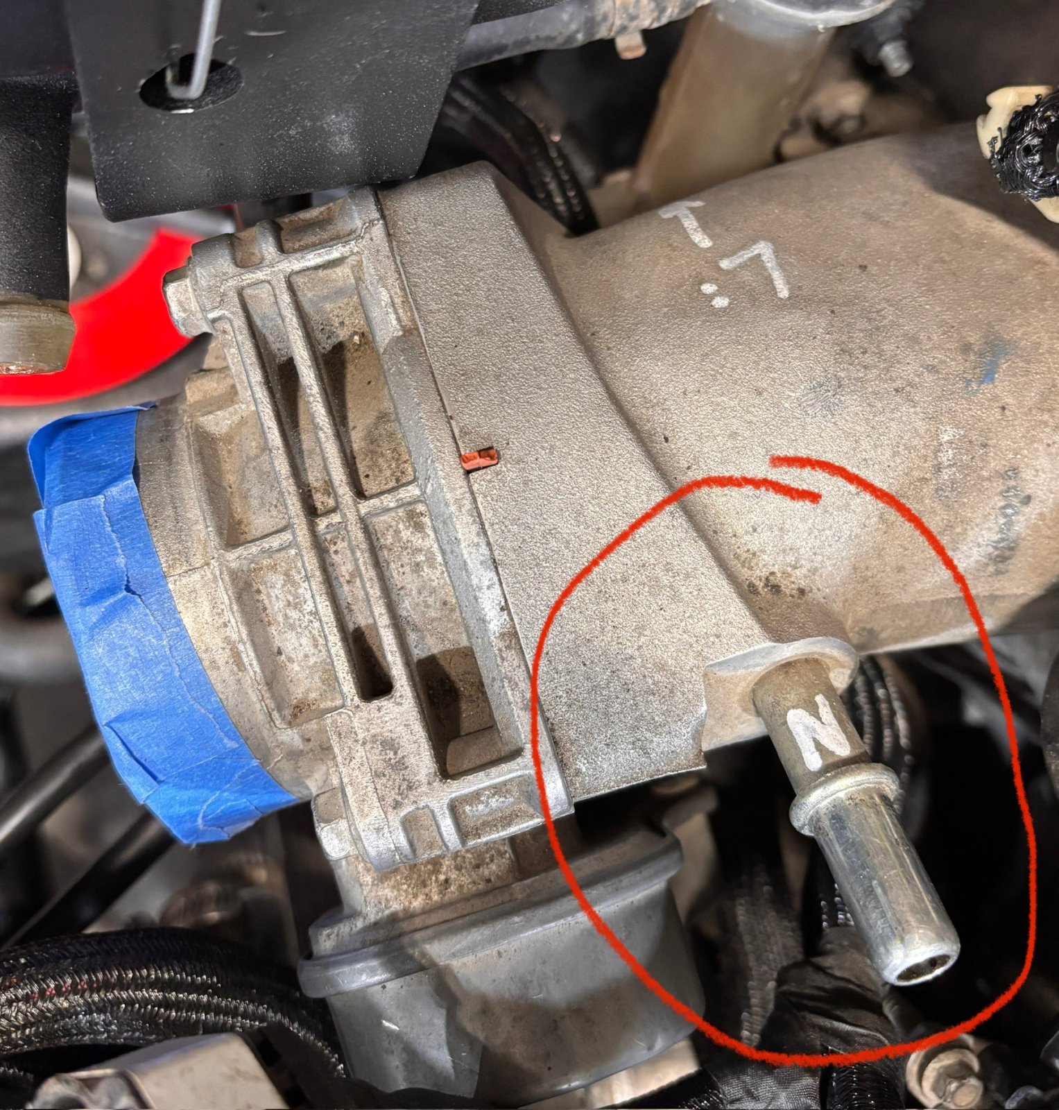

item 2:
What connects to this nipple on the intake of the SC?

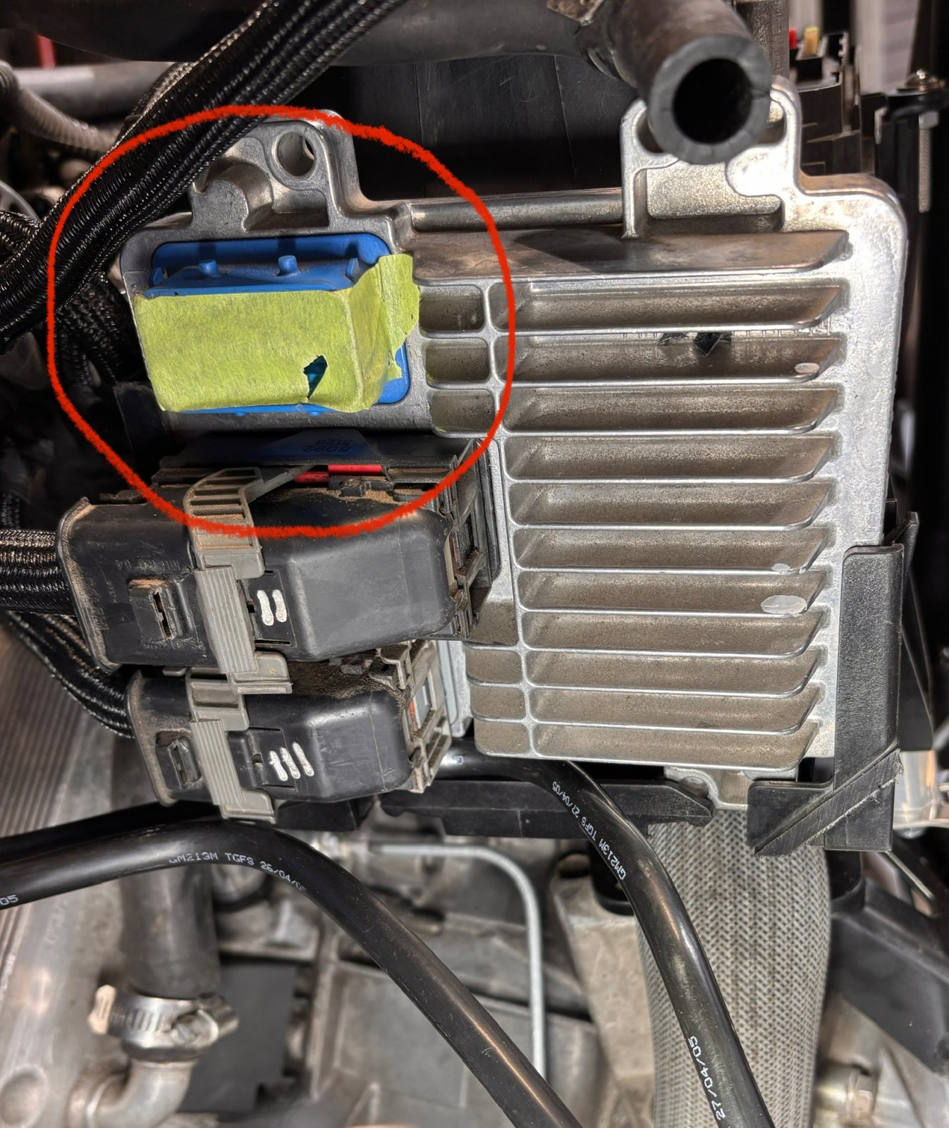

What plugs into the top plug of the computer?

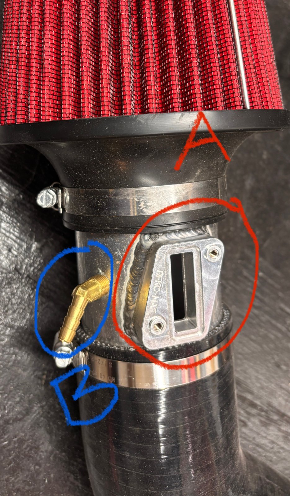

item 4:
Is there supposed to be a sensor that goes into “A”? And what connects to nipple “B”?

1: runs to brass barb on intake. You need to reduce it and finish the tubing.
2: runs through the tunnel and hooks to brake booster.
3: there is another plug for this, I can not remember where it comes from at the moment and am away from my car. I won’t be home for a week, if no one can help in that time I will look next Saturday.
4: “A” is for the Mass Airflow Sensor. “B” is the barb the hose from #1 connects to.
