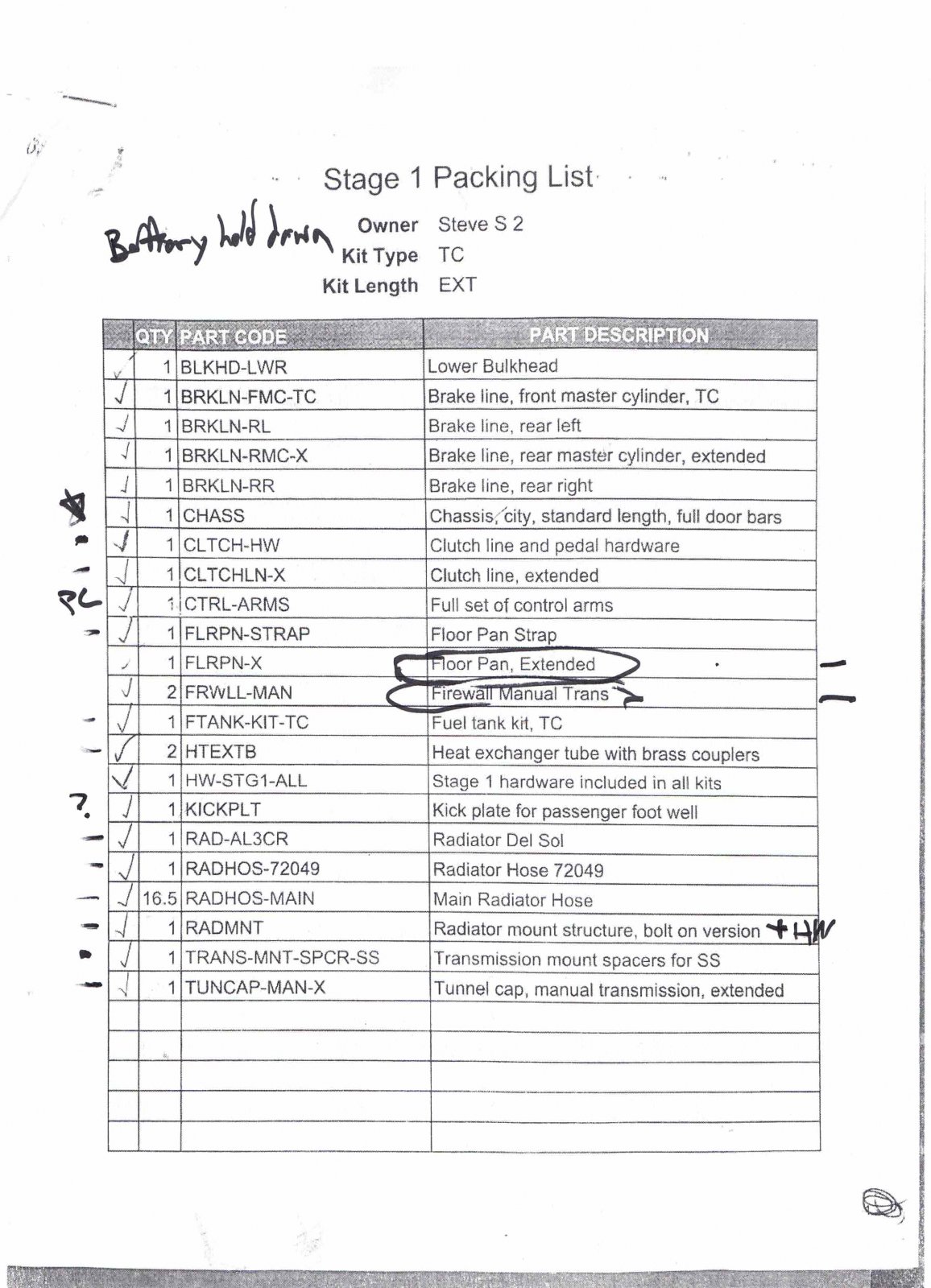

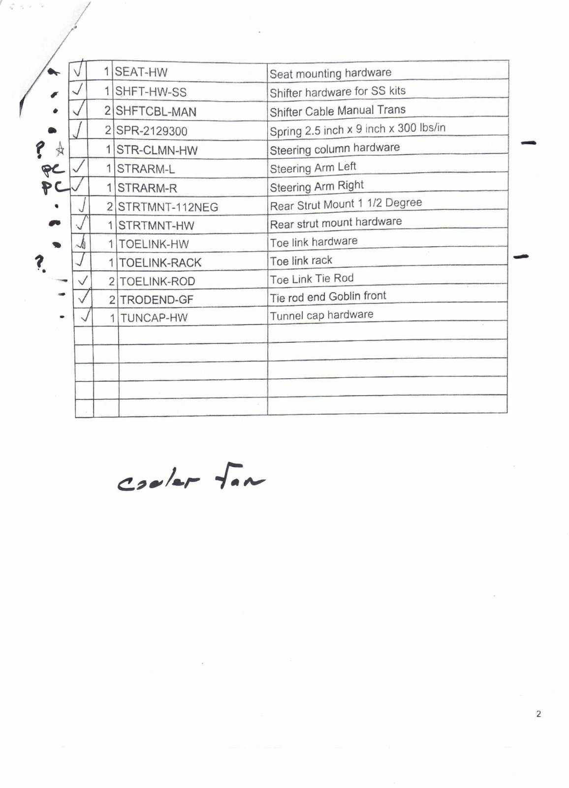

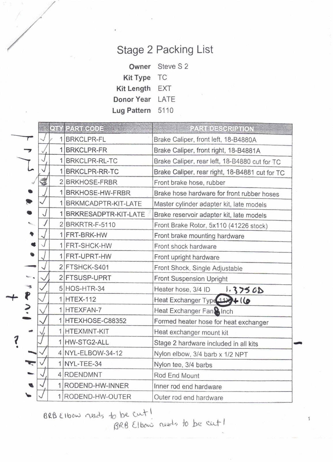

As to packing of the components. Yes, most everything was in 1 of 4 heavy boxes. Yes, MOST things had stickers and could be identified as per a packing list I received from DF (attached). (PC annotation means already at powder coater and STARS mean very different than description). The 4th box had baggies UN-Labeled and nothing was identified as "HW-STG1-ALL or HW-STG2-ALL" everything else has been accounted for even if there were differences in the descriptions.
I am trying to identify what SHOULD make up the list of items for "HW-STG1-ALL or HW-STG2-ALL" because I live 45 miles from the nearest town and the back and forth getting ones and twos of things in the middle of assembly will be dreadfully painful. I did that on the last project which you can check out here (it was just finished with paint last week- more pics to follow): launch_pad_mcduck2003 | Flickr or here: Launch Pad Engineering - YouTube
