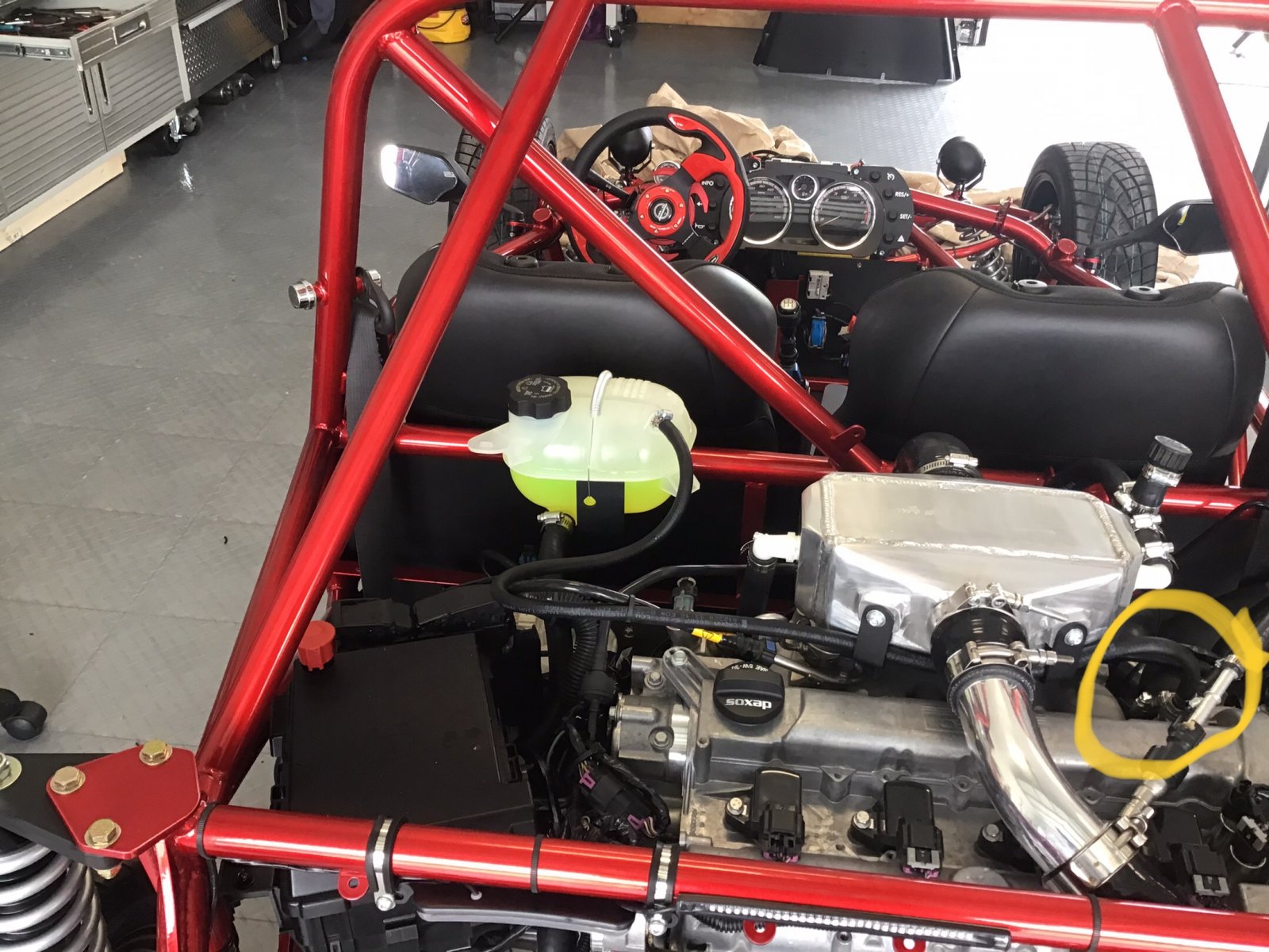

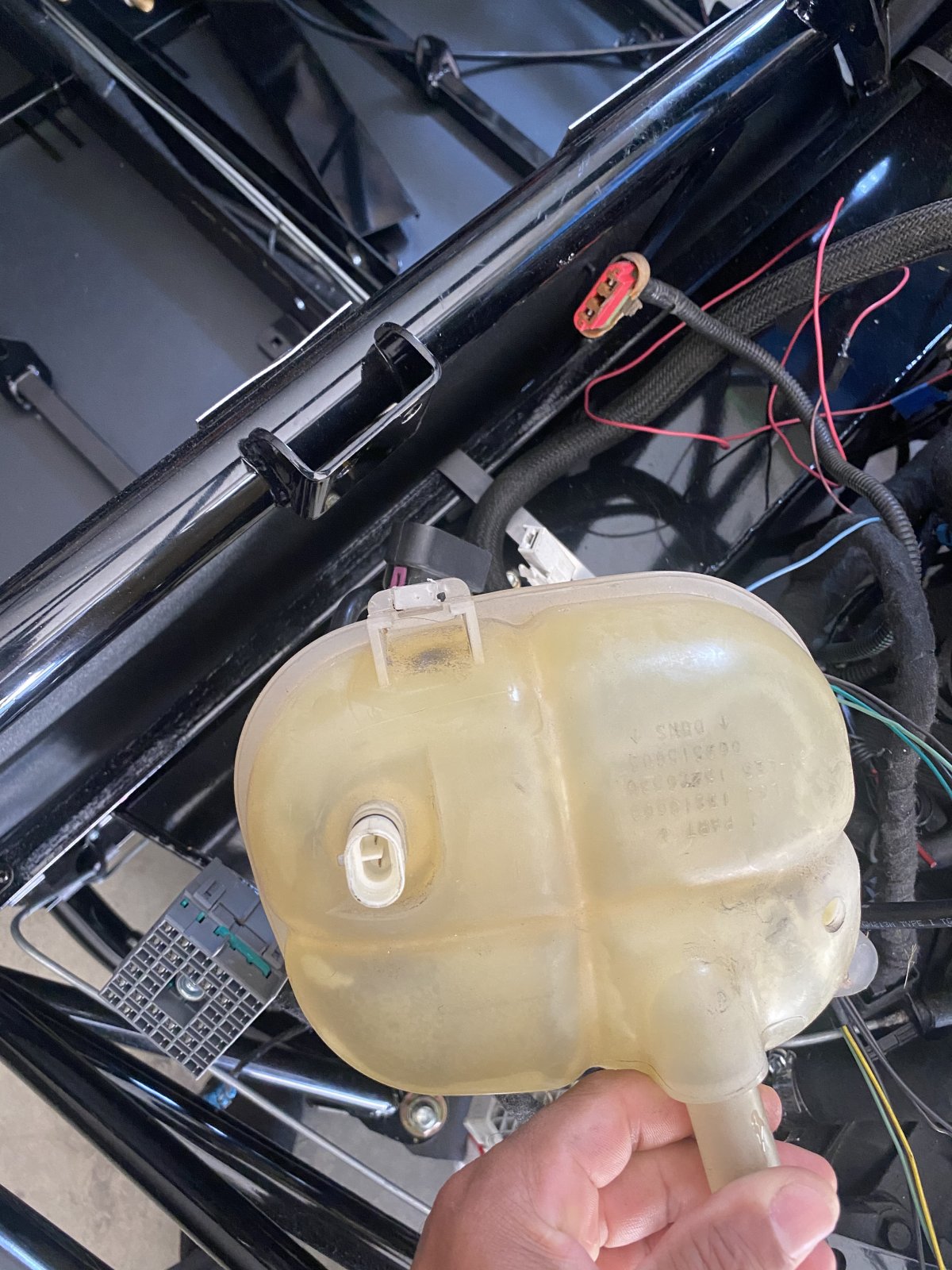

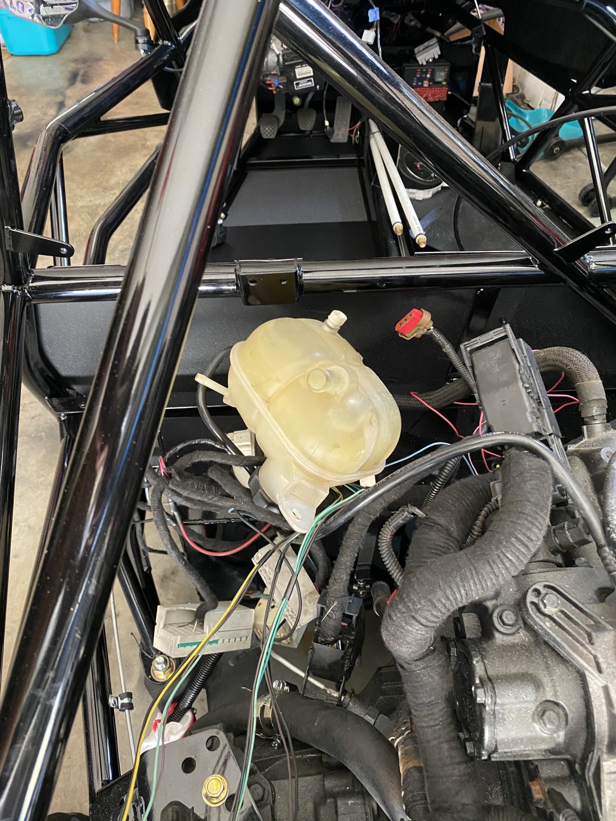

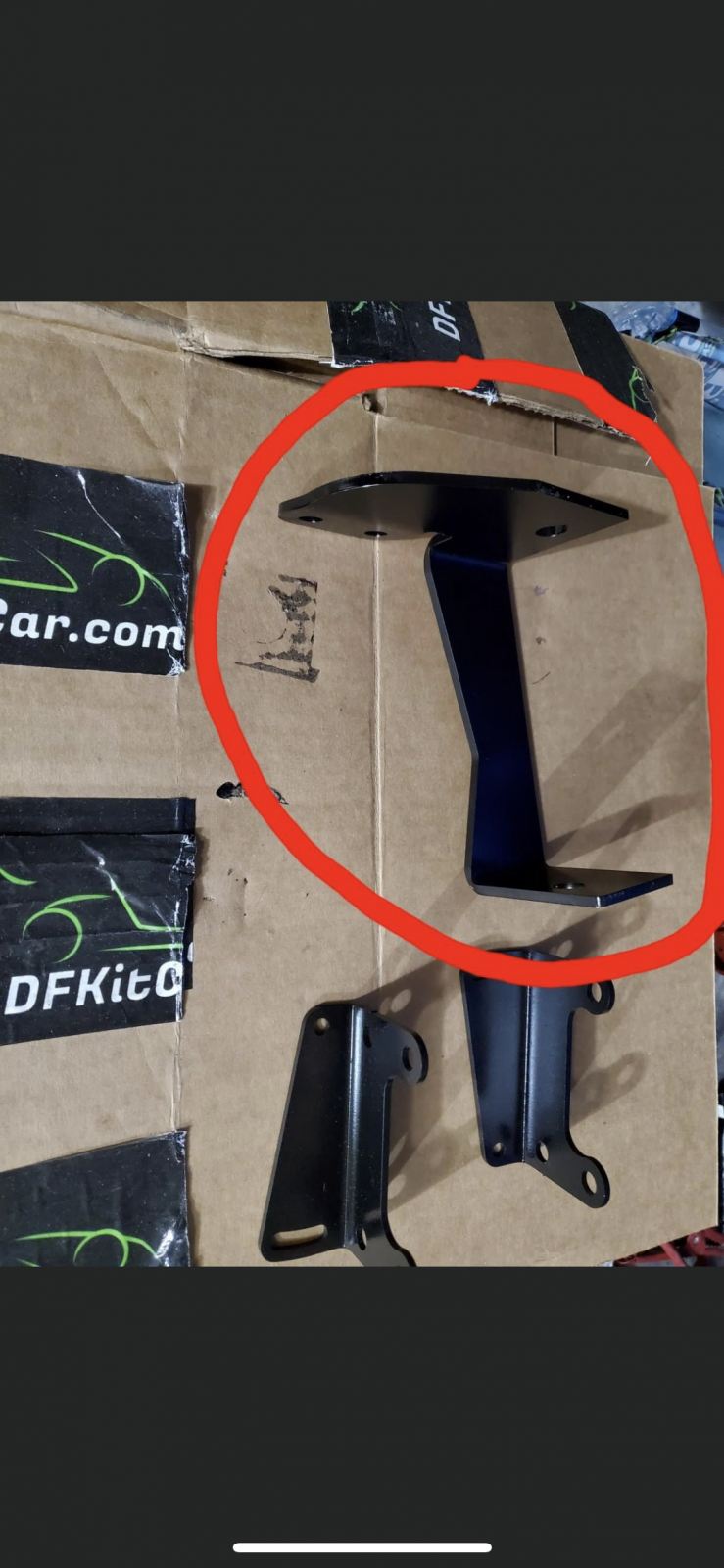

How do I mount the coolant tank and fuse box on a ss tc model. I got the bolt kit but got no idea how it bolts on to the tank and frame

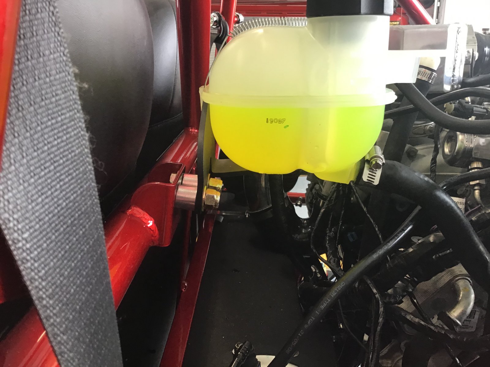

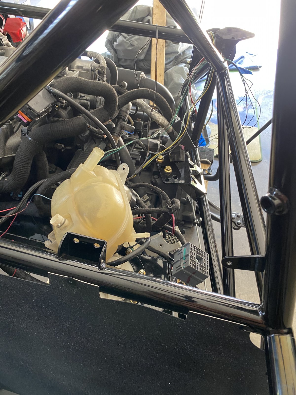

The fuse box instructions in video 20 still works. The coolant tank has different bracket that bolts on in the location as shown in video 20 and then the spring stretches over the top of the tank.

found the issue from looking on the fb group. I don’t have this bracket

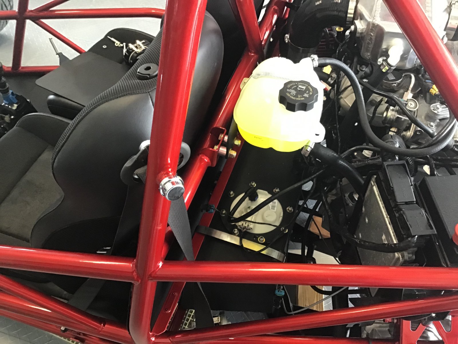

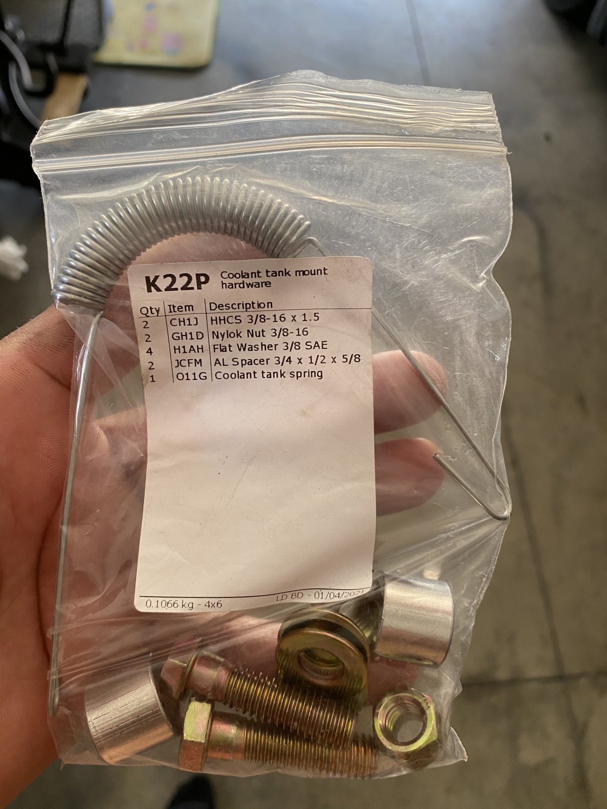

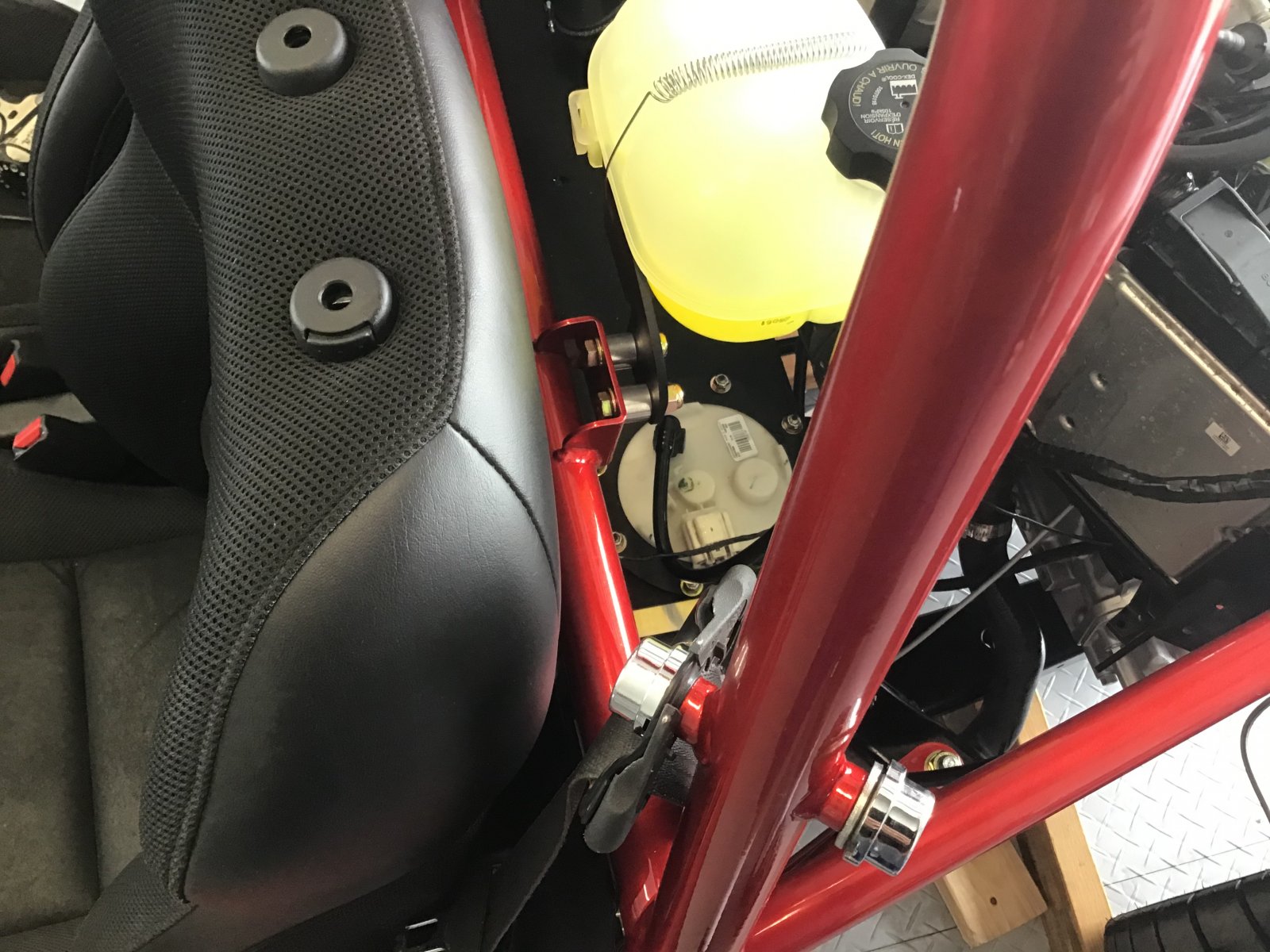

Here you go
