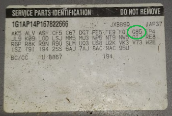

Regarding the final drive, you’d want to check the codes in the trunk, usually left side on the bottom. G85 is the code for the limited slip diff on the SS models. Not all came with them. Another thing to check is the plate on top of the transmission. Should tell you the final drive ratio of the transmission.
Not all SS Cobalts have the limited slip... but a Quaife LSD can be installed afterwards for ~$1600 ish.

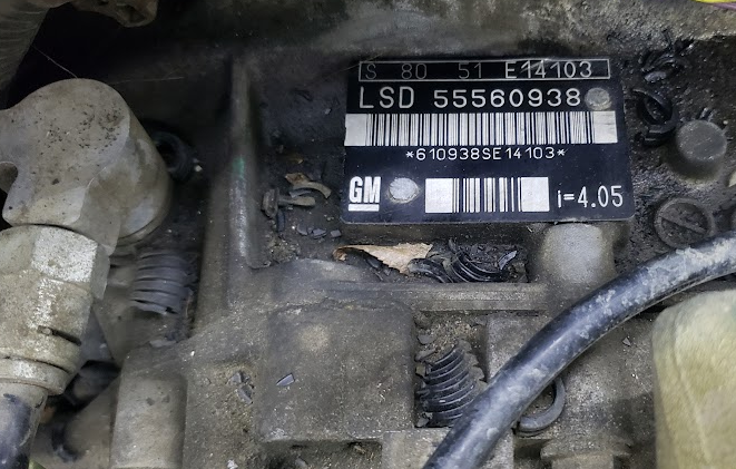

This tag should be under the carpet in the trunk of the Cobalt. G85 package will have the SS Recaro seats, and the transmission tag on the top of the transmission will say LSD on it.

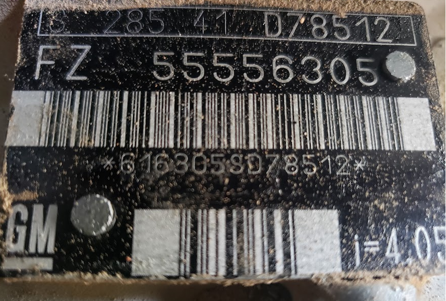

The regular transmission has a FZ tag

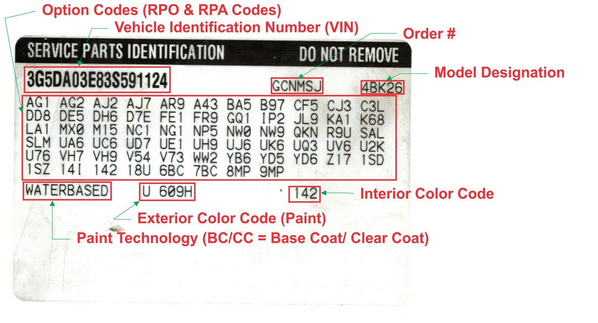

The sticker in the trunk r3drckt refers to looks like this... It shows (in code) every option that your car came with... the LSD transmission is notated by "G85". Google "GM RPM Codes" and you can find out what all of them mean.

2007 Cobalt SS supercharged- to be picked up next week. Do all supercharged Cobalts have lowered final gears and limited slip? all SS/SC come with the 4.05 gear
If not how do I tell what’s in the gear train? as mentioned previously, if the trunk tag says G85, it should have an LSD, but looking at the tag on the trans is the best indicator of what's inside as far as gearing and diff without actually opening it up
