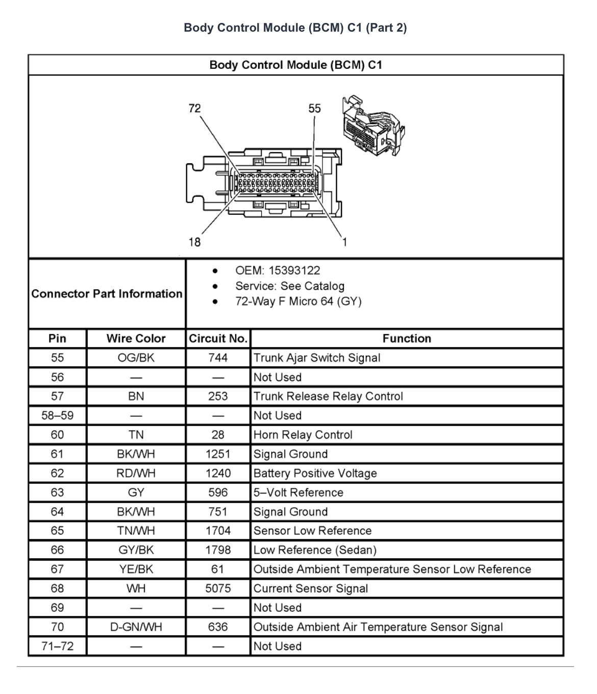

I do not have a ground wire coming out of the BCM connector in wiring video 10. Is this right?
This is hopefully my last wiring question!
I can’t find one from the BCM connector. I’ve cut the zip-ties and opened the connector and still cannot find a black wire.

BCM C1 connector has 2 grounds for the 06 SS/SC at position 61 and 64
R
I believe the connector will be labeled at the 4 corners with the pin numbers, like the picture is showing, to help you orientate your plug and locate those pin positions.
R3drocket, Thanks for the diagrams. I'll check that connector tonight when I get home. I've looked around on All Data (thanks Ross) but was having a bit of trouble finding this info.
