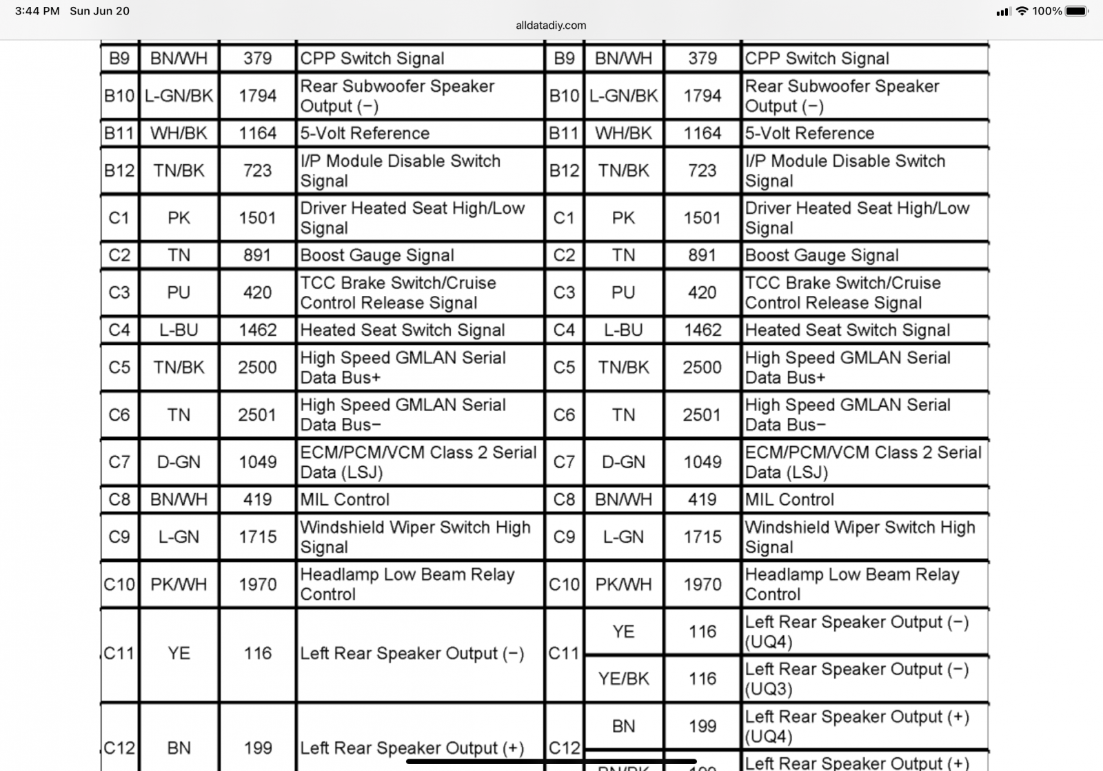

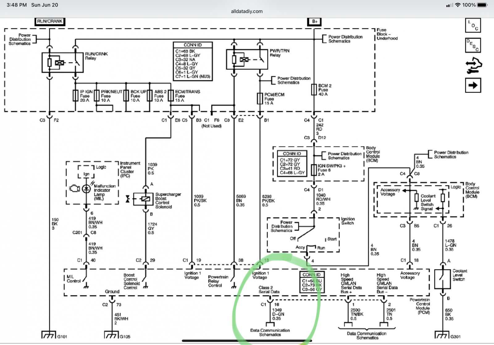

Ok, so it looks like on the body to dash harness. C7 is ECM/PCM/VCM Class 2 Serial Data (LSJ) and goes to the PCM C1 pin 16. I have a feeling this is important.

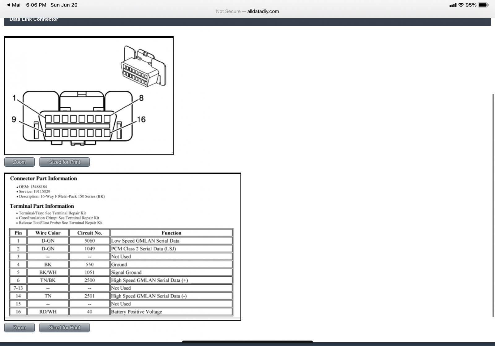

The dark green wires (Class 2 serial data) is the GM Low speed LAN wires. It is one wire communication, so they all (PCM, BCM, instrument panel) get soldered together.
The Brown/BrownWhite wire pair are part of the GM High speed LAN. This is two wire communication, and bounce thru each computer (PCM, BCM, Power Steering). The Tan/TanWhite pair are also part of the high speed LAN.
