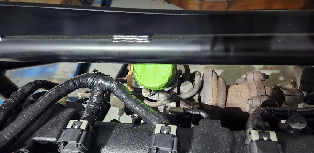

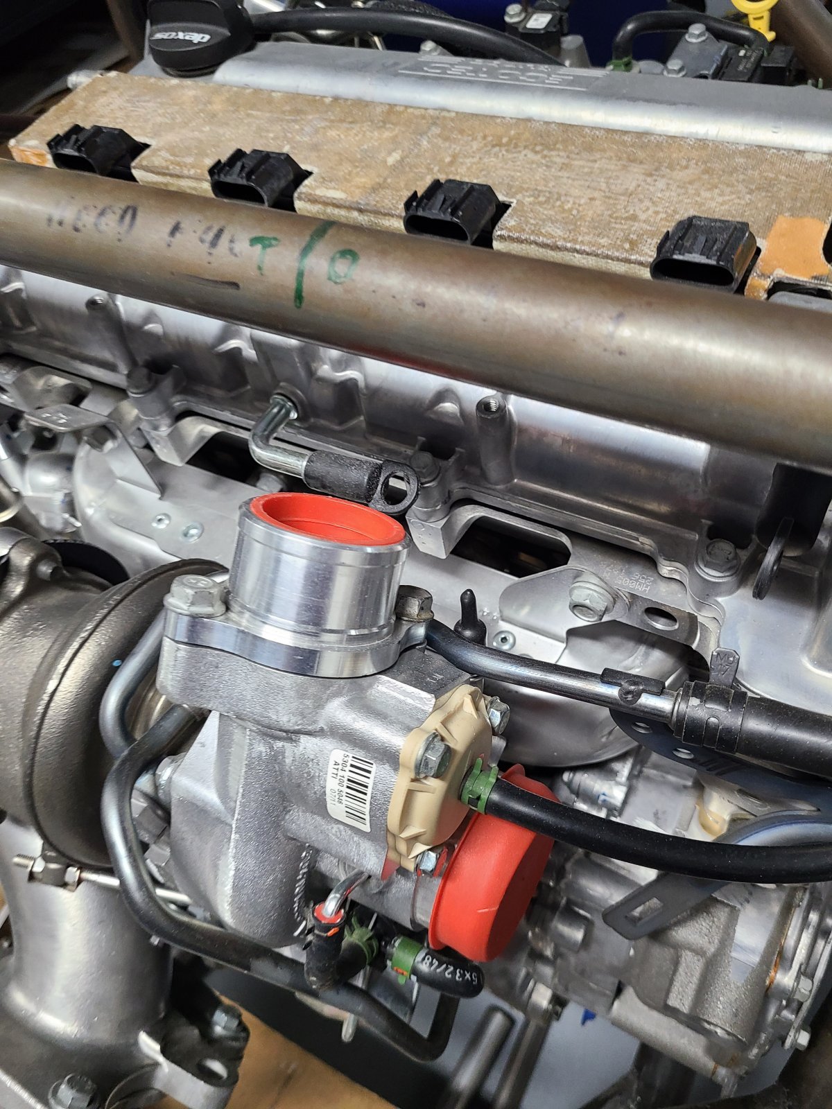

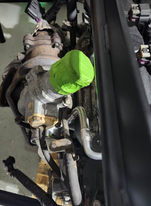

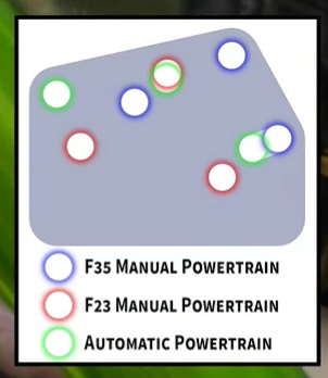

I am trying to move forward with my build but have come across an issue (i believe an issue). When working on trying to install the fuse box, I noticed that the turbo "blow off" (insert shrug) seems to directly line up with the support bar that goes over the engine. I went and rewatched the videos on the engine install to ensure I used the correct mounting holes and it seems correct. I was wondering, has anyone come across this issue? or found a remedy to mitigate this being an issue in the future? I am trying to avoid having to remove a bunch of work later on down the line. Any help would be greatly appreciated.
Also. I confirmed with Adam a few months ago that I did have the F35 transmission.

There is a 45 then a straight tube then a 45 into the intercooler. You have to cut down the 45's to clear everything. It won't look like it will work but it does.
OptimizePrime
Confirmed, there is a shorter snout in the TC kit you'll have to use with a K04. It's still a tight fit.
Other turbos, like the zfr's, you can clock the compressor housing.
