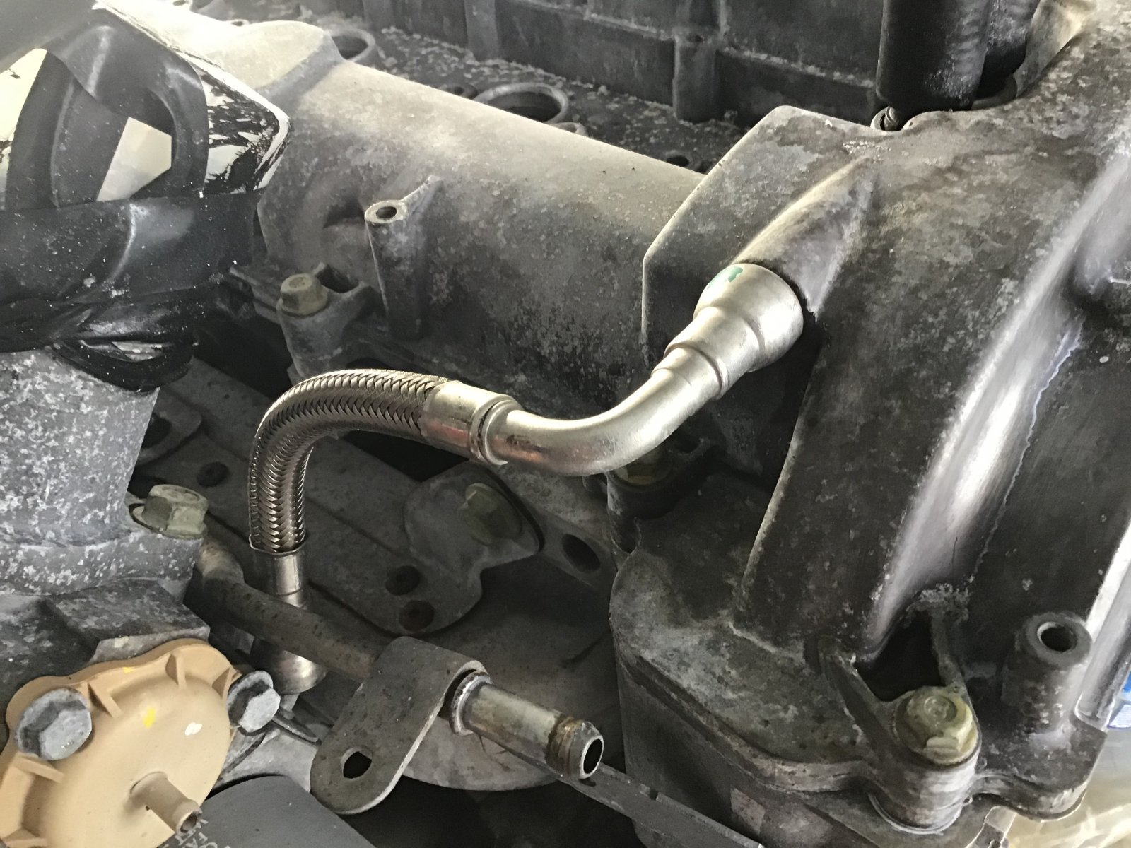

How do I disconnect this tube so I can get my turbo off to clean engine.

One person was successful, that I know of, disconnecting it with careful zip-tie placement. A few other people destroyed it and replaced it through Amazon. I just disconnected the other end from the turbo instead; it's pretty tough to get back on that way.
If you force it off of the nipple, you will bend the four small tangs in side (that the proper fuel disconnect tool normally disengages to remove it). Those little tang retainers are replaceable.
