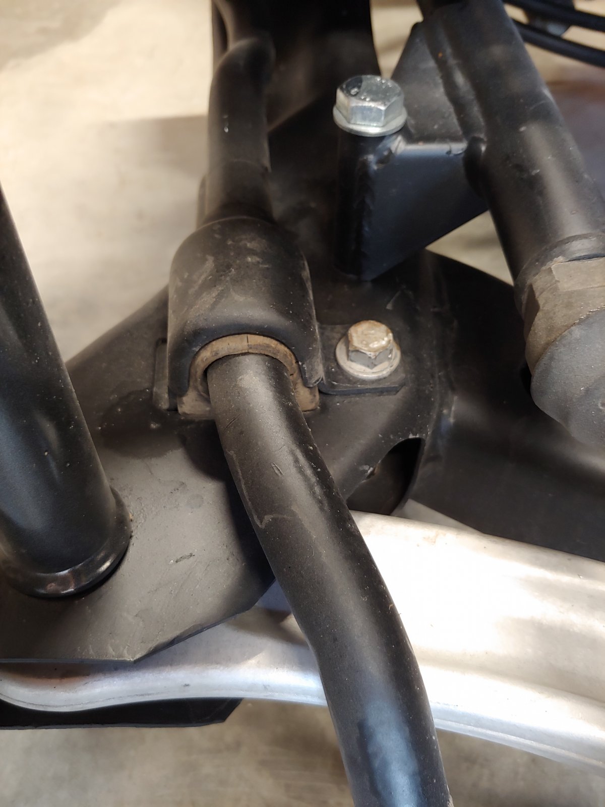

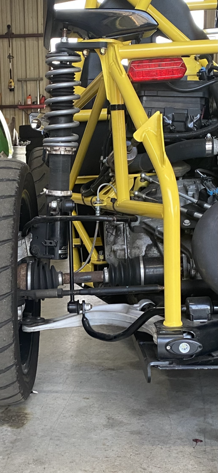

One of the things I've considered changing about my build is the sway bar. I currently have the 06 SS SC 24mm sway bar. I'm under the impression that if I want to change to the 18mm FE1 style then I'll need to get the sway bar, the end links, and the bushings but the bushing brackets are reused.

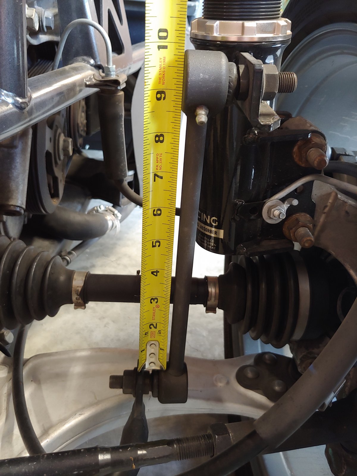

Currently I have the end links that are just under 10" long. Bushings are still stock and are held in place by 1 bolt on each bracket, see images, they tab into the sub frame. I think I've read about some cobalt versions using 2 bolt style brackets instead of 1 bolt.
If I go the junk yard route for parts, is there a year range I should limit my search?

You can source the entire assembly from Rockauto for less than $100. My Cobalt came with aftermarket sway bar that are even larger so I've been looking at options.

I used a 2007 SS/SC as my donor, but got a super clean subframe from a non-SS car. It came with the smaller 18mm sway bar and all of the hardware. I am planning on using this in my build, but here's my dilemma... My donor SS/SC car had the FE5 suspension, and the subframe and sway bar that I will be using are for an FE1/FE3 suspension. I don't know which sway bar links I will need - the Moog K750012 @ 9.86", or the Moog K80252 @ 11.8". Where is the length variance in the FE5, as opposed to the FE1/FE3? Is it different in the sway bar dimensions, or at the strut mount side?
The longer links are specified for the NA 18mm bar and the shorter links are the larger SS bars 21mm and 24mm. The sway bar end on the SS bar is longer than the NA bar - the bent part the arm. The longer link is meant to keep the sway bar horizontal when mounted.
