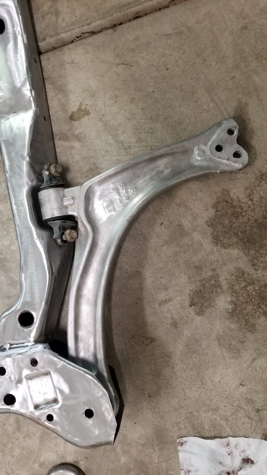

I know the control arms are a topic that has been beat to death, but it's usually with respect to the lower bushing. I'm in the process of swapping out the control arm bushings / ball joint on my FE5 alloy control arm and going through the typical pains of grinding off the rivet & drilling new holes for the ball joint and burning out and removing the outer ring for the lower CAB, I'm now on to the leading control arm. Given this has been a bit of a nightmare already, I'm trying to mitigate me installing the wrong part.

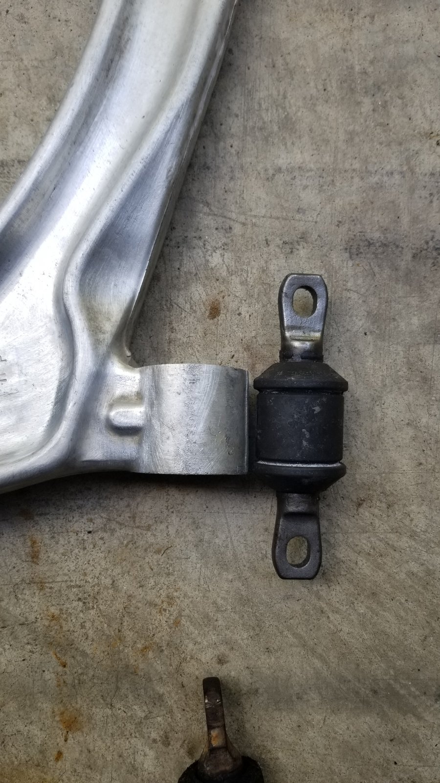

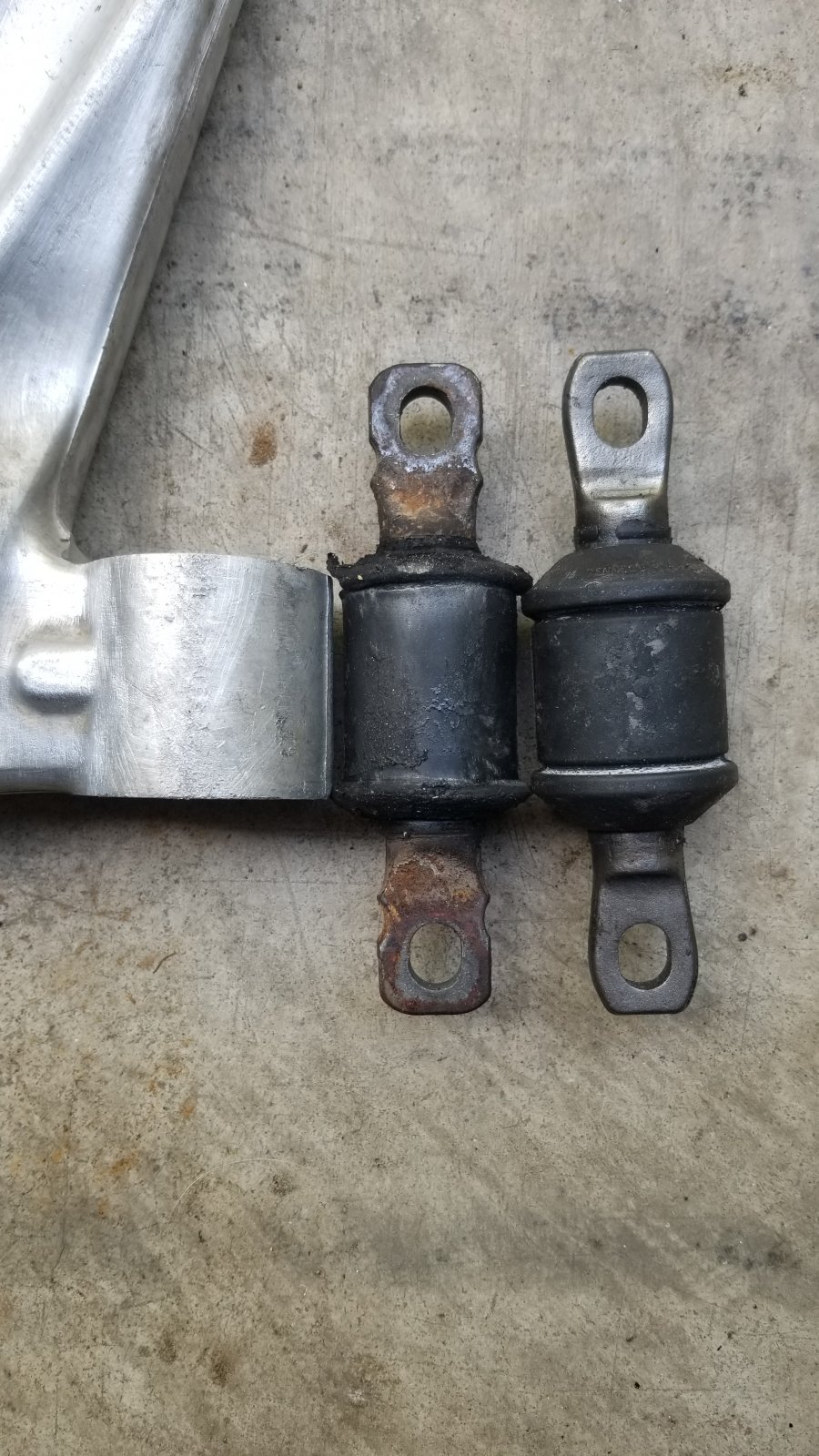

I ordered K200361 which is listed as an exact match and researched if these were different depending on the year model and it doesn't appear that's the case. However, when I put these up against what I'm about to press them into, things are not looking good when it comes to the rubber size (....that's what she said). The metal rod itself is great. Does the rubber stretch? Did I order the wrong part? Is there a special way to press these in?

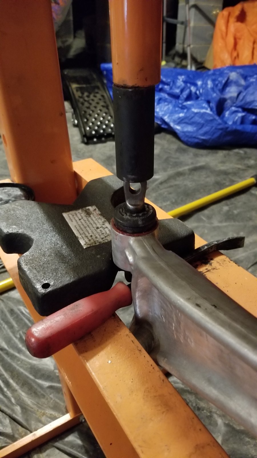

To close the loop, these bushings do go in butter smooth. Steps below for those in the same spot
1. I put them in the freezer overnight
2. Draw a white line on the control arm and the bushing so when mounting they would line up perfectly

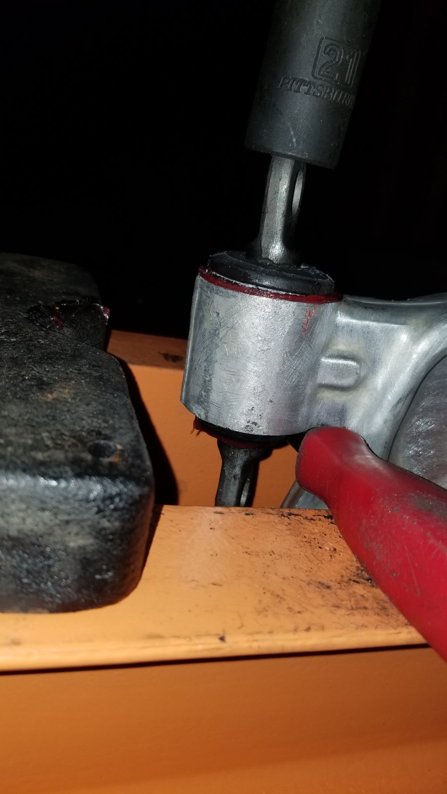

3. Used a 21mm and 24mm deep sockets that I picked up from Harbor Freight. The 21mm is just wide enough to get around the metal and press on the rubber and short enough that the top of the socket pushes down on the metal as it's getting pressed. The 24mm gets used when the rubber itself could use some massaging, it's rather wide so it provides good coverage.
4. I put assembly lube on the inner part of the control arm as well as all around the bushing

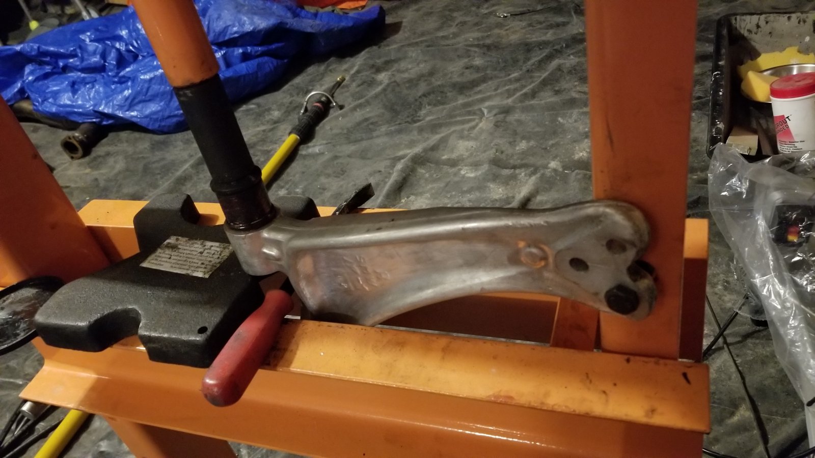

5. Used the bolt from the ball joint part to attach the control arm to the press, and put a pry bar under the control arm perch.
6. Take your time and press the bushing in. I swapped sockets and pressed the rubber and metal as required.
7. The lip of the bushing will press through the bottom side - clean up and check it out for fitment on the subframe.
I got the 20ton press from harbor freight many years ago. More than capable for this leading cab and the lower cab as well.
