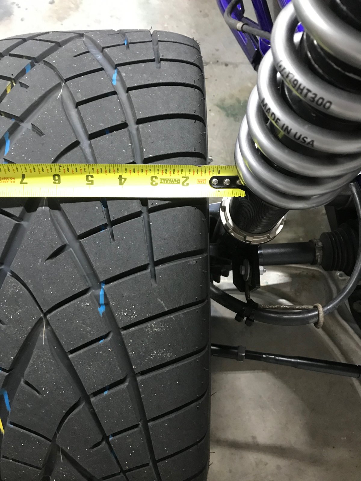

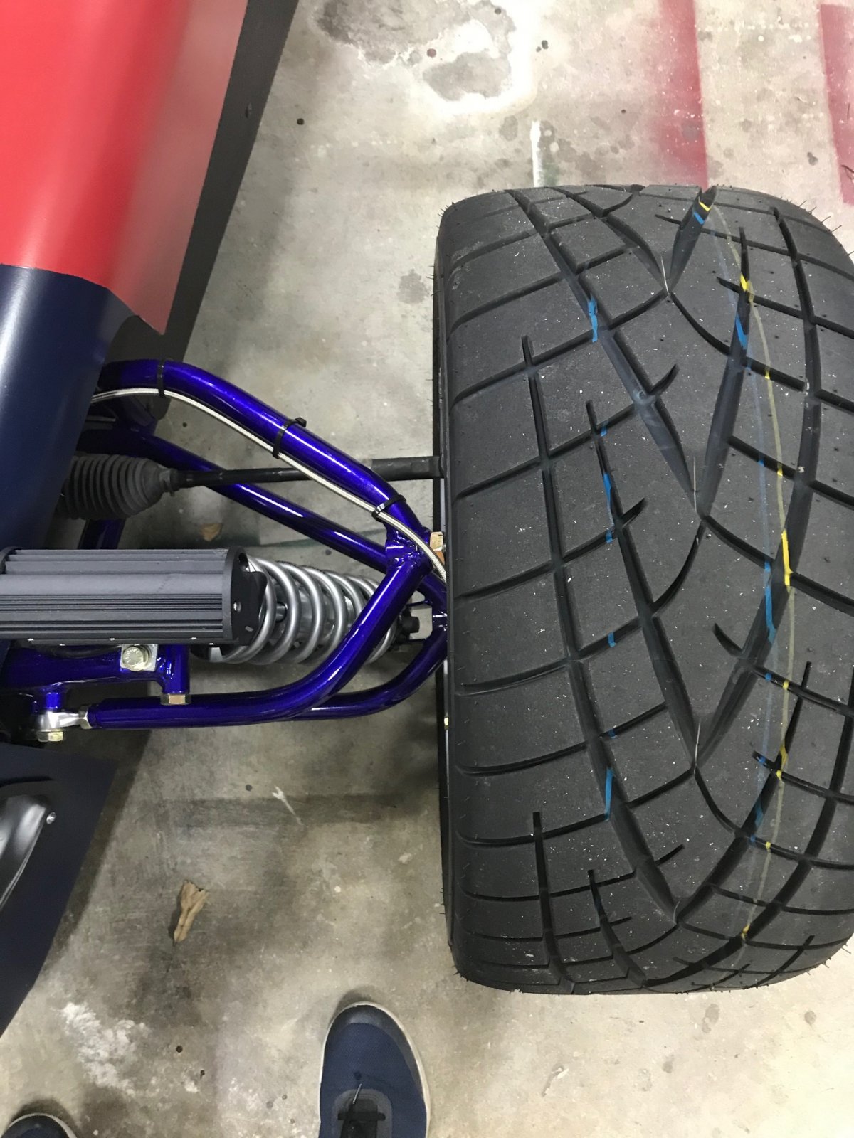

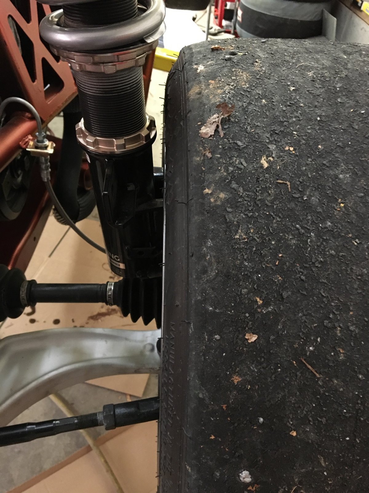

I’m running a 15x10 with a 25 offset on all four with the BC coilovers rears are very close but work with narrow tires. A 9 inch wide wheel should provide another half inch from the strut in the rear at a et25. The stock struts in the rear are much wider but I believe the stock tire was designed to tuck under the spring perch. These pictures are 23’ tall tires I now have 25.3’ tires that touched the spring collar so I put a 1 inch spacer in the rear.

Mounting surface of the wheel to inner most edge of tire is 6.75".

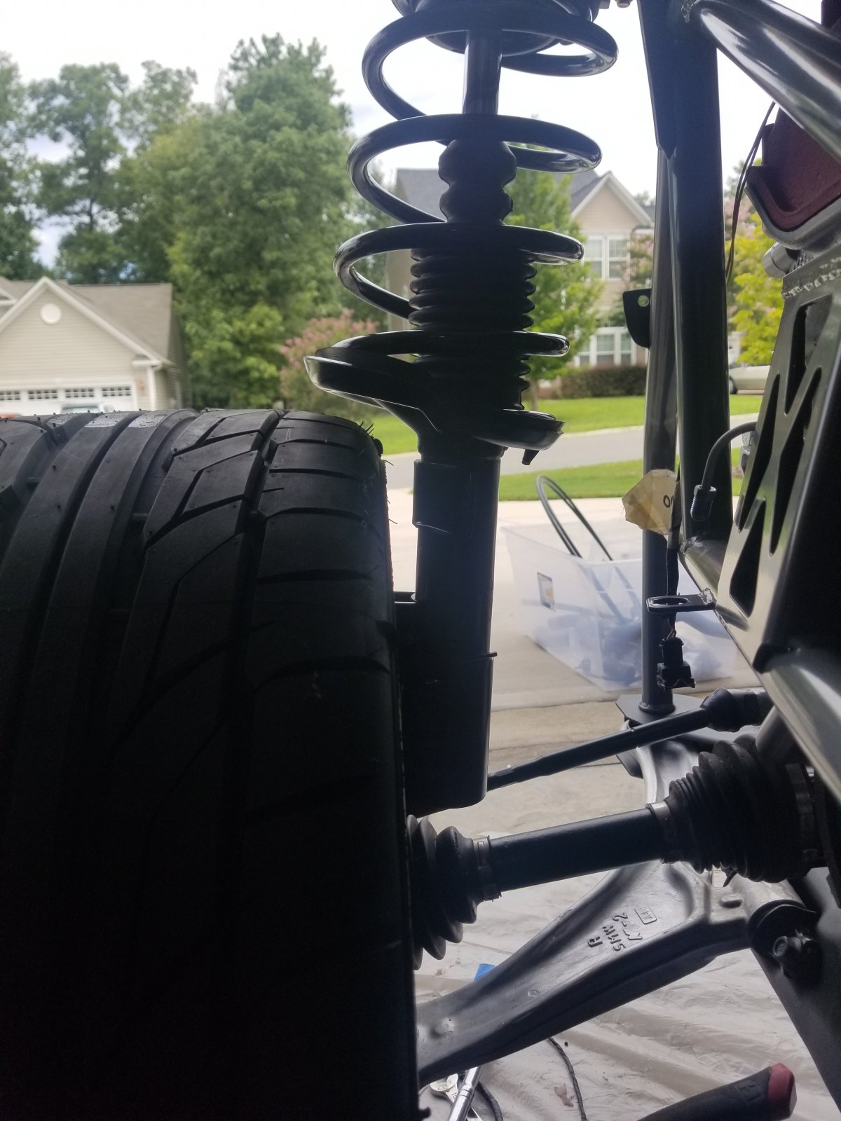

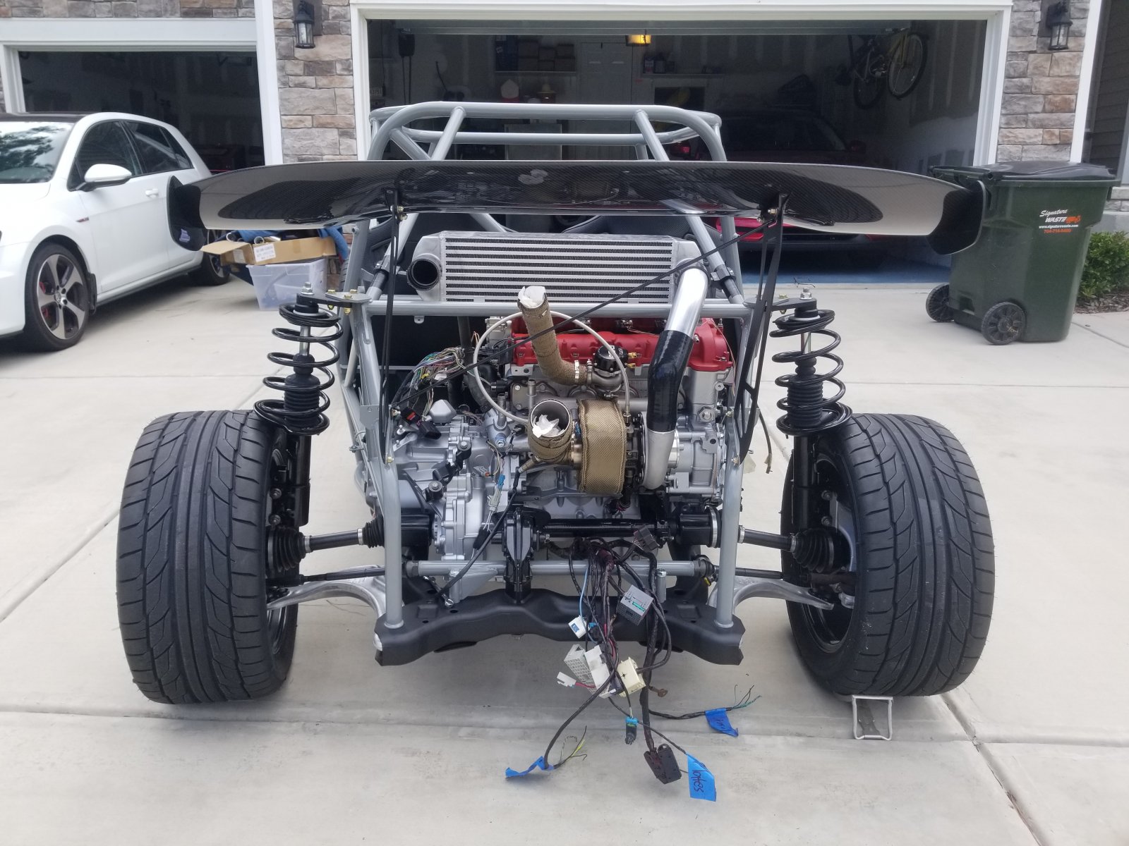

I have 17x9 all around, 1.25" adapter/spacers and 42mm offset.
285s in the rear, 245s in the front.
I haven't mounted the rear suspension yet but the calculator says I'll have plenty of room.
Edit: pics
