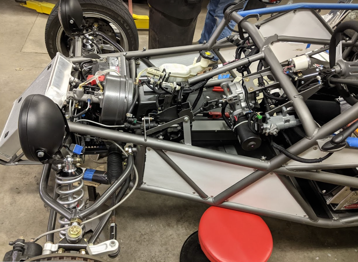

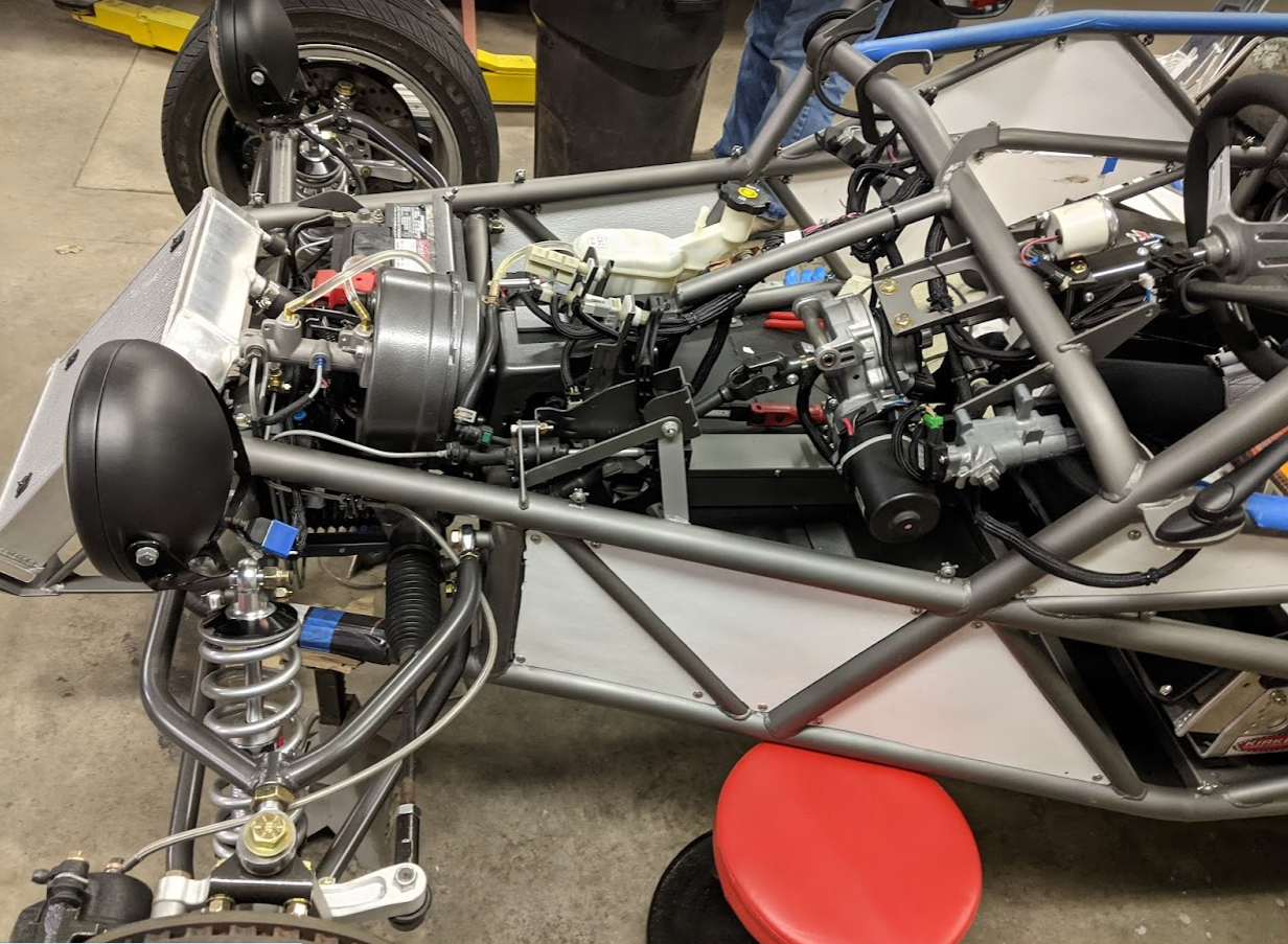

I found a pretty good picture of my car showing how it looks under garage lights. The red harbor freight seat and white panels give an idea for color too on the grey. I've seen the black, and can only imagine it will sit similarly on the frame. It's really a matte finish, and quite chip resistant. It can scratch, but can be painted over very easily without seeing a difference. If you search through the forum, a few folks have welded with it and resprayed with no issue.
