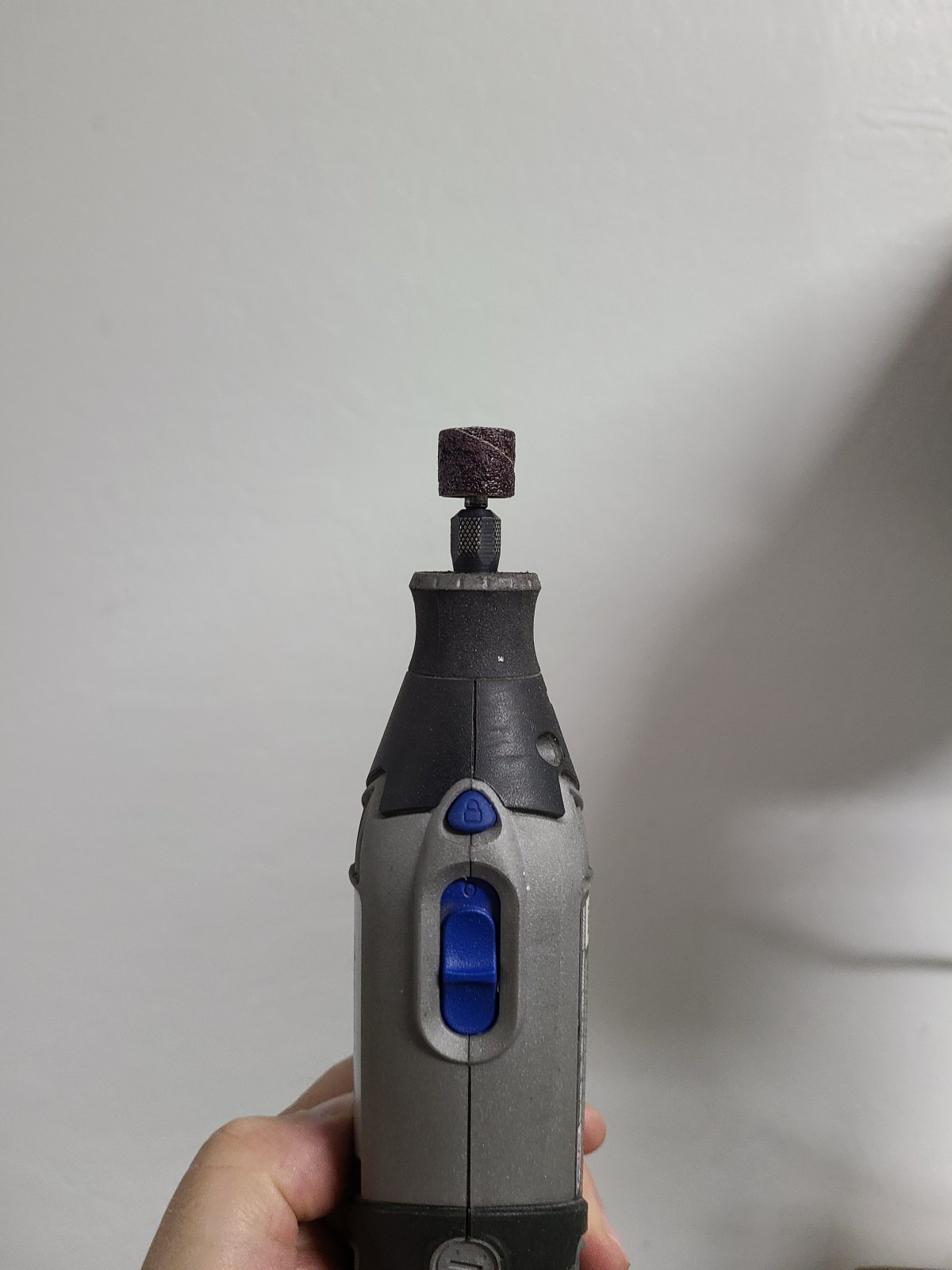

Dremel tool with the sanding cylinder would be my go to tool - and a dust mask.
