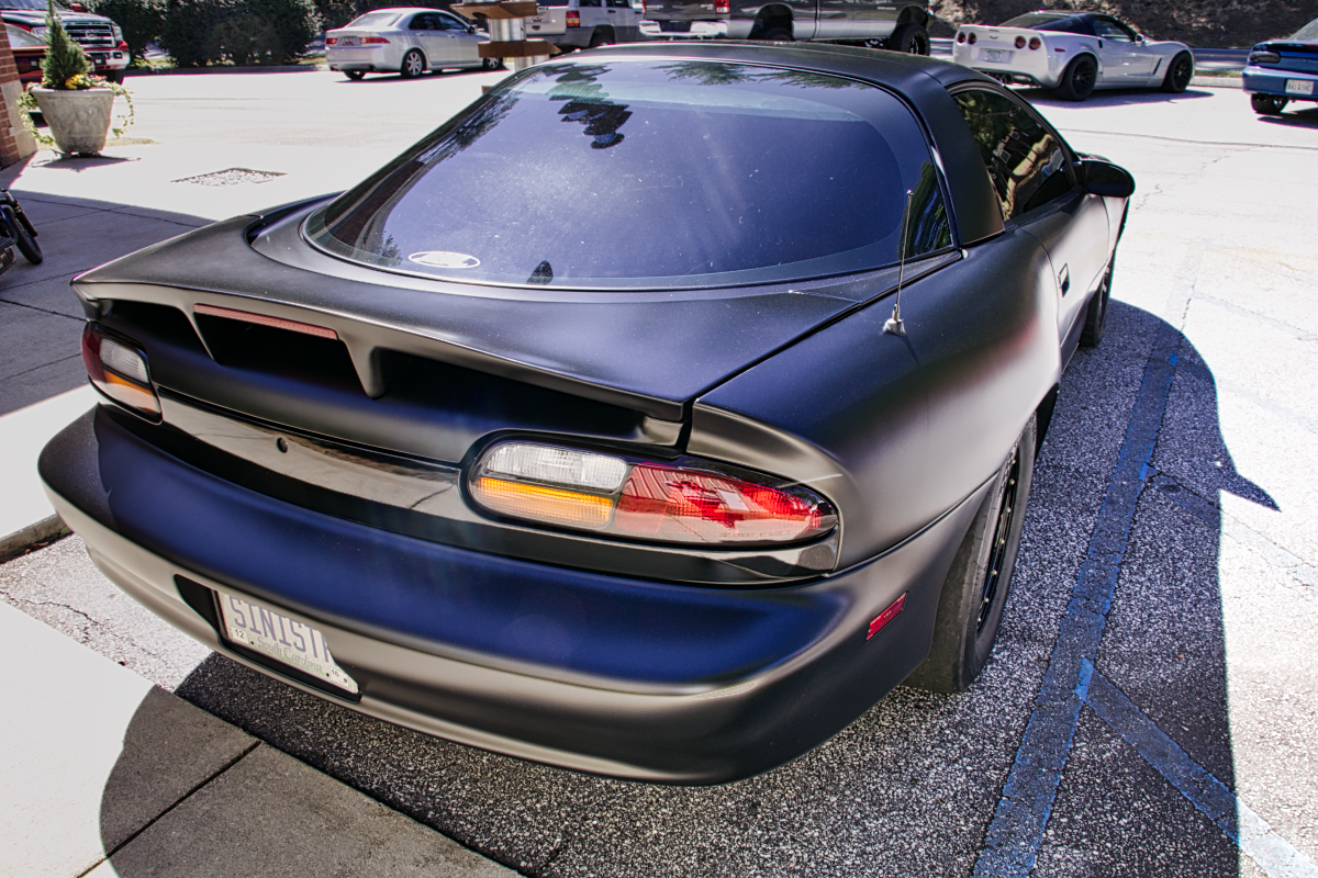

Evening all,
I am not yet a Goblin builder, although I expect to become one as soon as finances permit. But I have read the forum religiously and think I may have a windshield solution that solves a lot of issues with the existing solutions: the glass hatch on the F-body Camerobirds!
These are laminated glass for legality and the ability to be cut to shape. They are readily available both new and from JY's and are reasonably inexpensive. They have built in defrosters and wipers, and, if hinge mounted from the front top crosspiece of the 'halo', they will give substantially increased clearance to the steering wheel. It even should yield better aerodynamic performance!
How about a new windshield option for the 'halo' equipped Goblins?
Whatcha think, guys?
Larry
PS. Sudden thought (rare things I must cherish!) Does anyone know if the sunroof from the donor is suitably sized to be used on the 'halo' cars in lieu of a Bikini sunshield?
So you are talking about this piece of glass? I wonder how wide it is.

Yep, that the piece of glass....another possibility, possibly with better sizing and initial shape would be the Corvette.

You are quite correct as to the necessity of the rear glass being required to be laminated. However, if you check you will discover that they ARE often laminated, as for example the F-body.
Larry

A bit to wide, and most states will not allow the lines of the heater in the drivers view. However, my BirkinS3 seven has a heated front windscreen, but you can not see the lines unless you deliberately look for them.
I believe I measured Brad's (George's) Goblin at 44 inches at the front hoop tubes, when we were in Arkansas at a meet up.
(Copied from a forum post, so your measurements might be different)
The Top Is Rounded An Measures 45 1/4 The Bottom Is Squared And Measures 46 1/2 .
