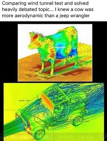

I'm waiting for the day someone pays 9 lives to run CFD on their ride and we can get some good value of these discussions. It's always split - half who believe we have the aerodynamics of a cow (which is arguably better than a wrangler as seen below), and half who hope our efforts mean something with a bit of seat of the pants feel and maybe some laptime numbers. Anyone want to volunteer to get a vehicle scan? ;)
35991
(and yes, this is only a contour plot, it doesn't actually prove much of anything, but it's funny)

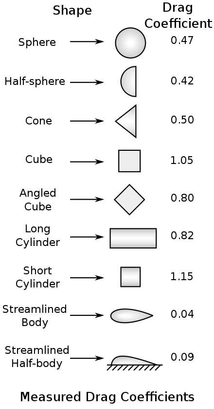

If you want to get scientific and do some guesstimating, the following Cd examples can generalize what to expect if a Goblin were to be dropped into a wind tunnel:
From a practical standpoint, my guess is a Goblin is generally akin to a long cylinder (0.82) but does have a somewhat cone shape (0.50) with the hood and side panels installed - depending upon your point of view. Not great by any stretch of the imagination.
But frontal area (area that is >45 degrees perpendicular to airflow) also plays into the equation as Cd - as this factor multipied by frontal area equals total drag. Essentially, 2 exposed tires (12.5X9 inches - 1/2 of the height), a windshield (40X12 inches) and a radiator opening (13X16 inches) makes up the bulk of the frontal area, plus some frame tube structure - or about 6ish square feet (this excludes wings, spoilers, etc).
If the guesstimate for Cd is between the cylinder (0.82) and the cone (0.50), say 0.66 (which correlates to a Lotus 7 listed as 0.65 Cd), the Goblin should have a total drag of about 39 ft2 calculated. Yes, it's a brick, but adding downforce to that brick, that minimzes any added drag, is what can help on the track.
The best way to achieve that is to have a front splitter, flat bottom from front to rear, side splitters/strakes/skirts, and a rear diffuser - all of which contribute to the most efficient means of creating downforce and don't contribute significantly to aerodynamic drag (no frontal area is added and can slightly improve the Cd). Which was the original premise of this discussion. Look at it this way, there must be a bottom on the Goblin, why not make the most of it and modify it to achieve maximum downforce. ;):D
