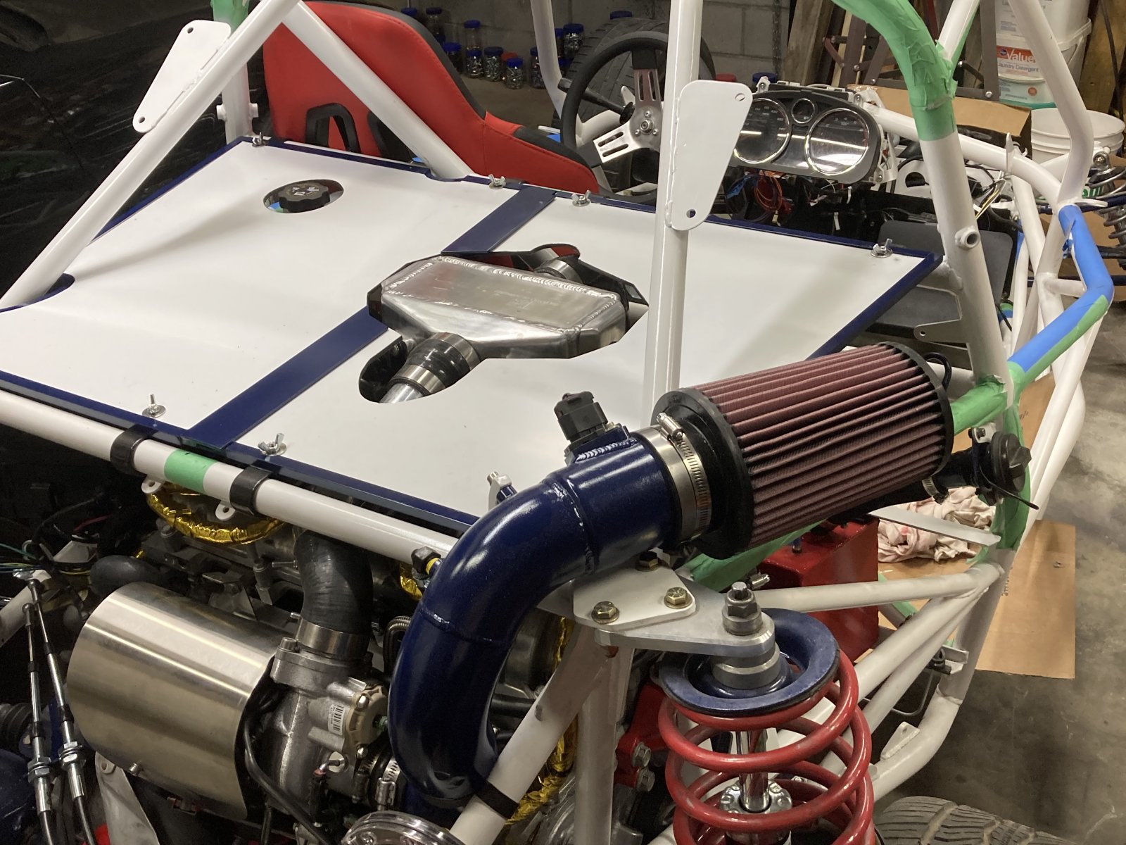

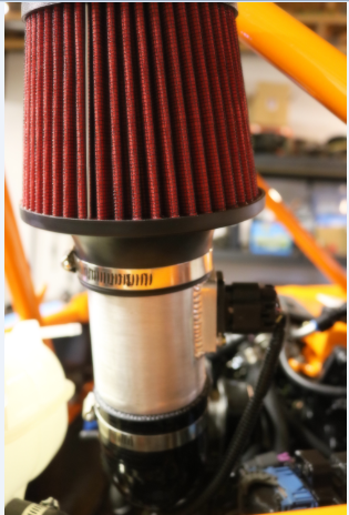

Lesson learned. Be careful how you place your air filter. During our build, I thought that it would be a good idea to keep it up in the surrounding air and away from any engine heat. It was standing almost straight up. Well, during tuning of the MAF tables, I was out collecting logging data and when a gust of cross wind would come, it would blow the AFR off the charts! During slower driving and no wind, they would be right were the should be. I couldn't even get a few miles before returning home.

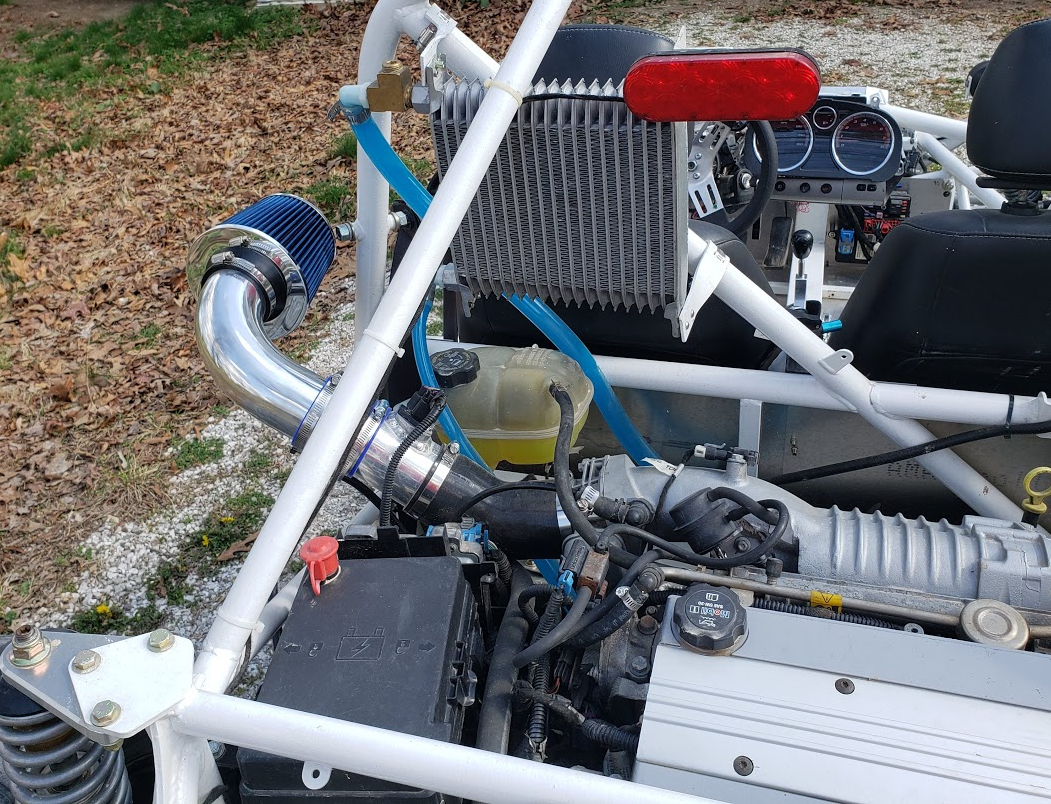

I still had the 45 degree 3" silicone provided by DF that I never used. I repositioned in down behind the driver's seat and below the coolant tank. Took the car back out and never had a problem! AFR were spot on all the time. The difference is incredible! When running on the MAF alone, it would darn near kill the engine with a huge gust of wind. I guess running normally with dynamic airflow (using the MAF and VE tables to calculate) it would not affect it as much, but I'm sure it still did.
This is what I used to have.

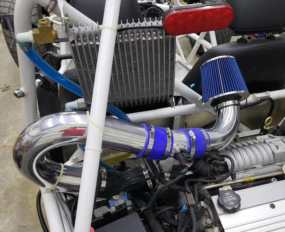

This is the set up most have and what I changed to:
22450

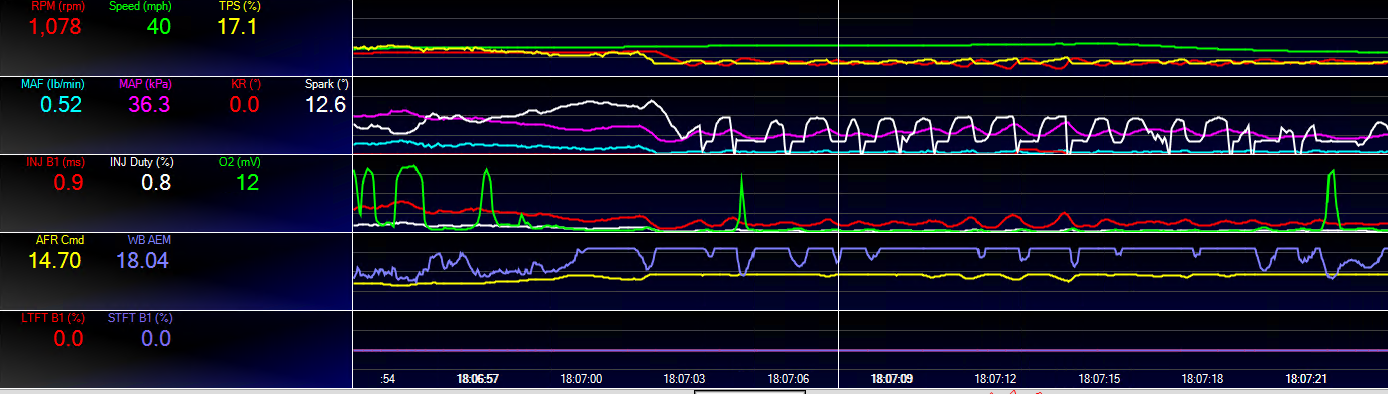

This is with the original set up. AFR Cmd is what the ECM is wanting and "commanding". The WB AEM is the actual AFR coming out of the tail pipe. Keep in mind, this is only running using the MAF sensor to control the fueling, nothing else (basically).
22452
This is just moving it, no other changes to the car or tuning!

Lesson learned. Credit to my dyno tuner, last year he said the air filter was in a bad spot. Now I believe him.
The morning of the last autocross, I noticed my red air filter was missing. Guess it fell off when I was driving.
The MAF didn't like the missing air filter, and I lost power at high RPM, and sometimes had a rough idle.
Today I put a new filter on, and added a 90 degree aluminum pipe, to try and make laminar air flow thru the MAF.
22516
It runs great, and I hear the supercharger a lot more!

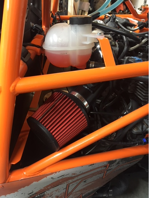

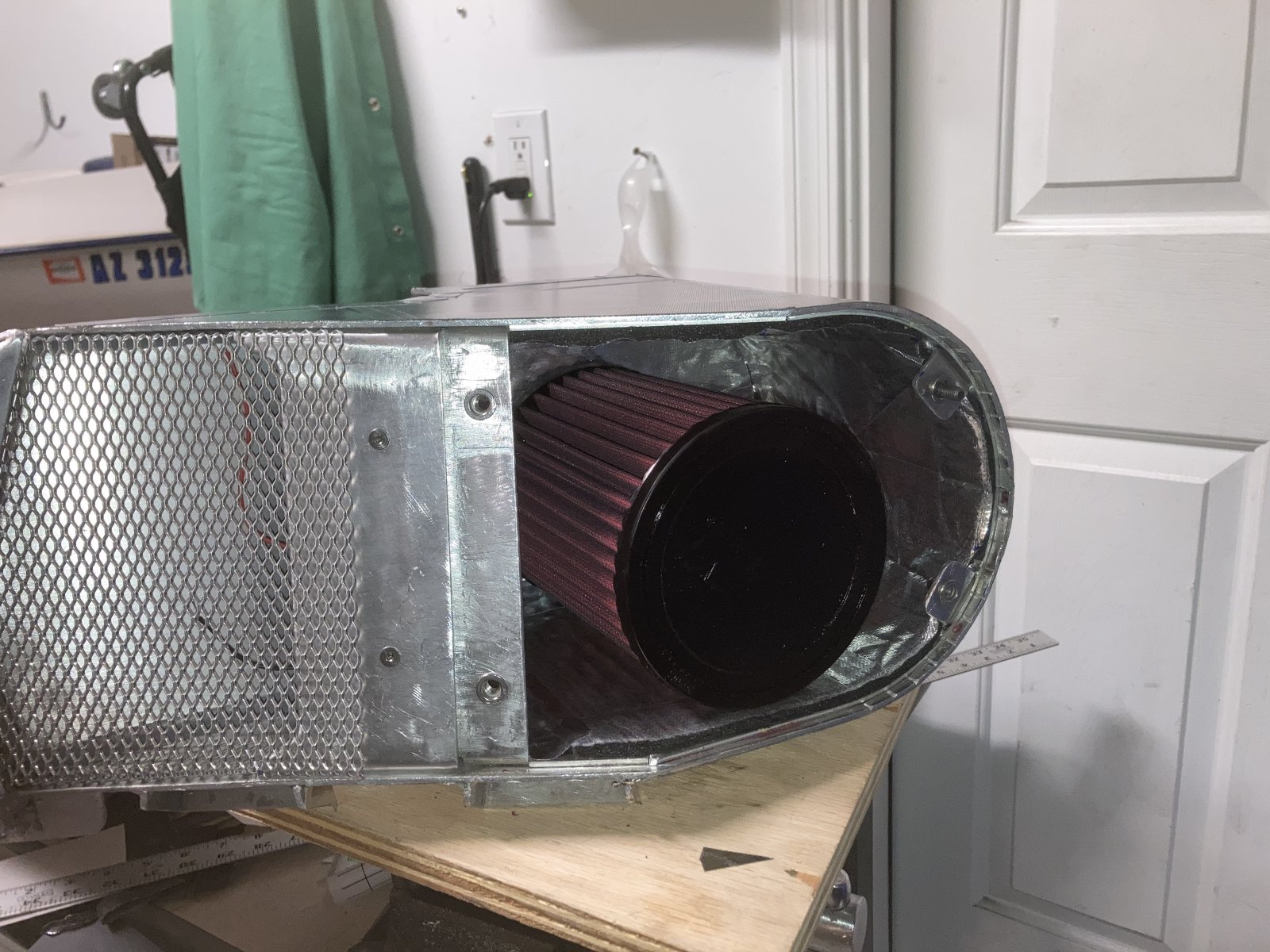

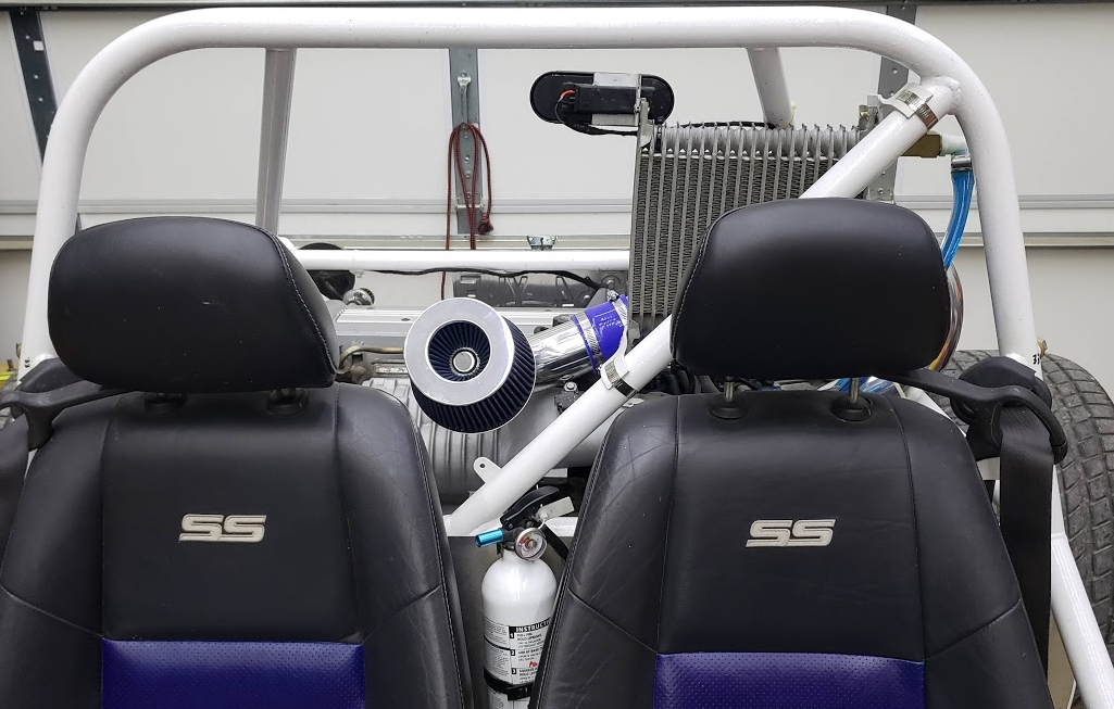

Tomorrow I will try this Atom arrangement.
22519
I want the passenger to enjoy the music too.
22520
If I was willing to cut the pipes, I could get a better routing, but I will try and see.

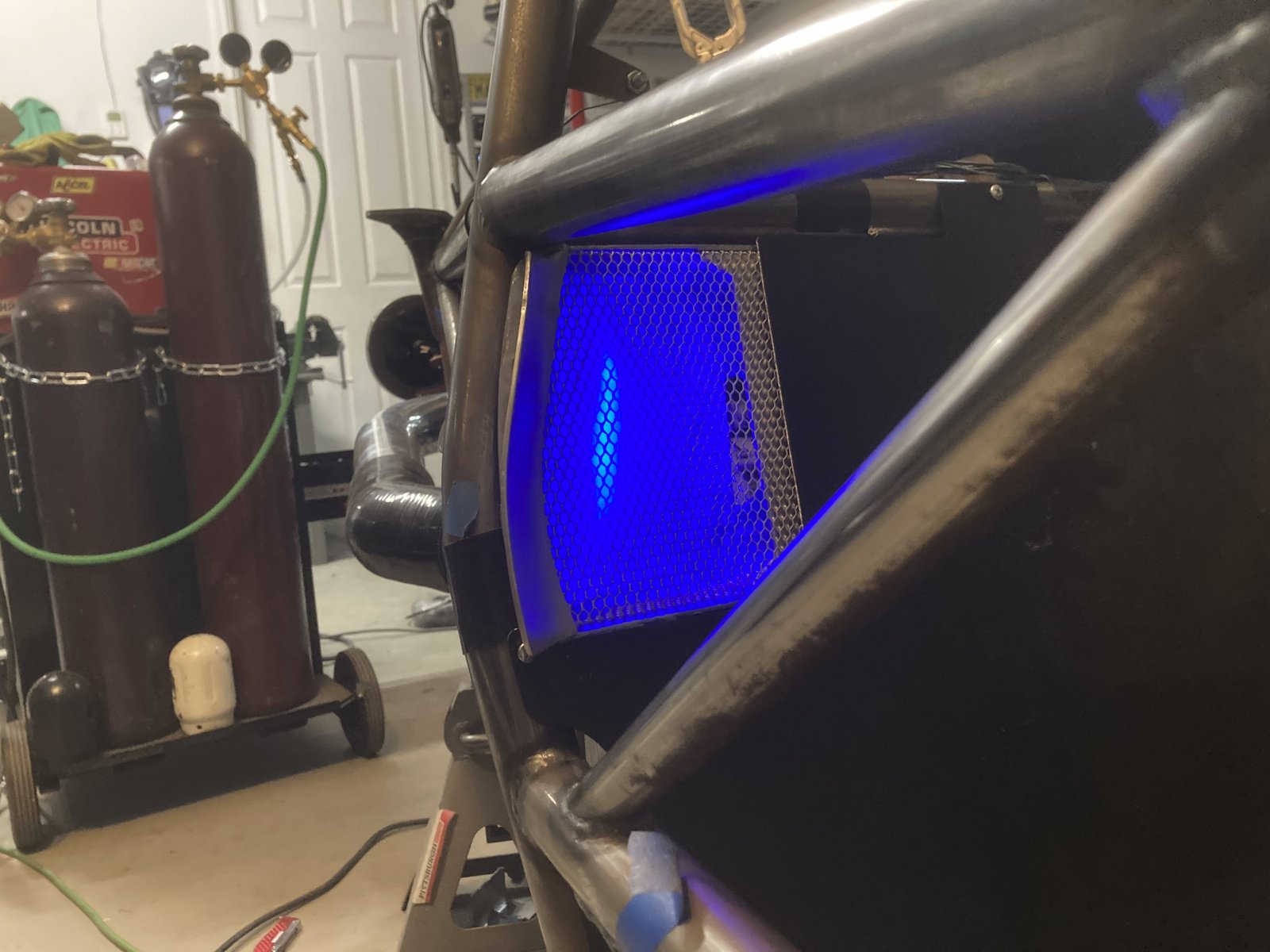

Just this weekend while at the Autocross, Kaleb said while sitting there waiting to go a gust of wind would come up and blow against the side of the car and darn near kill it while idling. This is even after moving it down, it’s still open to the side. And then while in the course making a hard right turn, a gust from the left side caused a bog. I’m going to cover the side with some tinted acrylic.

What's the horz. scale of your graphs above? Was that a few seconds or a few minutes?
How about throttle/RPM? I assume that's light throttle/cruise since command ratio is 14+. 18:1 is LEAN and it looks like that might just be as high as the sensor can read since it's clipped off exactly at the same point.
I’ll include more of the scan log when I get home. I should have but figured it might be less overwhelming to some if I keep it simple.
I tried to get close to doing a screen capture of the same area of the log, but this time include the time stamp and all of the other logging. You can see my speed was steady, the throttle (TPS) was mostly steady. You can't really see the MAF move with this because it's scaled so low but increasing the scale does show it move.
22707
I'll include both files, the before and after. The trip wasn't the same so the will not be a direct comparison, but you can see trends and how it reacts. 0034 is the before and 0037 is the after. No changes to anything other than the position of the air filter.
