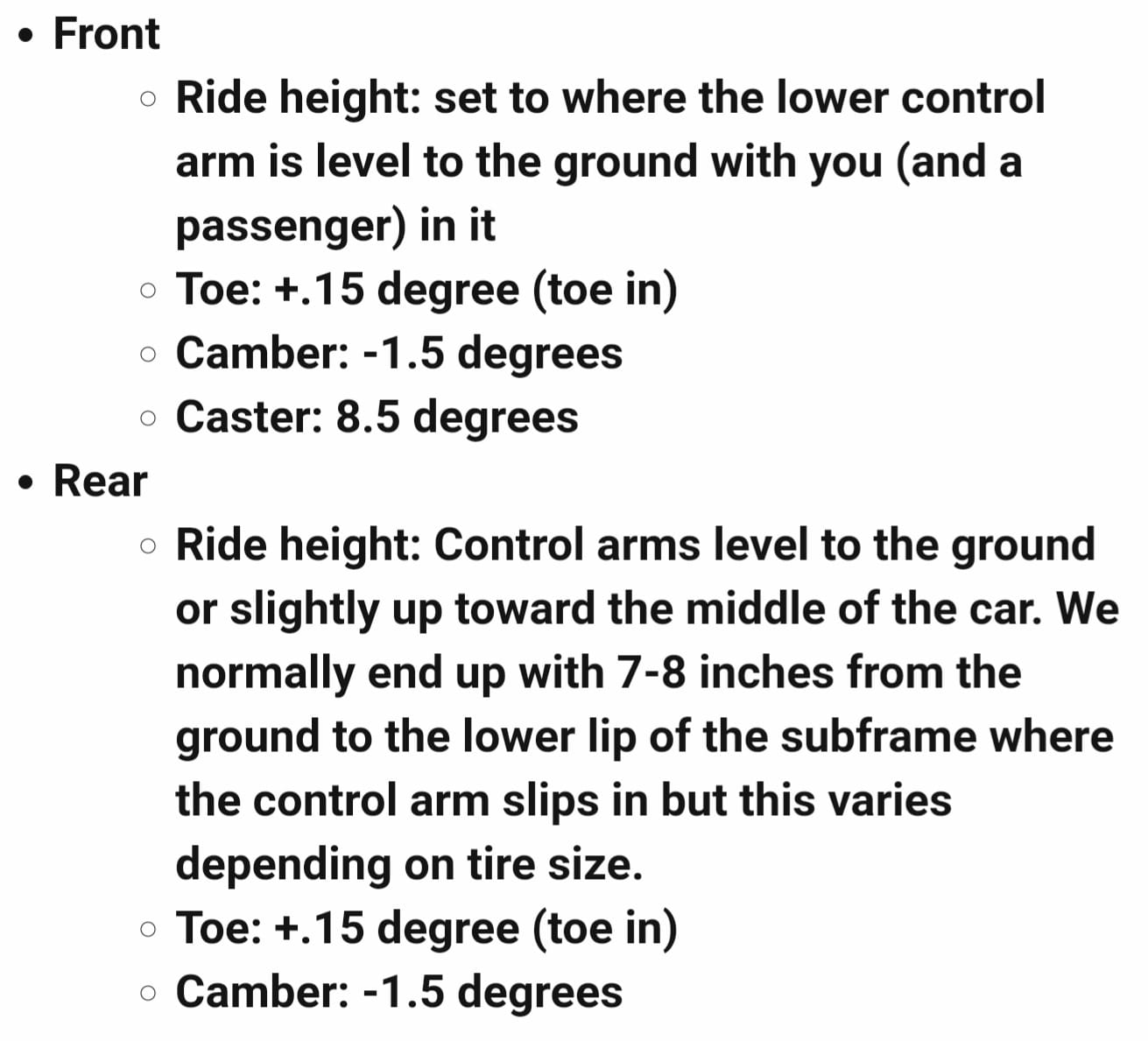

Took this from @CaptFrank2001 and I believe he is set for normal street use. This is what I’ll be dialing to since I don’t autox any.

I did mine to the exact specs that Lonny and Adam outlined in their instructions. I handles like a dream tracks straight,,, hands free on the road. I would say it is perfect for cruising... Looks like you guys have the racing stuff covered.

That's the numbers I was shooting for & was the info I supplied to the guys that did my alignment. Car tracks great "hands off" so I have no complaints. This car was set up for the road & will never be on the track. Well maybe one time run a 1/4 mile.
