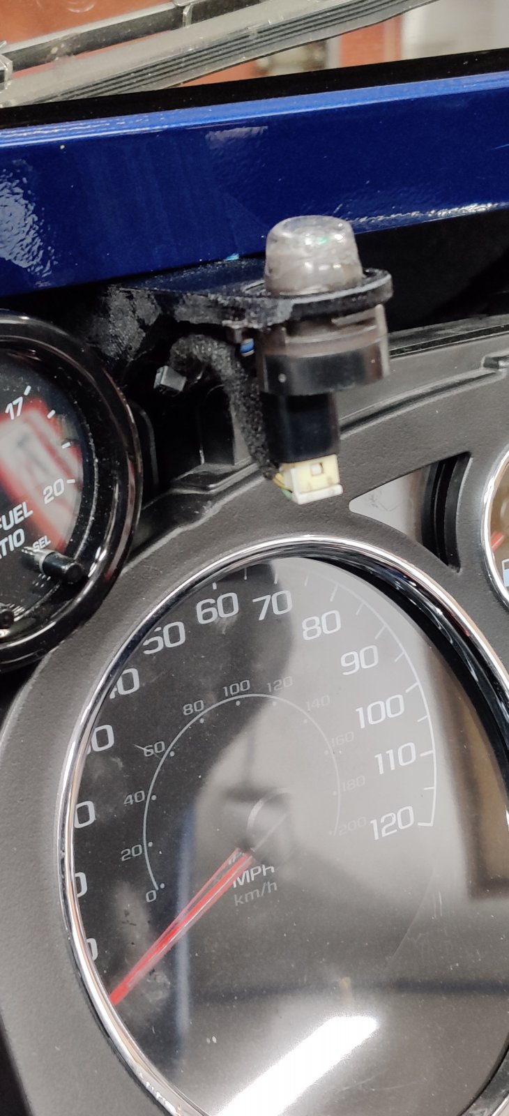

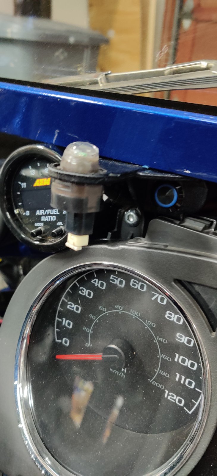

I mounted mine above the speedometer. I had it off closer to the steering wheel at first but I needed to make room for my gauges. so I printed a new bracket and moved it over. I put the button in the back for my garage door opener to keep it out of sight
My lens looks a bit strange on it because I wanted to delay the switch over from DRL to auto lights. So I tried to make a clear lens. I did not clean up the bracket because I am not positive on keeping the location yet.

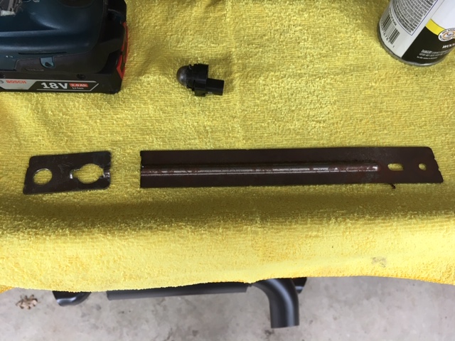

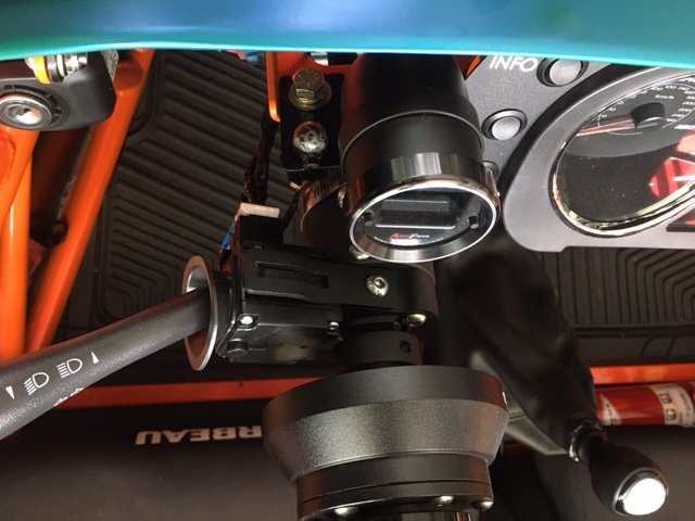

Thanks for the suggestions. I was inspired and made a bracket to bolt to the steering column mount out of a leftover bracket from the Cobalt. My sensor cover is peeling a little, but it works great. That was one thing I was not happy with about the Goblin. Its nice not to have to fiddle with the lights now...

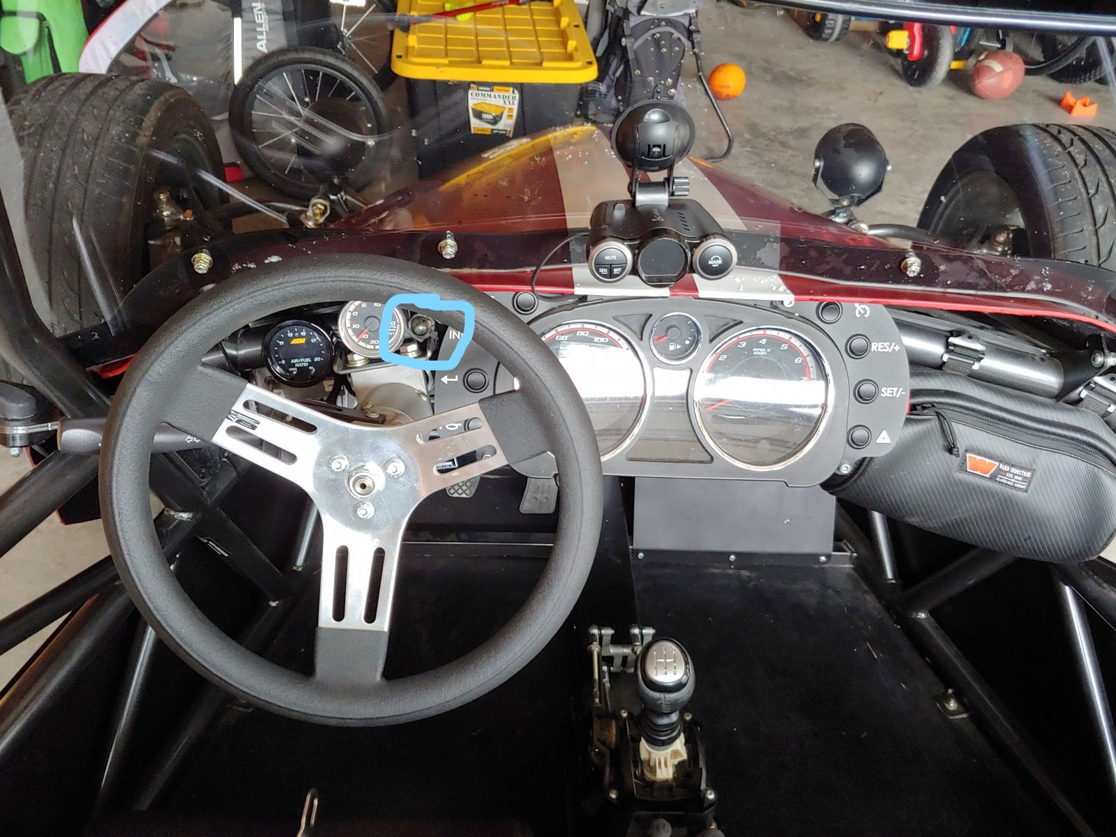

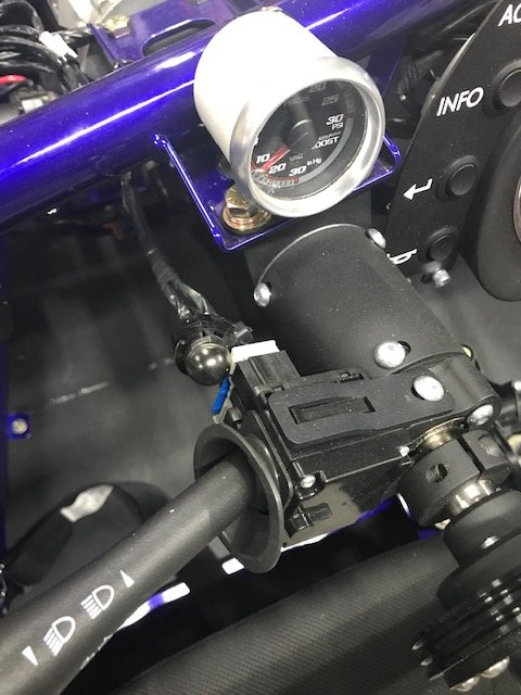

Here's where I put the ambient light sensor:
19030
Instead of needing a bracket, it's held in place with a velcro strap to the powder coated steering column bracket, snugged up to the boost gauge. It works pretty well there, I haven't any noticeable times that I thought my lights should be DRL only and were instead triggered to be on.
