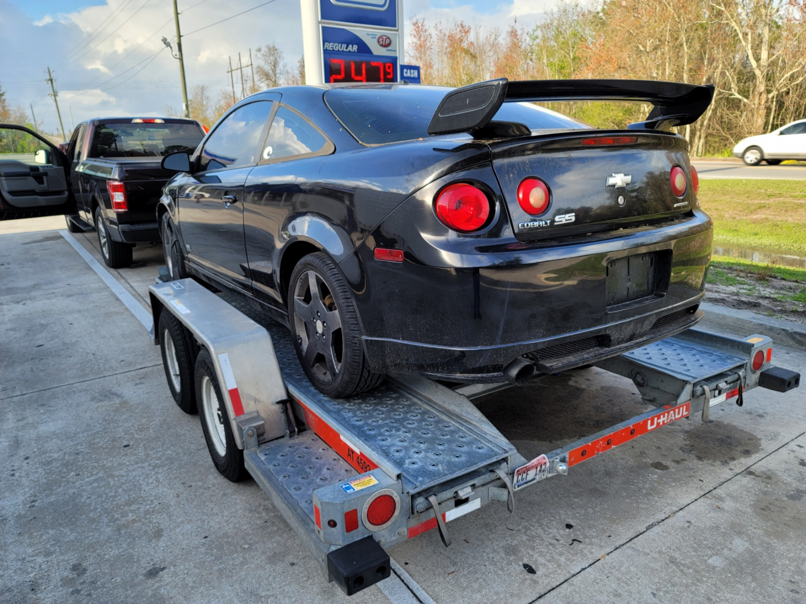

The less complicated way is to get the SS/TC donor. I contemplated going the no donor route or a NA donor, but in the end I held out for the TC donor and I'm glad I did. When all was done I had all of the parts I needed for my build and made money parting out the donor.

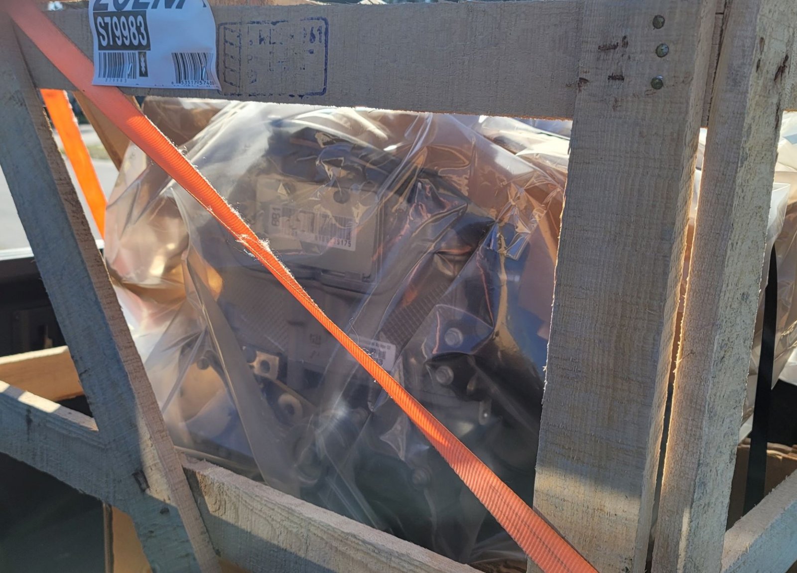

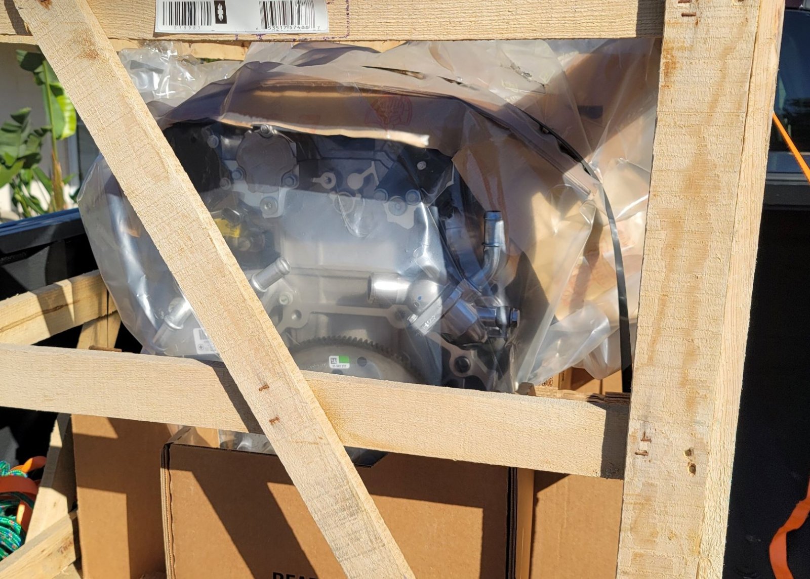

And so it begins...

Motor sure is nice, hate to have to paint it but don't want let it start to corrode. Has anybody had any luck with just shooting some clear on one?
I put clear on the DF billet aluminum parts in the front spindles, and aluminum/silver on the engine. I think the clear won't last as long, as UV will break it down quicker, but it is holding up for now. My new shiny F35 transmission is still raw aluminum.... I think it will get silver paint, as it will match the engine color.

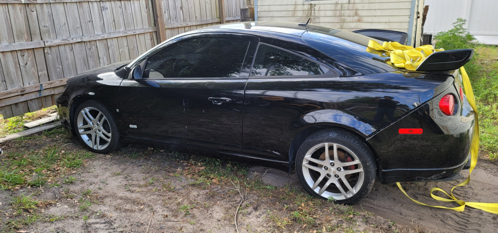

Got a second parts car, a 2006 SS/SC and tore it completely apart
