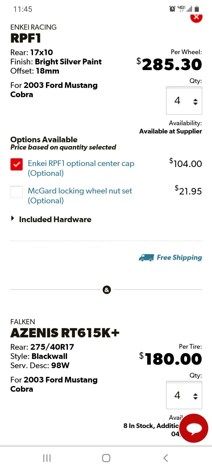

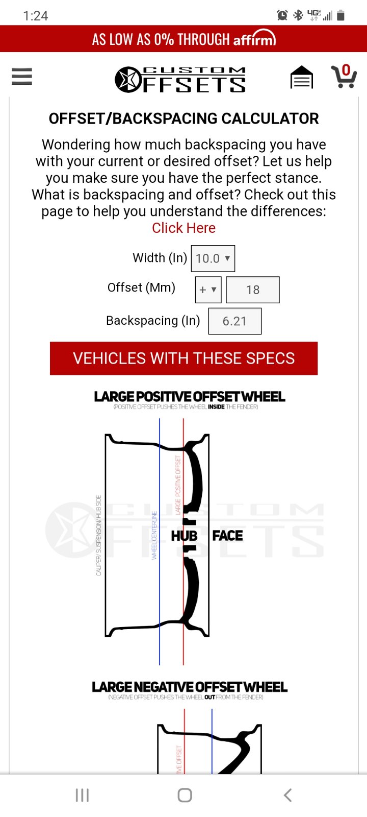

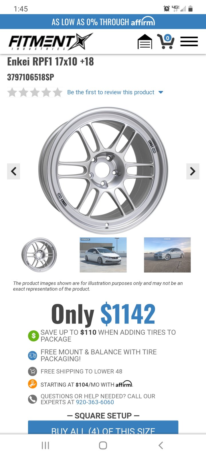

V1 Before i pull the trigger on these, they going to fit?
TheDon
TheDon
I opted for the DF drilled hubs 5 x 114.3
Looking at 17x10 wheels with et of 18
Which comes out to 6.21 inch backspacing.
According to internet factory backspacing is 6.0 inch and cobalt forums say they max at 6.27inch backspacing before hitting struts.
I think I'm allset but for about 2grand figured I would ask, thanks

TheDon
I could go for the 9.5, which gives backspacing of 5.96 inches
I have the DF coilovers for the rear will this give me more or less space ?

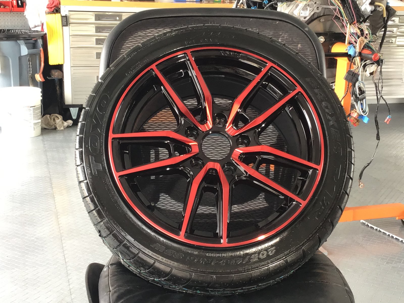

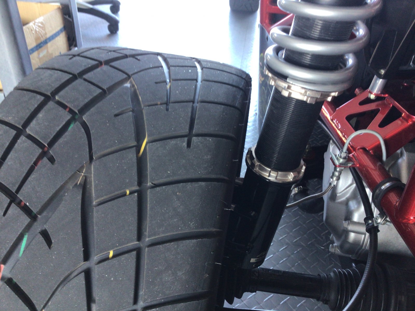

This is what I run , I don’t know if you would have enough room in rear, I don’t have spacers
