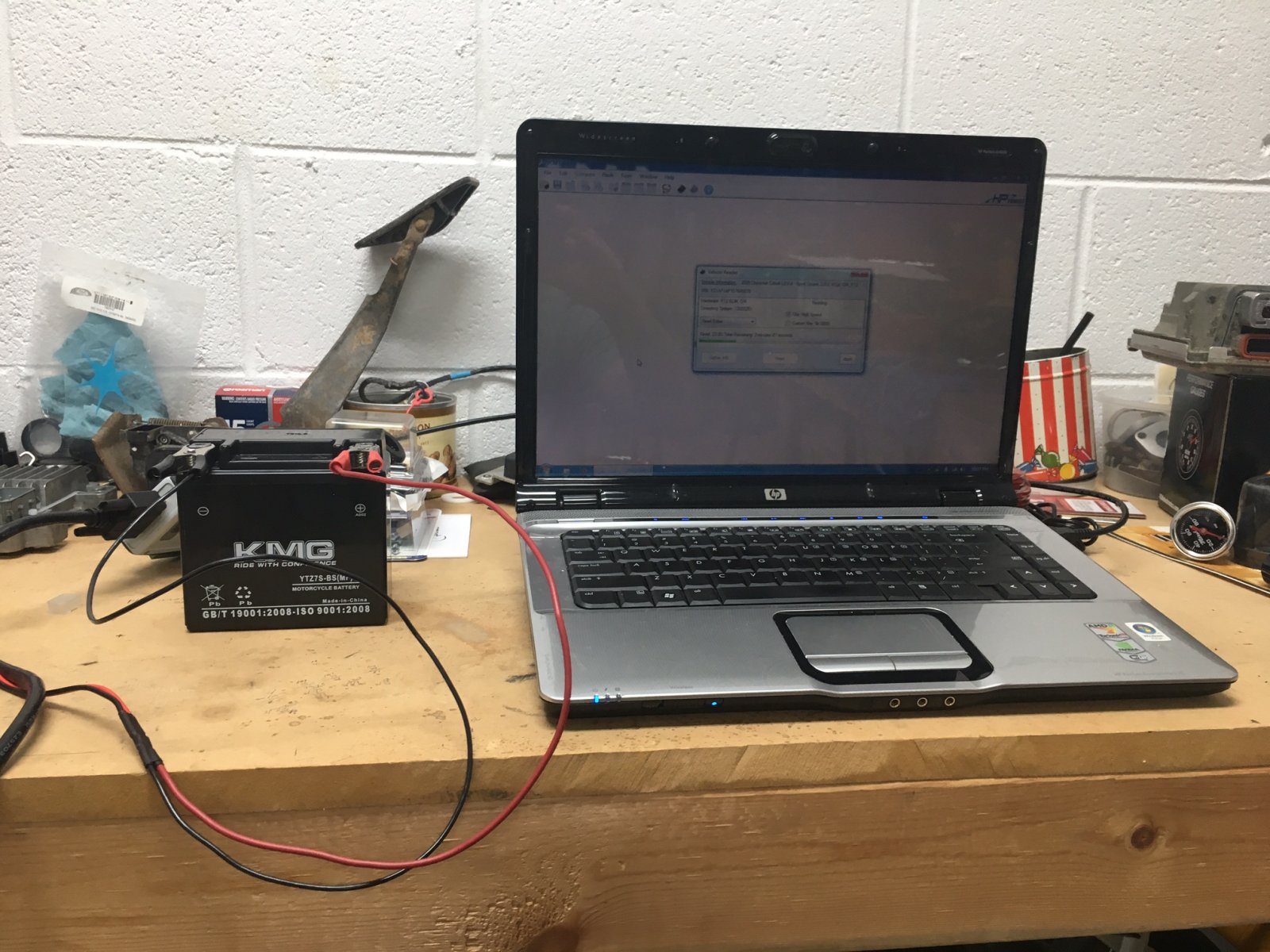

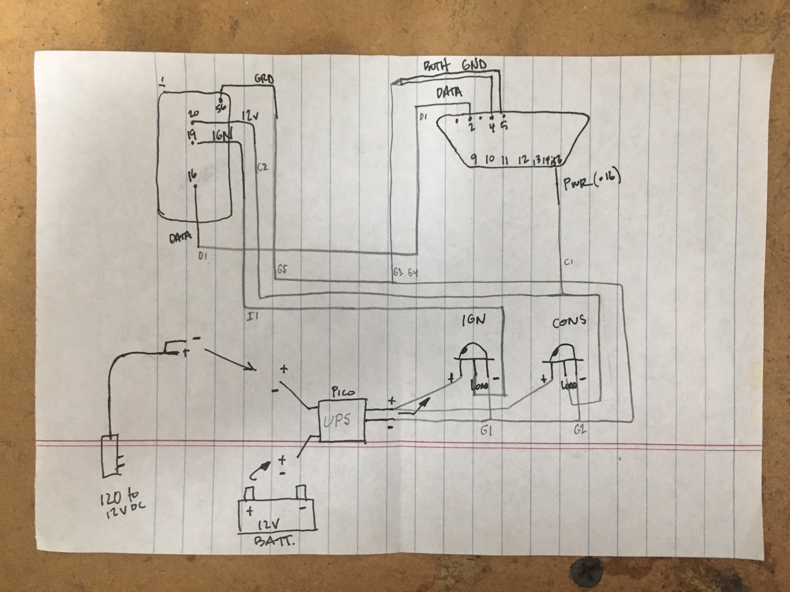

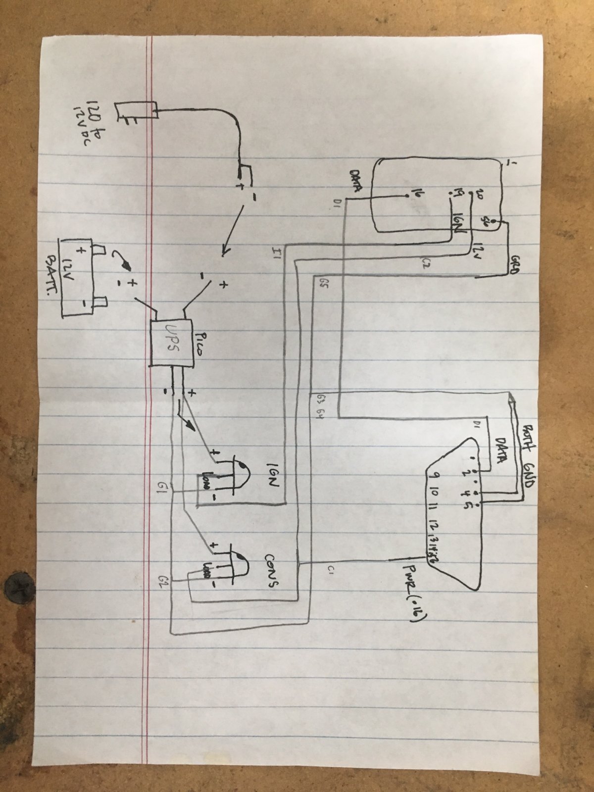

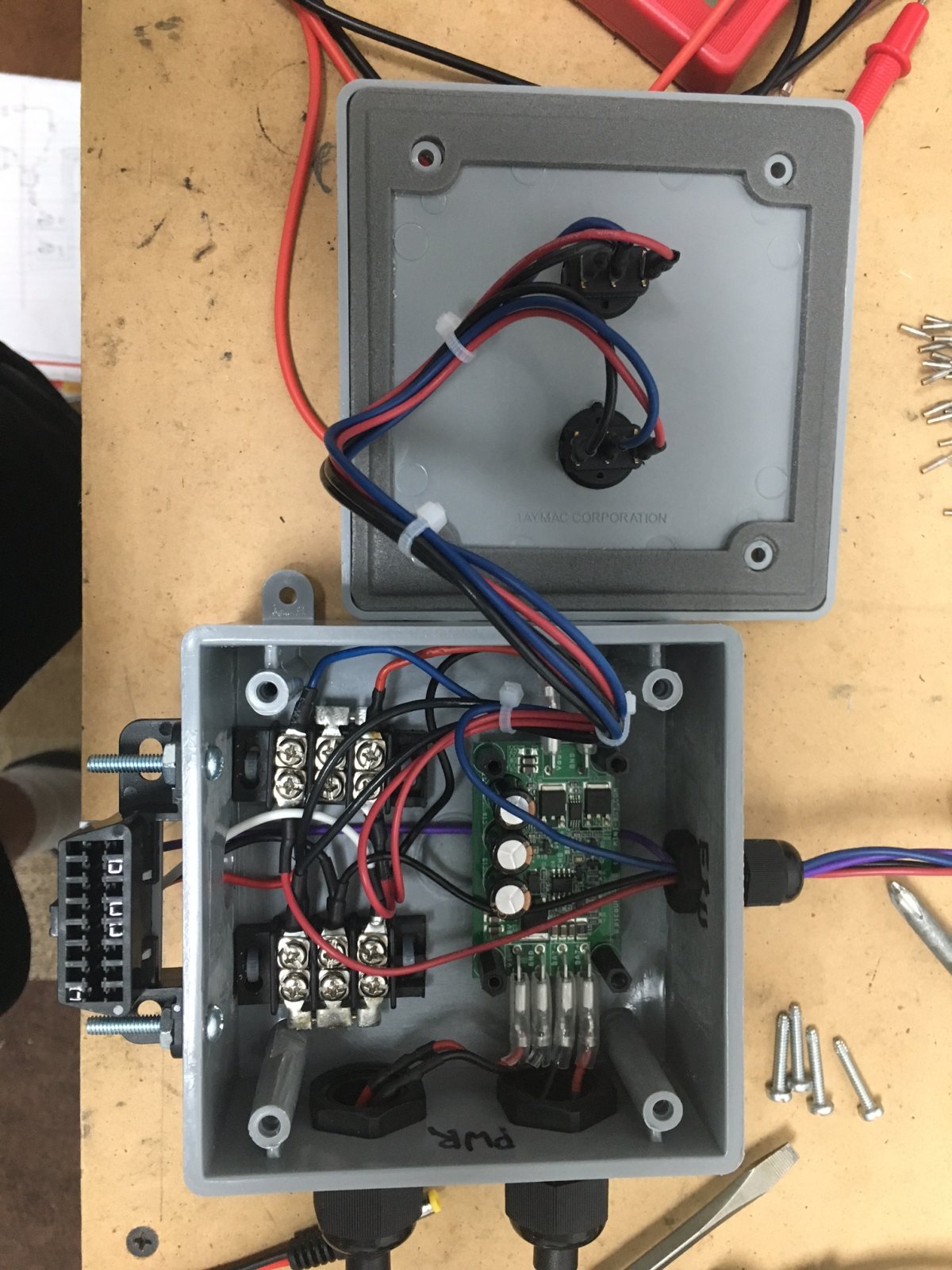

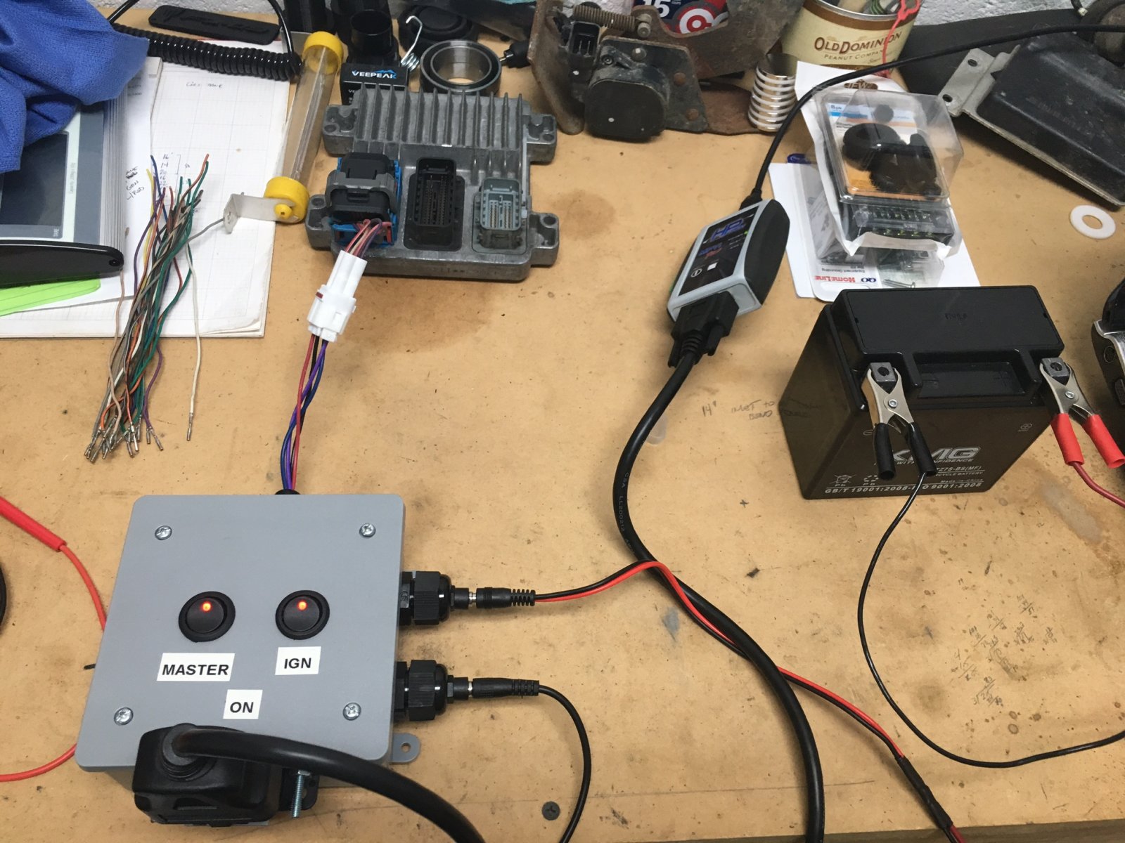

I was talking to Adam on the phone last week and mentioned the bench harness I had created. I told him I would post some pictures of it. I'm using HP Tuners to make changes. The small circuit board in my box is a UPS system - the backup is a small motorcycle battery seen in the pictures. This setup allows me to tinker with the PCM outside of the car. I had a need to do this for an LS swap I'm working on to get VATS disabled. If anyone has any questions - let me know. I'm by no means an expert at any of this, but I'm learning as I go...

A wiring diagram pin out /source list would be great!

I've got a diagram at home I can take a picture of later this evening. Your pin numbers will be different since yours is an '07 and uses a different PCM. I think the OBDII should be the same.
My setup is overkill with the two power sources and the micro UPS - which made the wiring kinda messy inside. I was just worried that if there was an outage or something that interrupted the 110v supply, it could fry the PCM. They don't take well to losing power during a flash. If you are not going to use a UPS, it makes wiring it up much simpler and I would suggest using a well charged 12V battery hooked to a trickle charger.
He probably posted it from his phone. The computer guy in me is curious abut your UPS circuit board. I'm guessing it just detects when the power from the wall plug drops and switches automatically to your battery?

I got the pin out data from AlldataDIY and confirmed it with some posts I read on HPtuners.
I did make my own PCM connector. I went to the local pick-a-part junkyard and cut one off a Malibu or something... it was the closest thing I could find to the P12 connector and it hooked right in to the PCM.
I've got the service manual that lists the pin outs. The problem is I don't see anything that lines up with the data and ignition wires on your drawing. I understand the Bosch E69 is completely different, but the theory should be the same.
SliderR1
Yeah - the theory is the same. Since it's not a delphi computer, they could be named something weird. Can you take a picture and post it?
