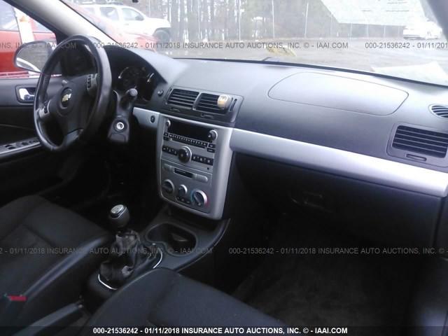

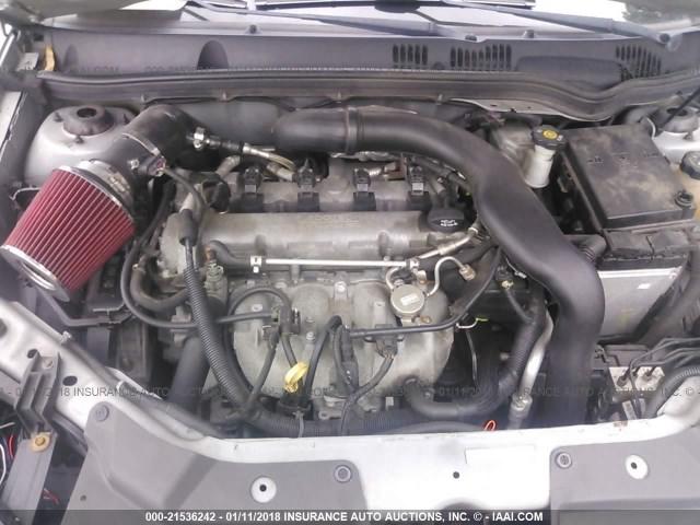

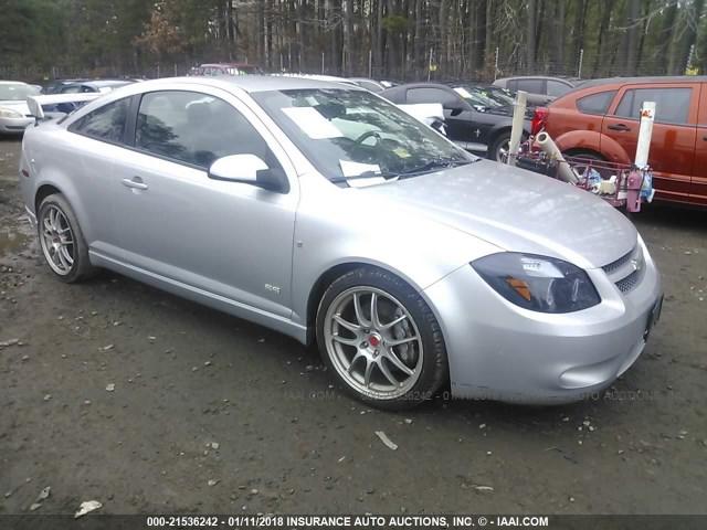

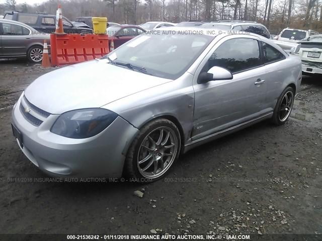

Photos of the donor attached.
BaltimoreHokie
Well that looks like a really clean car to start with you should be able to sell some of the additional parts to recoup some of your cost. The wheels are nice added bonus in case you want to use those for the Goblin

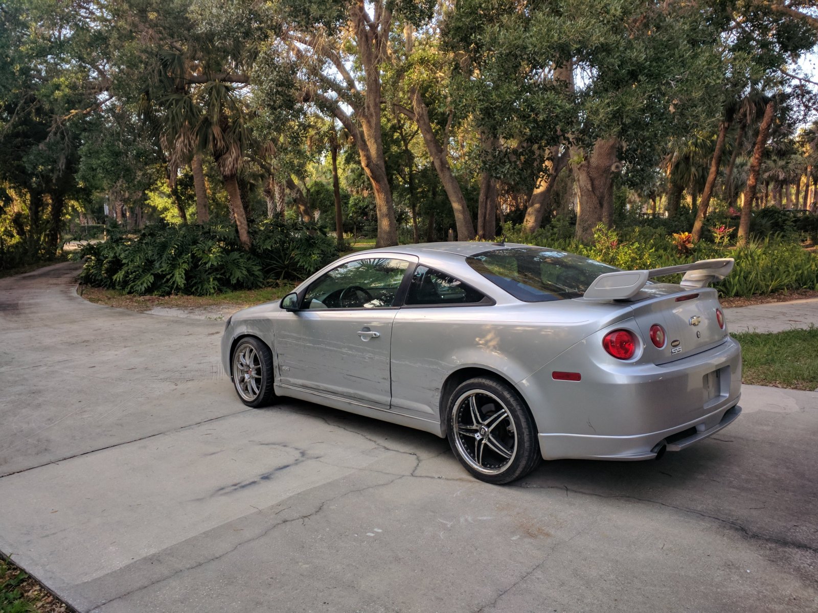

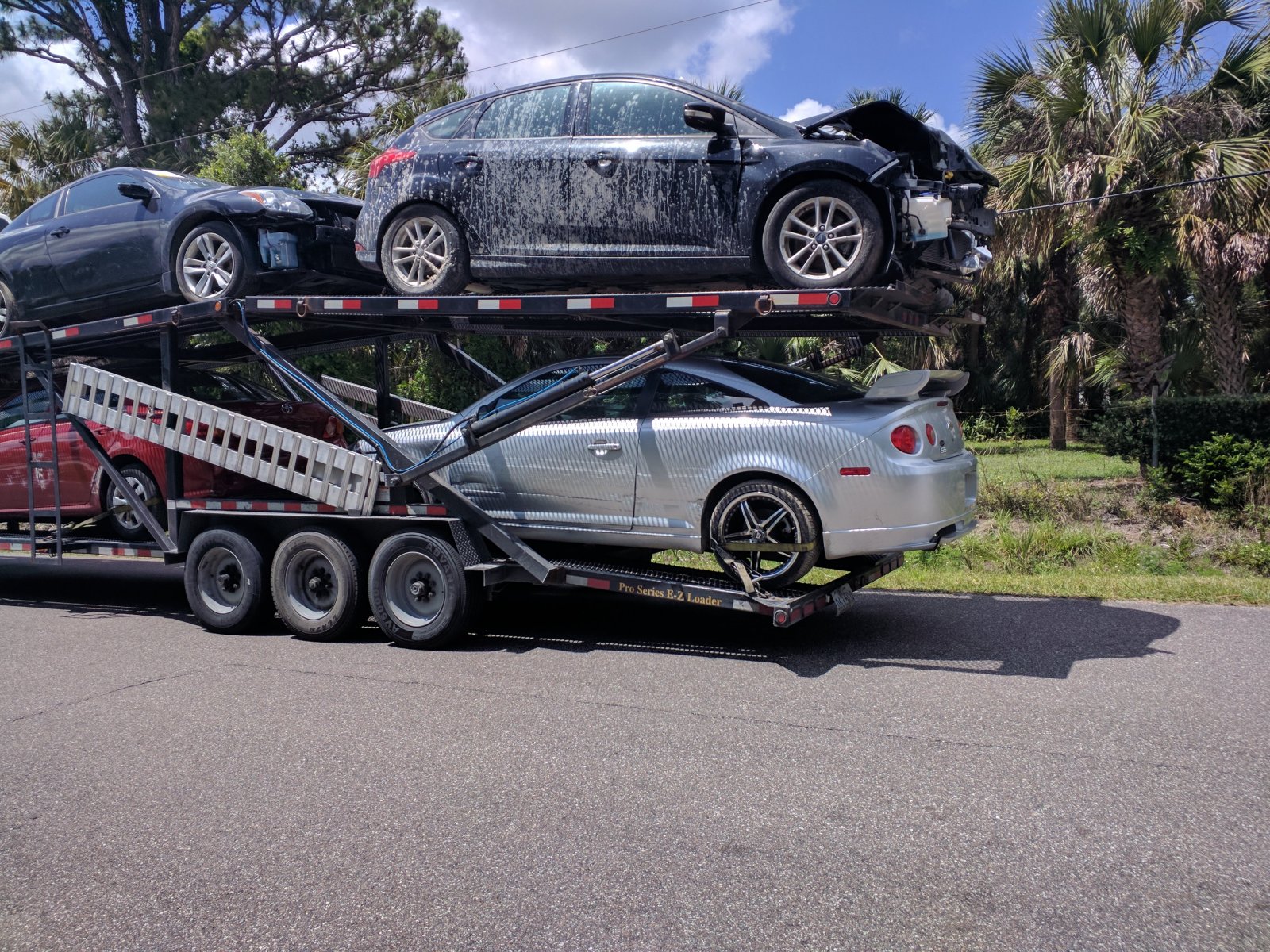

So had a bit of a surprise today. Got a call at work from the shipping company driver saying he was an hour away. So, it's here!
On the delivery truck:
And in the driveway:
It appears to be in great shape. Runs and drives no problem. Quite a bit faster than I expected. The Goblin is gonna be crazy...

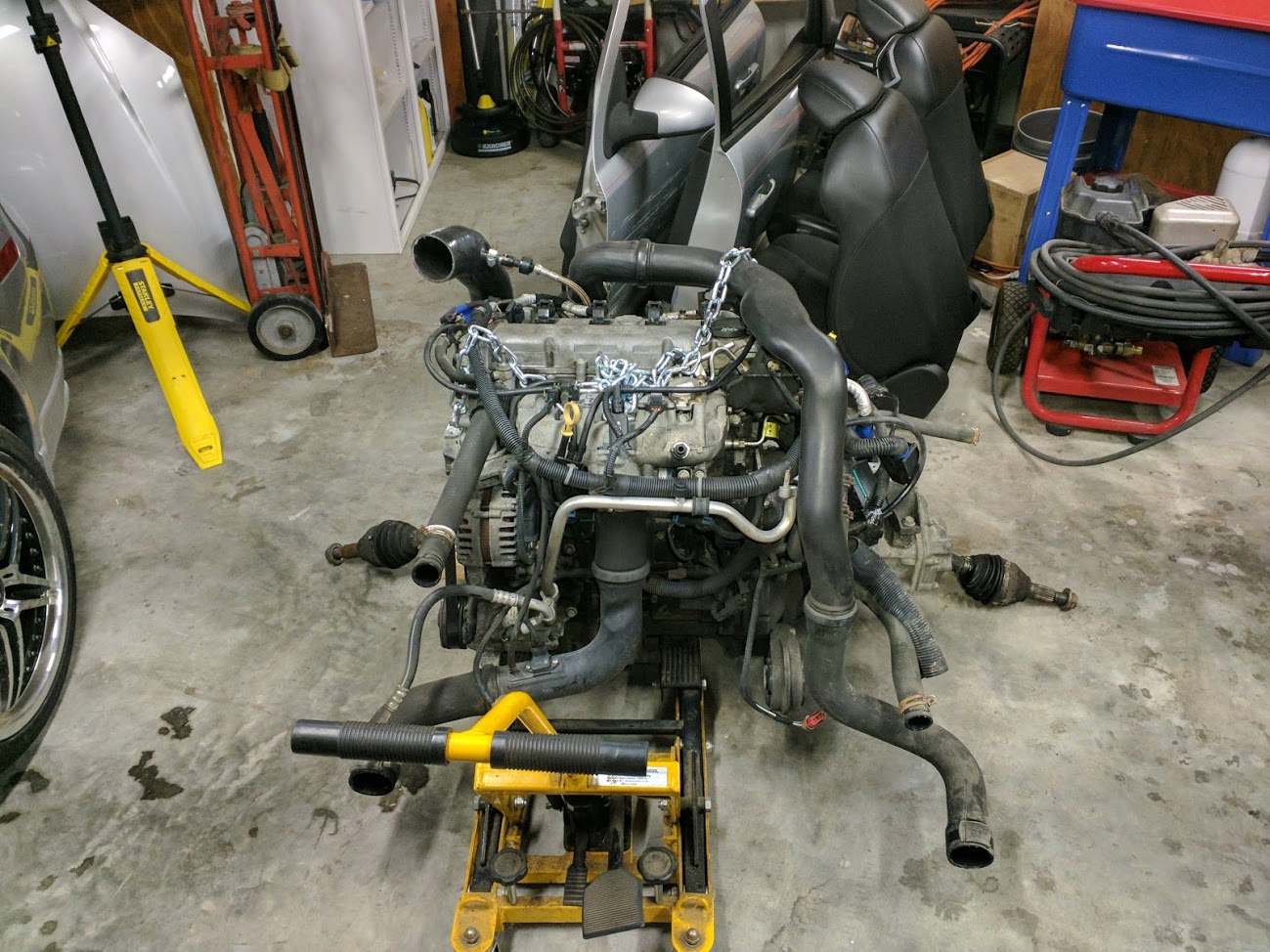

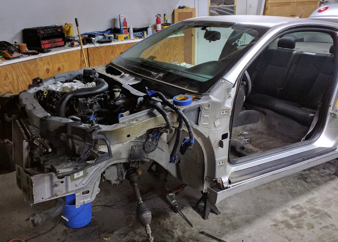

Making some progress!:
I've got one rusty used-to-be-an-exhaust-nut left to remove, and I should be about ready to lower the engine.

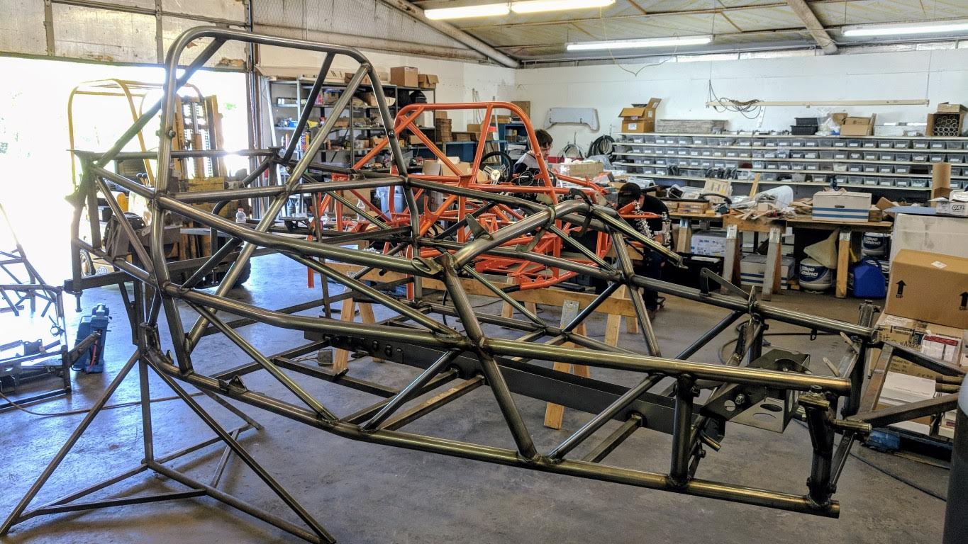

Also got a nice shot of my chassis on the rotisserie today courtesy of Adam:
Looking forward to getting it delivered!

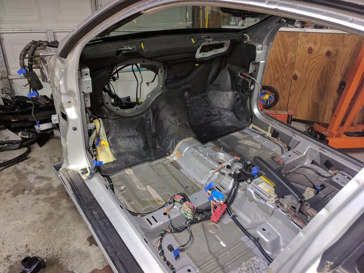

Finished stripping the donor last night. Now on to the wiring harnesses!
