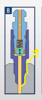

wonder if this could help
Interesting find. It will help bleed the brakes, but the fundamental problem of seating at the bottom of the threads is still the same for this bleeder as it is for the stock one. If fluid can get past the base seat, it will go past the threads and out.
True true. I may just start with a new bleeder valve and some Teflon tape and try the back and forth to get it worn in.
