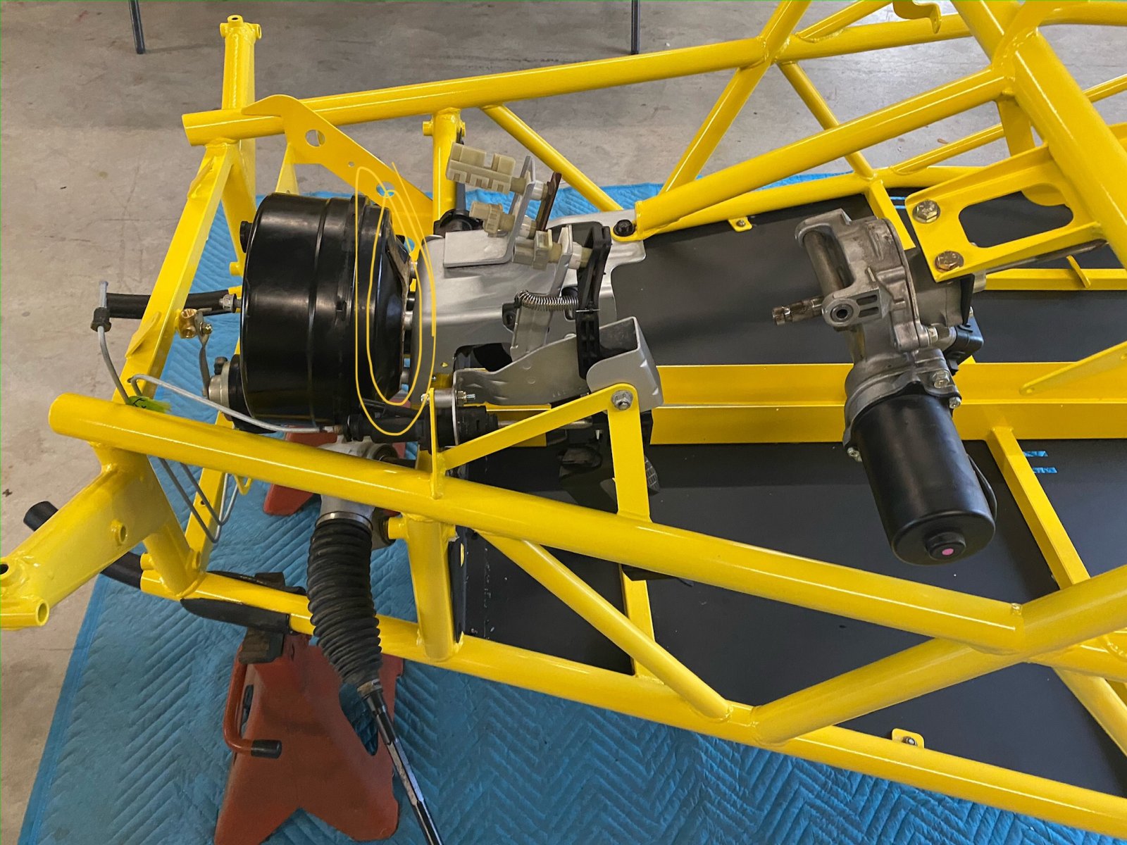

A Adam in CLE Well-Known Member A Adam in CLE Well-Known Member Jan 17, 2022 #1 Am in need of both brake booster gaskets for 09 ss/tc. can't seem to find them. Any ideas?
Rttoys Smokin' Goblin Rttoys Smokin' Goblin Jan 17, 2022 #2 what? master cyl to booster and booster to bulkhead?
A Adam in CLE Well-Known Member A Adam in CLE Well-Known Member Jan 17, 2022 #3 Master to spacer spacer to bulkhead
Rttoys Smokin' Goblin Rttoys Smokin' Goblin Jan 17, 2022 #4 This? It’s not needed. I’m surprised I left it there
Lonny Administrator Staff member Lonny Administrator Jan 18, 2022 #5 If your donor came with the aluminum spacer you need to reuse it. There are two different styles of boosters. One style requires the spacer. If you are just referring to the foam pad you do not need it.
A Adam in CLE Well-Known Member A Adam in CLE Well-Known Member Jan 18, 2022 #6 Thank you both! I have the aluminum spacer. I wasn't sure about the foam spacer. As always, appreciate the support.
Robinjo Goblin Guru Robinjo Goblin Guru Jan 22, 2022 #7 Do we need to scrape the foam gasket off the booster?
A Adam in CLE Well-Known Member A Adam in CLE Well-Known Member Jan 22, 2022 #8 I blasted and painted mine so I did scrape it off.
