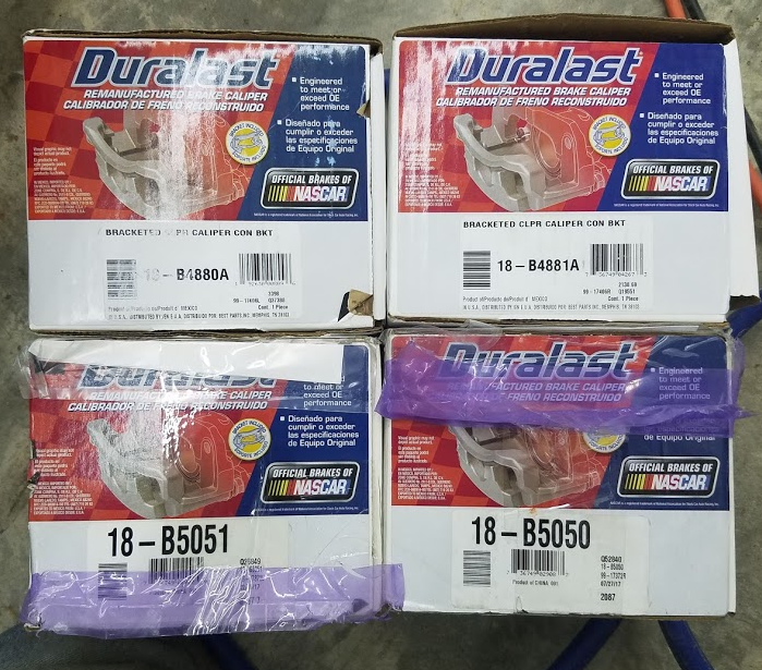

I received new Brake Calipers from DF. I read that the front is off of an 09 base cobalt & the rear are off of an 09 solstice. Anyone have the actual part numbers for the Calipers? Thanks

Rears are only from a solstice if you got the parking brake kit. Otherwise they're all the same.

This is what I have for my SS/TC with parking brake.
  • G956 (Front, 2010 Cobalt 2.2L fronts)
  • DG1095 (Rear, 2010 SS Turbo)
Is there not a number on the calipers? GM is usually good about having a part # on them. Sometime It's just a sticker and if they are remanufactured it might not be there anymore. Don't have mine yet so no real useful info to share.
These are the Solstice parking brakes and the usual front brakes.
18-B4880A, 18-B4881A
18-B5051, 18-B5050
17796
