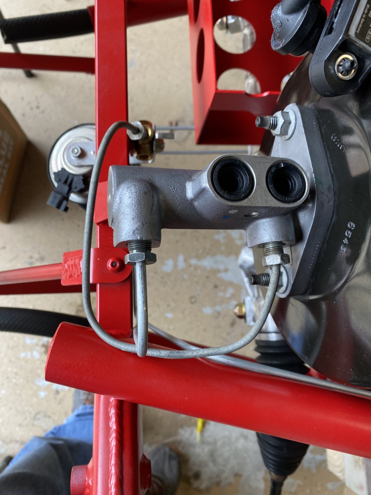

V1 Brake line from front tee to MC
Northshoresaint
Active Member
N
Is this brake line supposed to be included in the kit? I recovered what looks like the correct line from the donor, but the brake line fitting is too small for the MC.
09 SSTC
Mine came with the kit (SS/TC).
There seem to be multiple sizes fittings depending on which cobalt it came from. I picked up a cheap new MC for a standard Cobalt from Rockauto to use, and the fitting size was different for either the front or rear line.
