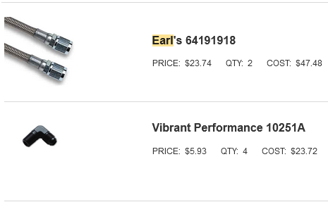

What are my options for brake line?

When it comes to stopping my wife would want me to do what I can to insure that I "Make it Happen" so was able to find the above parts from Summit Racing.

‘Thanks for offer, I ended up purchasing some braided line.
Braided brake line? Standard braided line is the same as non-braided line for fuel, etc. if it is not specifically for brake fluid. It will sweat brake fluid too over time and be harder to see because of the braiding. :oops:

If I'm following correctly, he's emulated my setup, which means he'll be fine. This is the product in question.
