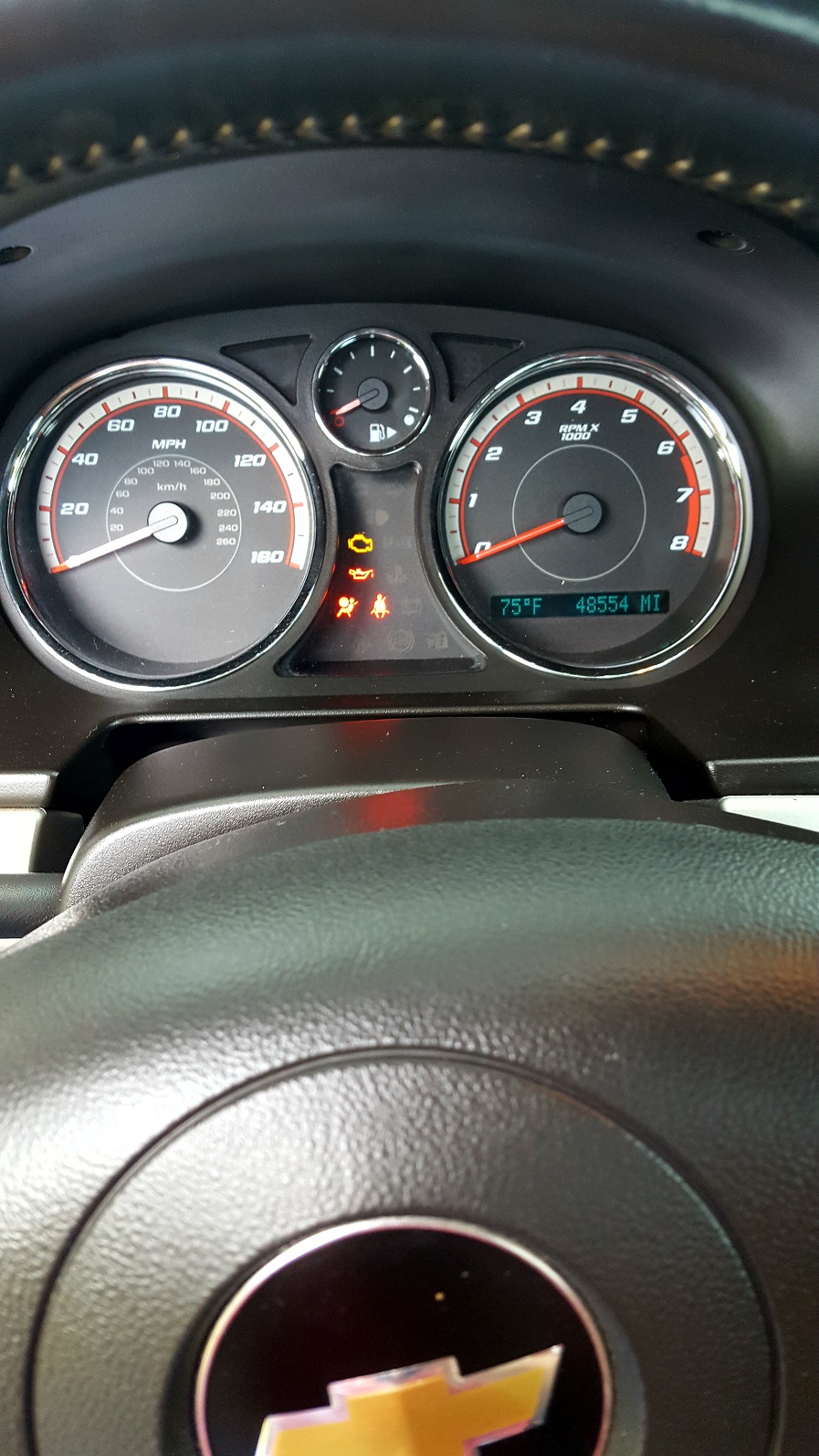

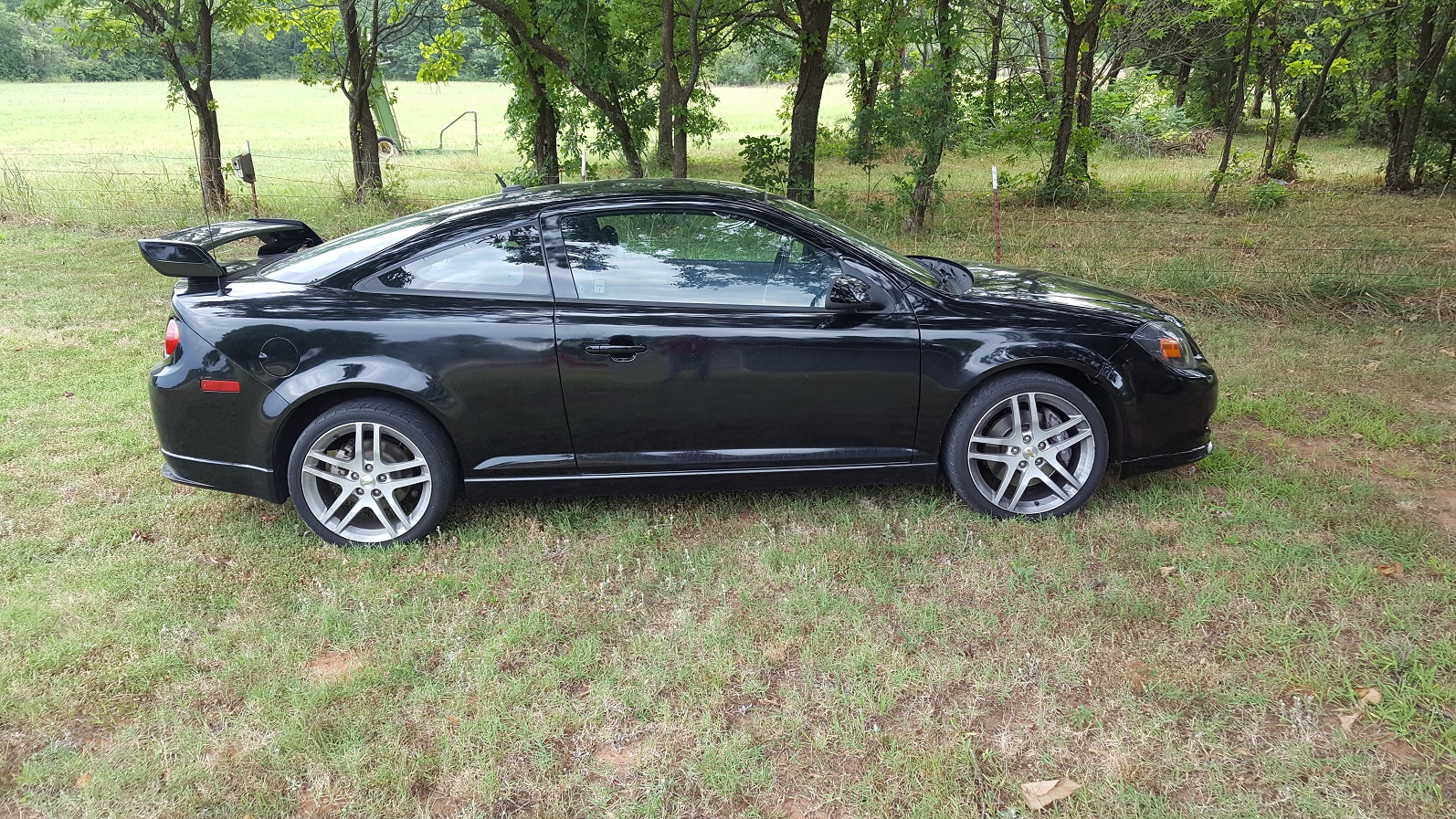

I started the project back in July when the grass was still green. Here's the donor before it went under the wrench.
It was involved in a front end collision. You can see the slightly crumpled cross member behind the hood latch.
I put about 700 miles on it before I started disassembly. 75 degrees in the middle of July in OK. Not bad. The average temp usually hovers around 350 degrees with 200% humidity.

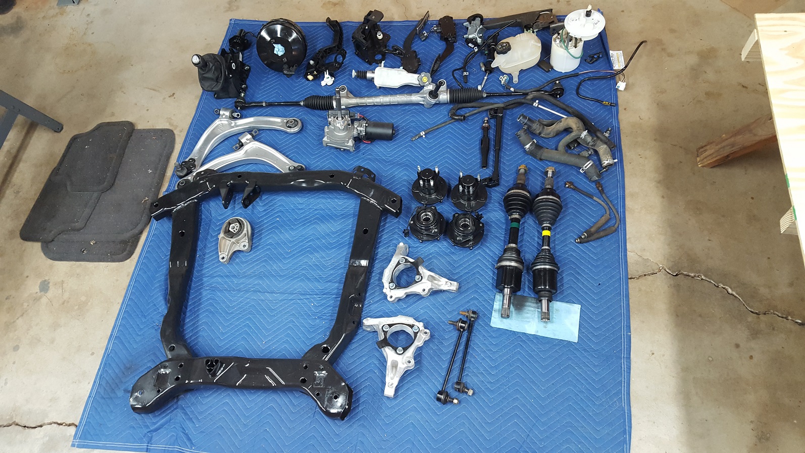

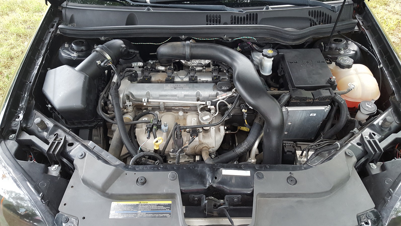

Here are the parts cleaned up and ready to go for the most part. I don't have the engine in a good area to get a picture of it. The only thing I did to it was cleaned it up and powder coated the valve cover red. Stock engine = not exciting anyways.

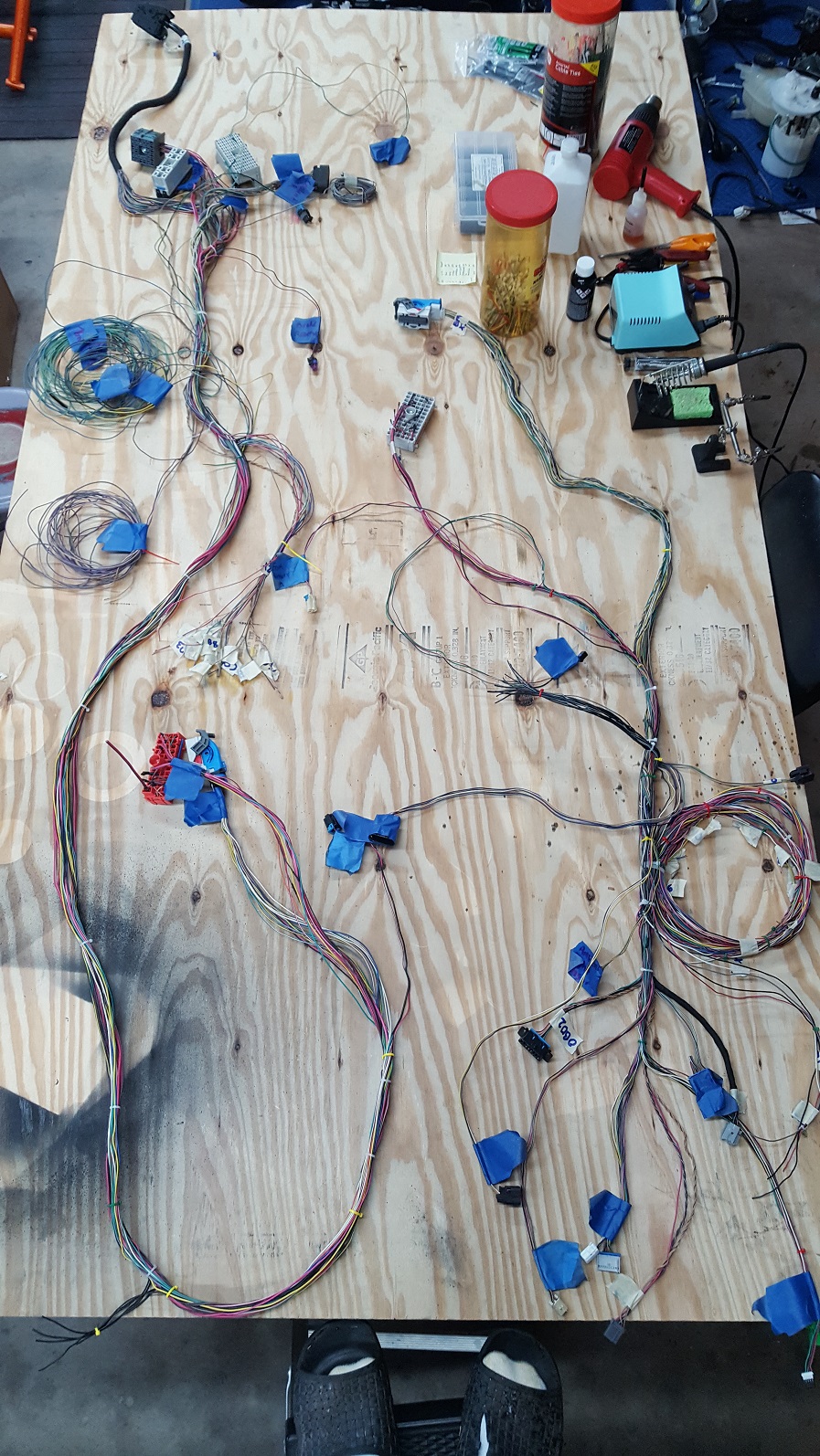

I haven't combined the harnesses yet.

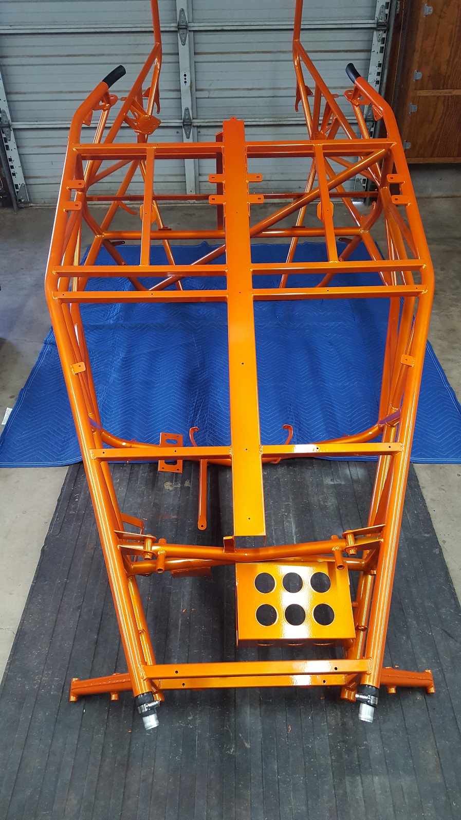

I picked up the Goblin frame this past Saturday. The color is Illusion Orange. The fluorescent lighting actually does a decent job in showing the contrast. Radiator hoses were pulled by Adam/Lonny before I picked it up. Yeah, I'm a cheater. :)

Awesome man, glad to see you making a thread. Frame looks great. I did the same thing on the cleaning up, wanted things to look good but wasn't interested in going overboard.

I'm not sure how many hours I have at this point. Of the entire disassembly and prep, I do have the most hours in the wiring harness though. Still a long ways to go with it.

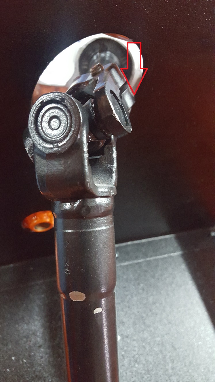

Ran into a problem. Of all the Goblin builds, I think I am the first to have this problem which is how my luck goes. Anyways, the steering intermediate shaft interferes on the passengers side of the bulk head cut out. I can't turn it a full 360 degrees before it hits. It's hard to tell from the picture, but this is the area having issues.
It seems as if the rack shaft doesn't sit centered in the cut out, or it doesn't protrude far enough through the cut out to clear the area where the bolt goes through.

That happened to me. 5 minutes with a half round file and good to go.
