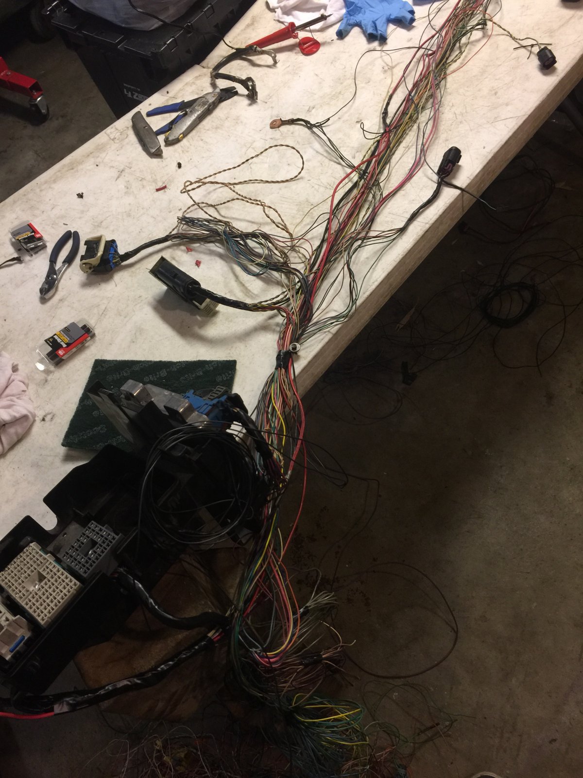

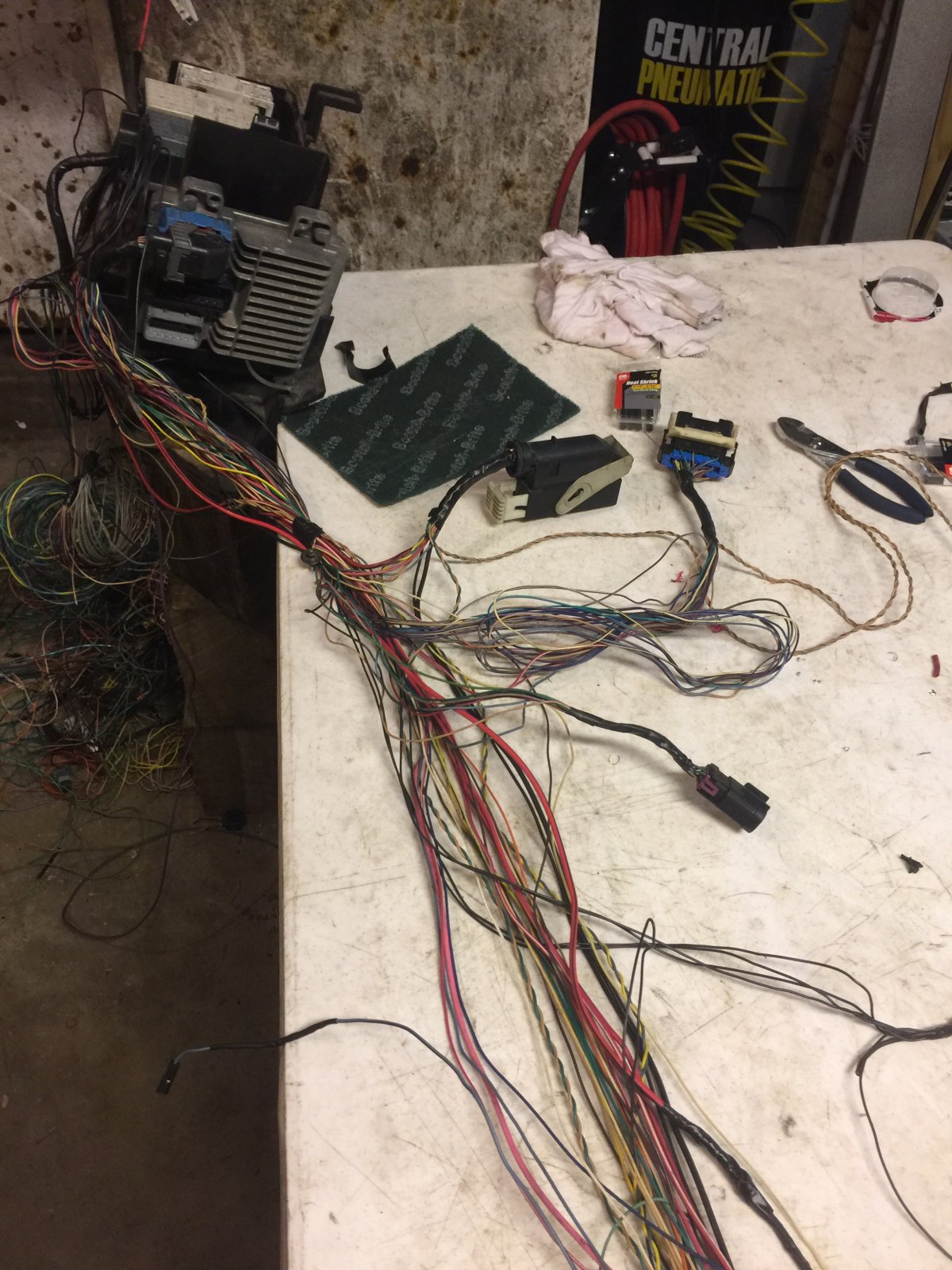

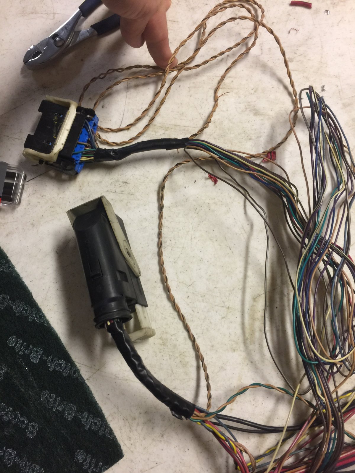

5:16 of the video I don't seem to have this plug harness is from an 06 cobalt ss. I see the twisted wire but I don't have that purple and black conector I only have these 3 not sure what to do need help

Adam

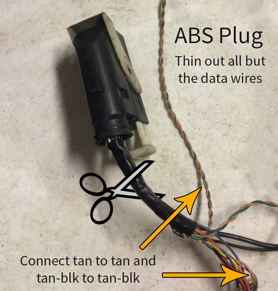

The giant black connector is for the anti-lock brake system. ABS isn't something that is easily reused in the Goblin because we move the rear sensors to the front and vice versa. We also run staggered tire sizes front and rear which will confuse the computer even more.
So all you need to do here is find the twisted tan & tan-blk wires going into the plug and the twisted tan & tan-blk coming out and solder them together to complete the circuit. Then you can thin out the rest of the ABS wires.

TheNuker
The only big plug that I have that matches that data wire and a couple others has red colored plastic on the locking part.
Nuker-
The turbo ABS is black and white and the supercharger ABS is black and red.
You can cut that plug out along with its wires except for the tan tan/blk twisted data wires that go into and back out of it.
The data wires need to be able to continue on as if the ABS plug was never there. Hook tan to tan and tan/blk to tan/blk.

TheNuker
At 5 minutes into the part 12 video, There is a wrapped up data wire that is connected to the "engine connector" I don't see that purple plug anywhere. Nor have we cut anything like that out. We have not cut any data wires yet.
Nuker-
PS sorry for being a pain in the ass.

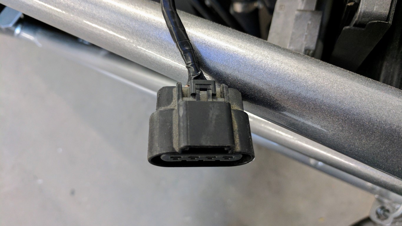

Can anyone confirm these 3 plugs, And to remove or not and if not what do they go to?
Thanks!
Nuker-
The four pin on the left is a sub woofer.
The two pin in the middle is for the trunk light.
The blue two pin is for a rear speaker.

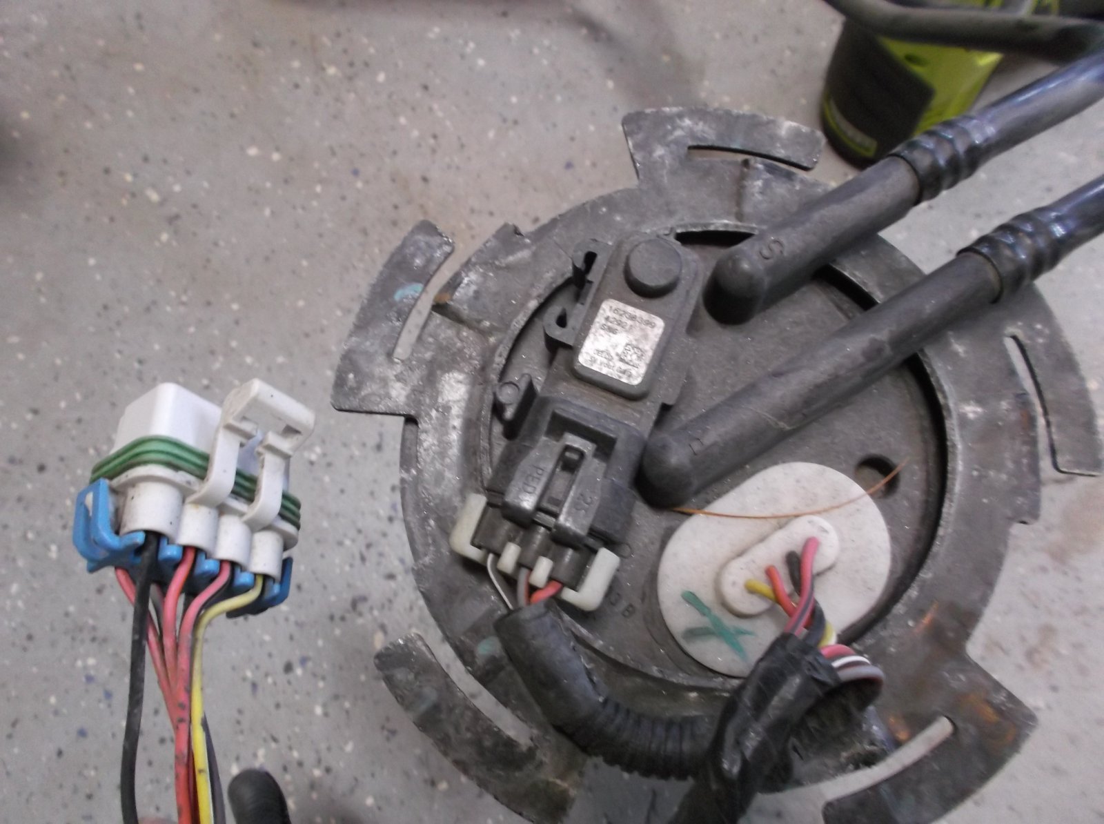

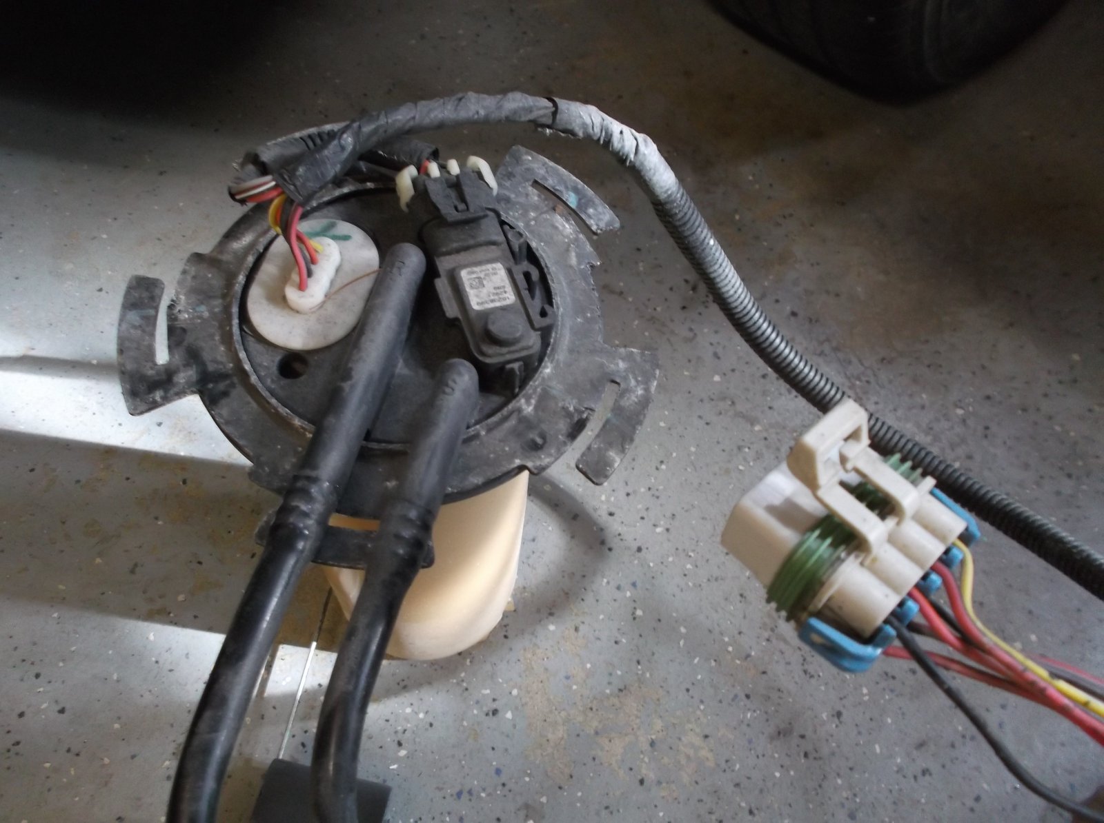

OK, which wires do I splice to the 4 wires coming from the harness?
This fuel pump is from my running 05 donor and it is the same as the one from the junkyard; both did not have the Nu6 code.
Adam
We have not encountered a pump that looks like that. I did some research last night and learned that the 2005 Cobalts used that pump.
The pumps we've used have a 4 pin connector built into the top and no wires. Yours also has what appears to be a pressure sensor on the top.
We aren't sure if the 05 pump will work with your 07 donor equipment. If you hook up the pump without the sensor, I'm not sure what the pump will do. In the 05, the computer might use the info from that sensor to regulate the pump. On the other hand, that sensor may only report pressure changes to the computer for fuel trim adjustments and the pump regulates itself like the later model pumps. The pump could also output a different pressure than the 07 PZEV or the other non-NU6 pumps.
I think you need to get a later model non-NU6 pump that has no wires coming out of it. You'll also want to get the plug and a short length of the pigtail that goes to the pump to solder to the wires coming from your car.

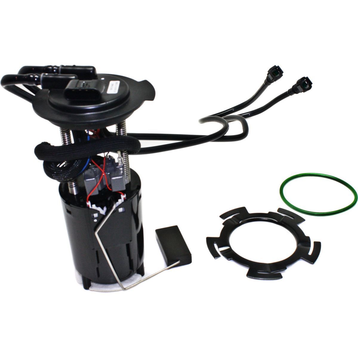

RichN
OK, now I have 3 useless fuel pumps; getting a little disappointed :(
Will these work?
I searched eBay for 08 Cobalt 2.2L
pump $66 harness $31
That's only a few dollars more than I paid for the used one at the junk yard.
I've purchased car parts from both of these sellers in the past with no problems.
If the harness will work; can you post the wire color to the pin?

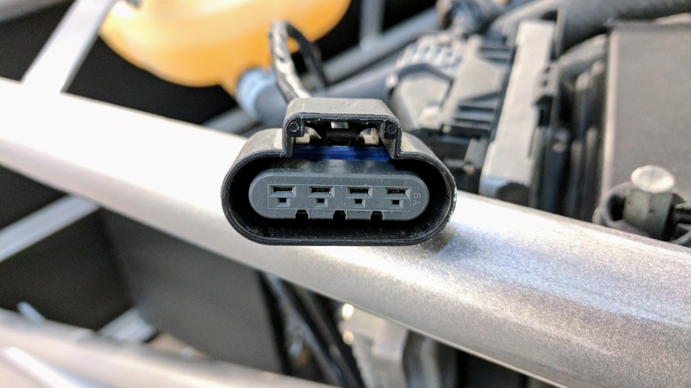

Adam
The pump looks correct but the connector doesn't. Here's what the original connector looked like (there is normally a gray plastic lock on the outside):

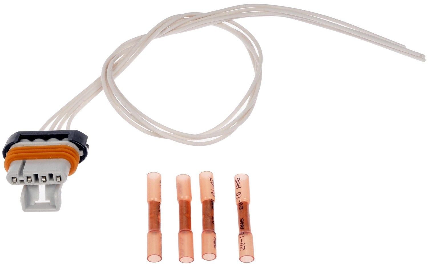

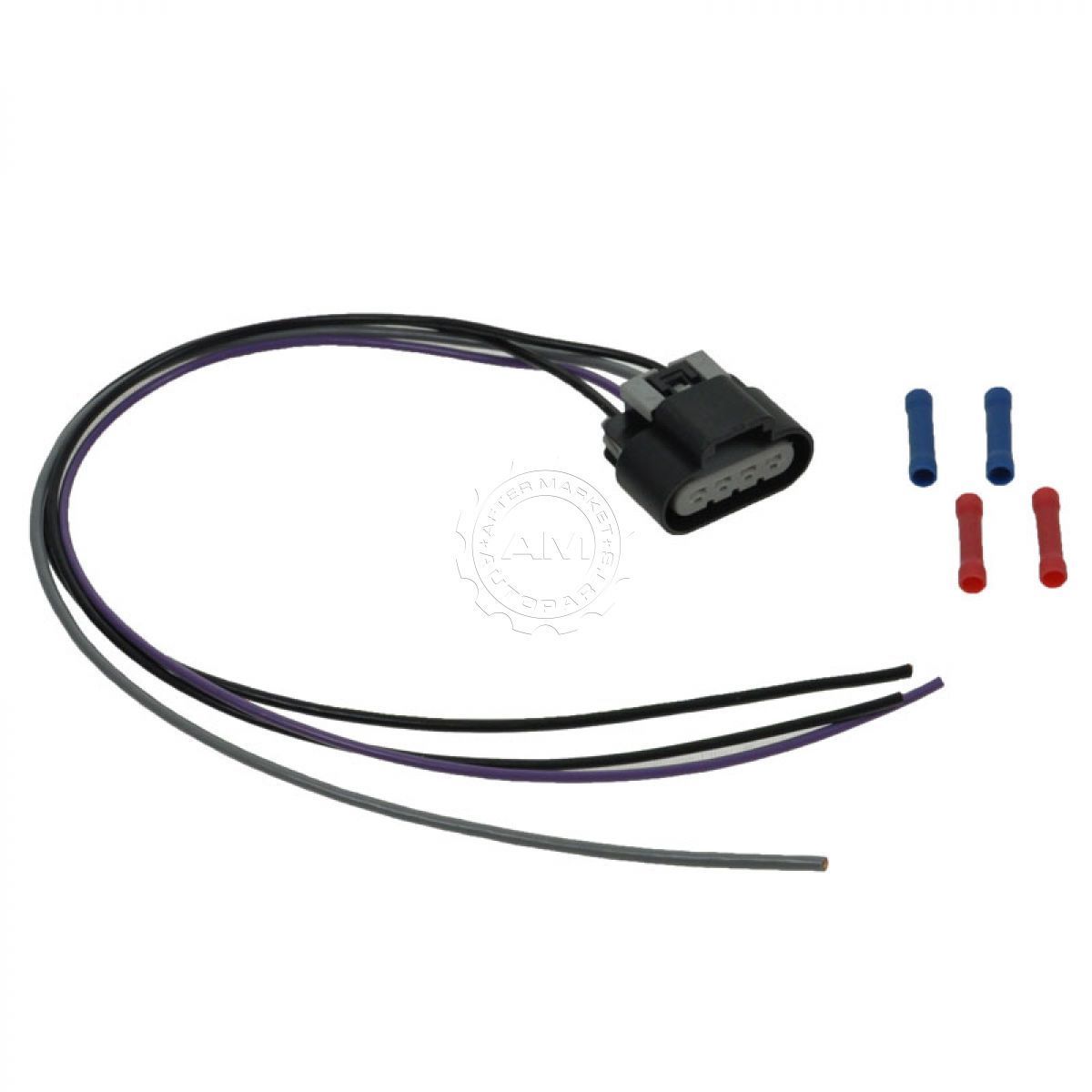

Looks like this one will work and it costs much less:
http://www.ebay.com/itm/Fuel-Pump-W...-Wire-Pigtail-for-GM-Car-Pickup-/310923633446
The black wire next to purple will need to go to the tan wire in your main harness. Purple to purple. Gray to large gray. The black next to gray will go to ground.

RichN
Hi Adam,
Thank you for finding the connector at a big savings.
Ordered both; they should be here by Tuesday.
ncgoblin
I have the same pump that came with my 05 donor Cobalt SC. Do I need to go ahead and purchase the same pump and pig tail as Rich?
Thanks
-Logan
SliderR1
You don't have to. I used the pump off of my 05 SS/SC. I just installed a generic connector between the harness and pump.
