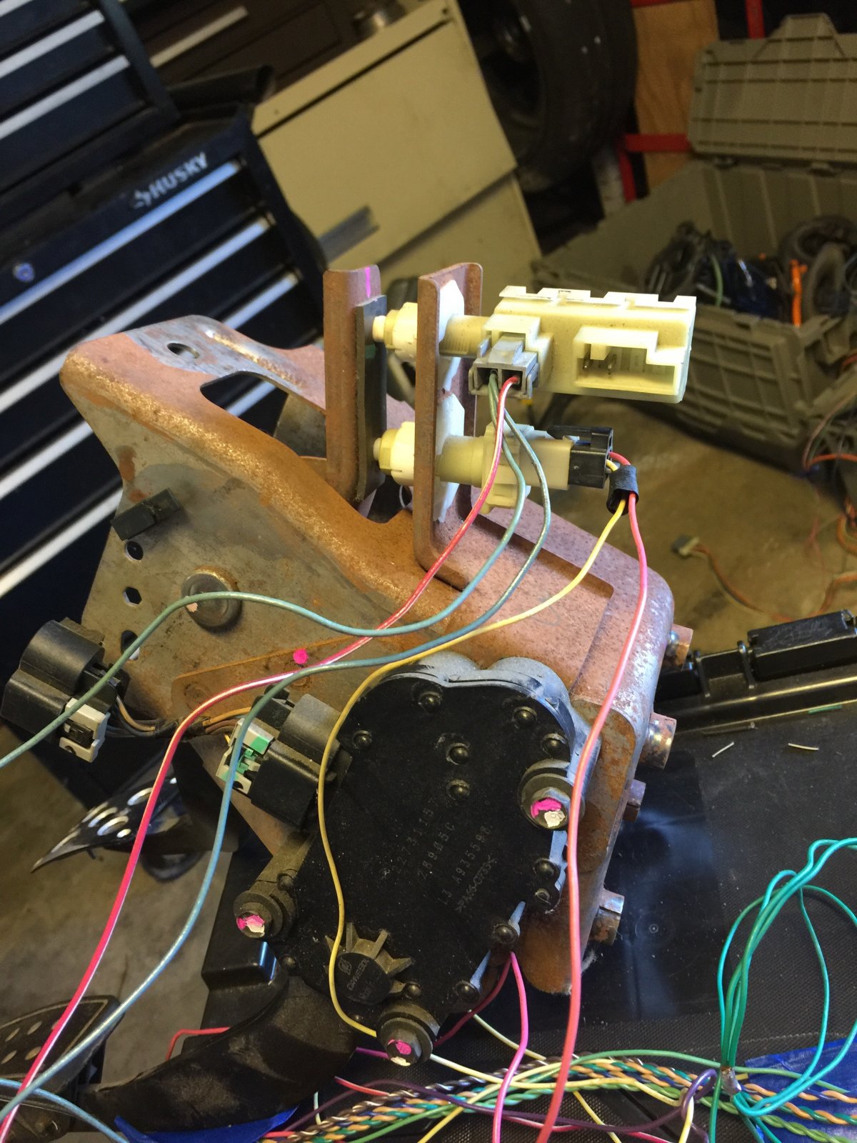

canyon bolieu
At 10:00 tape the brake pedal and gas pedal. I have 3 brake pedal plugs I found 2 not sure what the 3rd even looks like

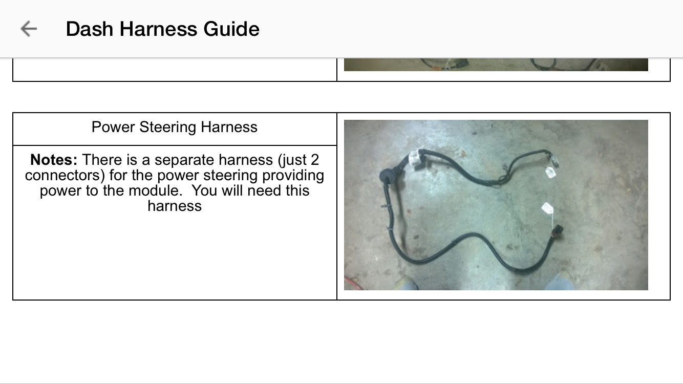

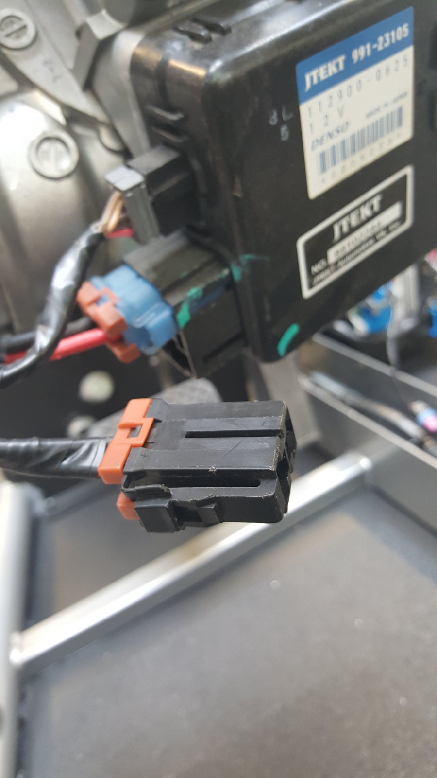

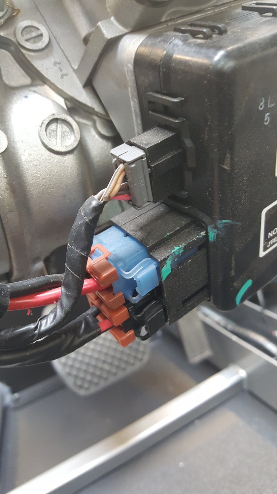

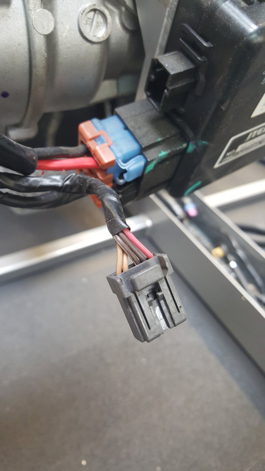

Hey guys,
Can you clarify the power steering wiring. I am not able to find any plug in the harness that connects to the plug on the power steering pump. I checked every connector that I removed and was not able to find the same plug.
Thanks,
Nuker-

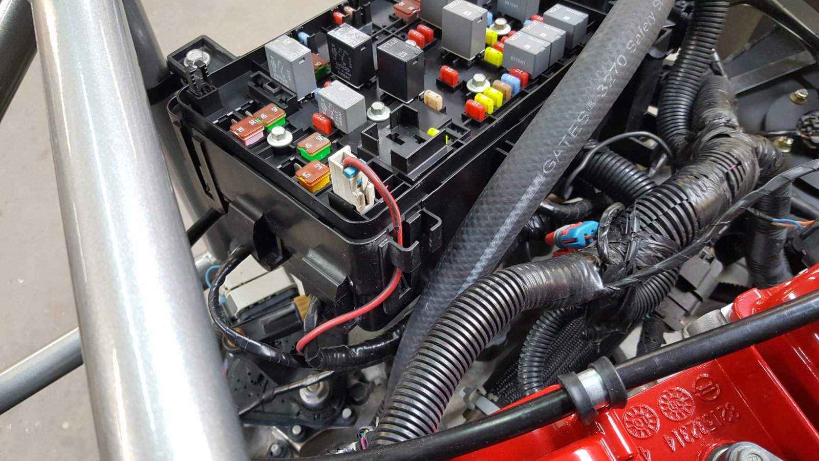

The power steering motor wire plugs into the fuse panel by engine.
Or it can be connected directly to the battery. Install 60 amp fuse inline. Is that what you mean?

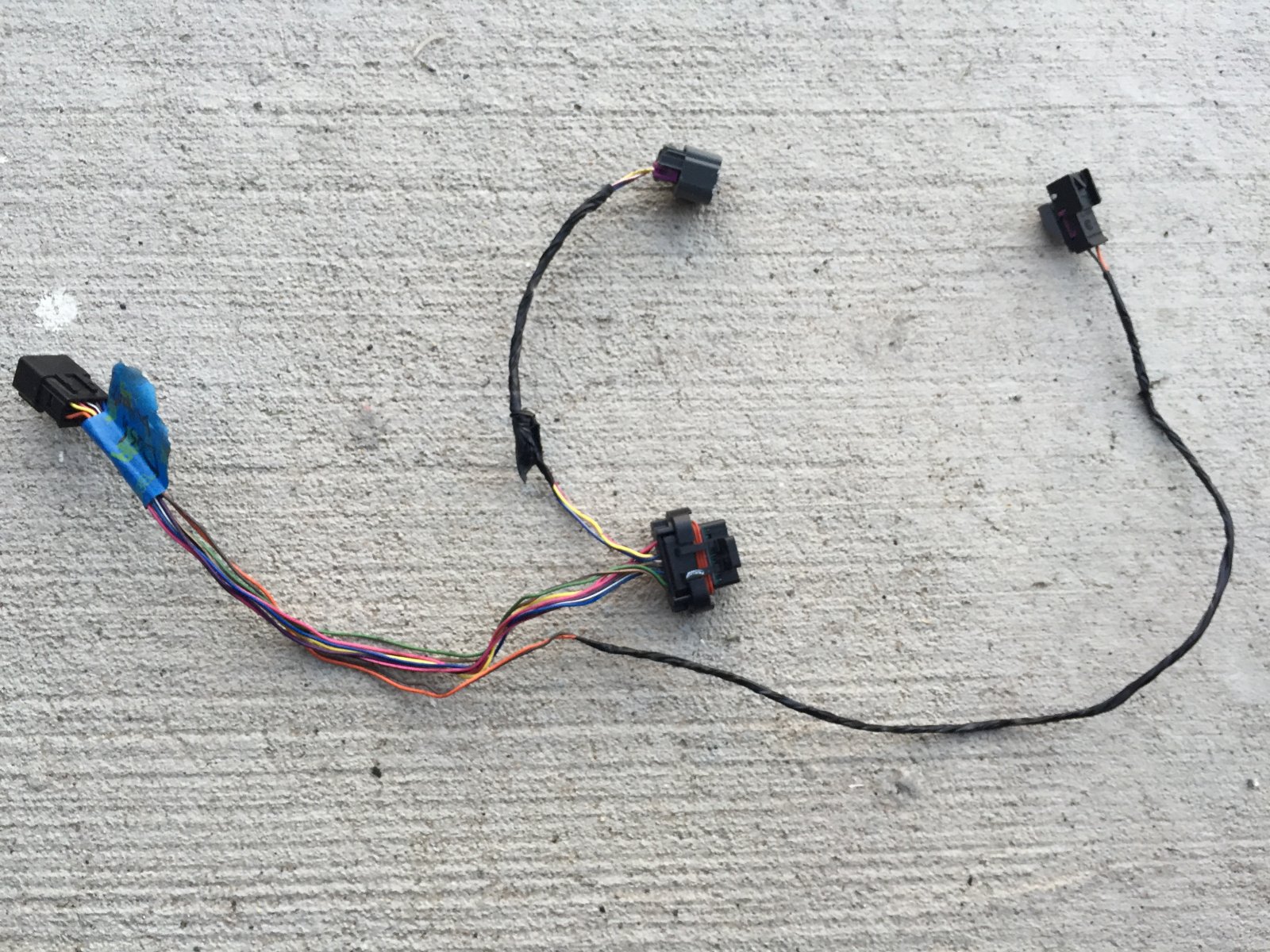

Lonny, can you clarify how the info and return button replacements are wired? I have the connector pictured plugged into the steering wheel rotating connector, and the info button plugged into that. My info button and that flat connector both only have four wires and it appears they can be connected directly together.
If you are using the original buttons you can connect matching color to color and it should work.
If you use your own buttons you will need a couple of resistors.
Thanks JSATX, Do you have a pic of the other side plugging into the motor itself?
Thanks!
Nuker-
The large black power plug that plugs into the lowest position on the power steering unit is from a separate small wiring harness that we combine with the reworked harness.
Video 12 @ 1:46

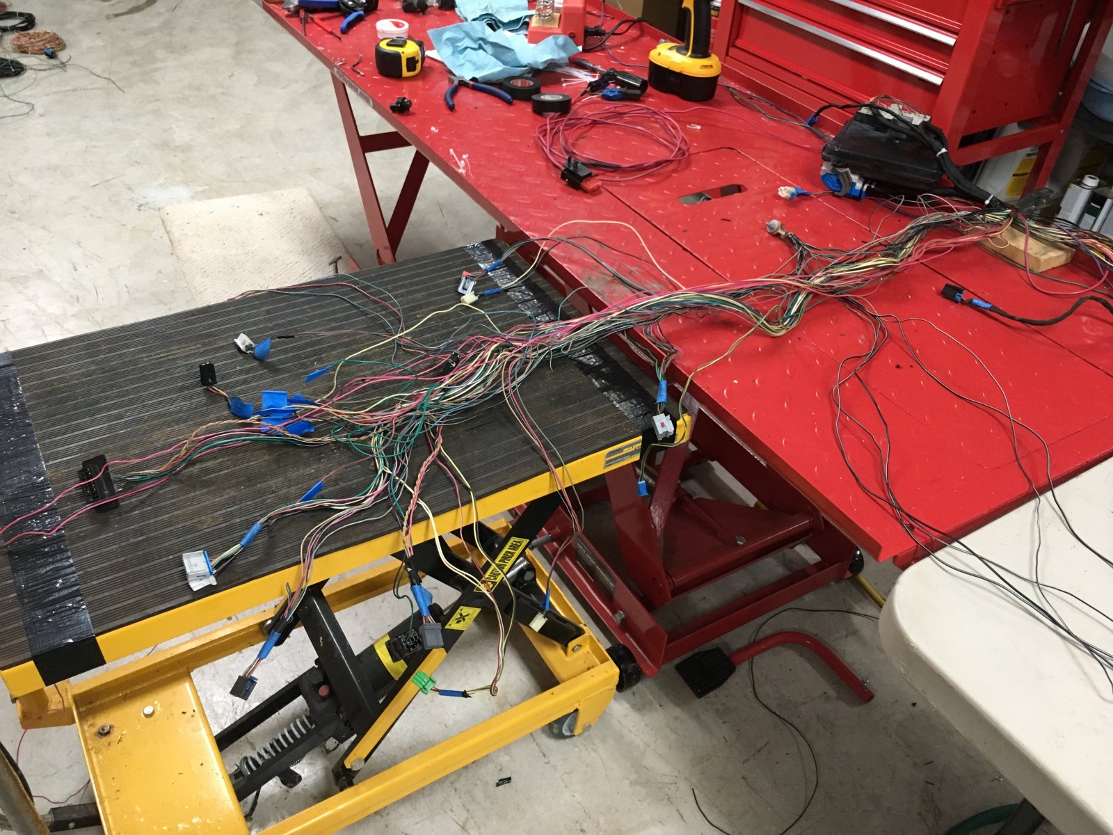

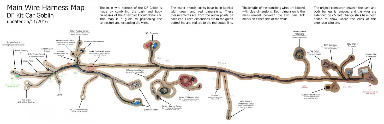

My goal is to use the main harness map to mock up the combined harness as close as I can with wire ties, test fit, and then wrap. I've got a few questions though.
1. The blue measurements on the right side of the map are hard to read. What are those numbers?
2. The pedal box grounds look pretty short on the picture--1"--compared to the videos--~6". What length works best?
3. For the SS builds, does the boost gauge need to branch out somewhere around the instrument cluster wires?
4. For the extended frames, do the extension wires need to be a few inches longer between the orange stars?

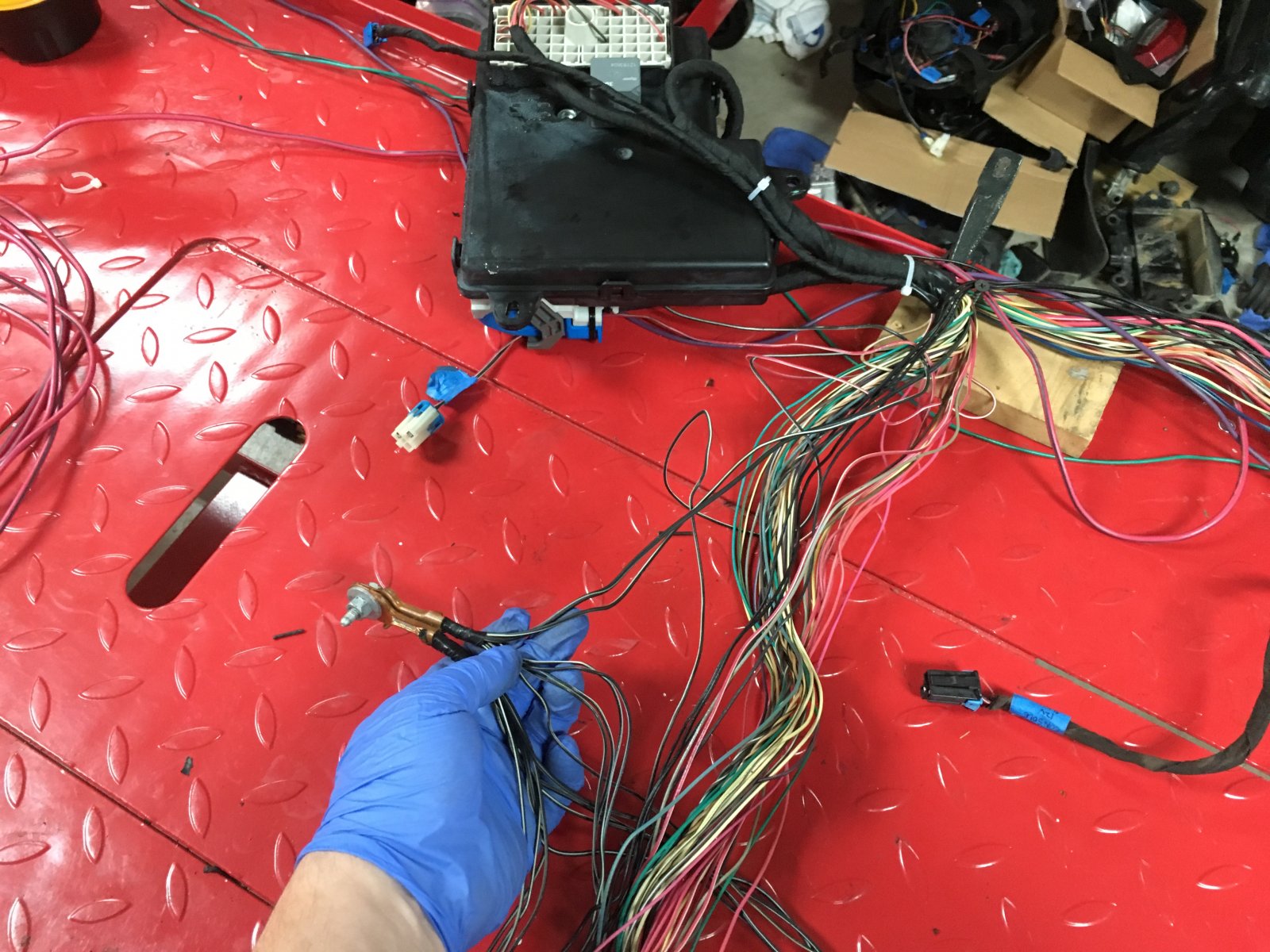

SliderR1
Brian - did you get an answer to #2 and #3 above? I'm working on this video now and have the same questions... My dash harness grounds are also much closer to the BCM and there are two ground wires that go back to the BCM. If I have to move the grounds further towards the ignition switch end of the harness I'm going to have to extend those two grounds... see below for clarification picture
SliderR1
One of the ground wires was for the 12V accessory plug, so that one is taken care of now. I relocated it to one of the dash ground connectors. I think the other is possibly a ground for the BCM - I think it comes off the large white connector on the back of the BCM, but haven't confirmed for sure yet.
Also worth noting - On the '05 SS/SC, the red w/ white stripe wire from the dash harness plug goes to the 12V accessory outlet AND the OBD2 plug - so you'll need to add an extension to the OBD2 plug red wire back to the dash harness connection point.
