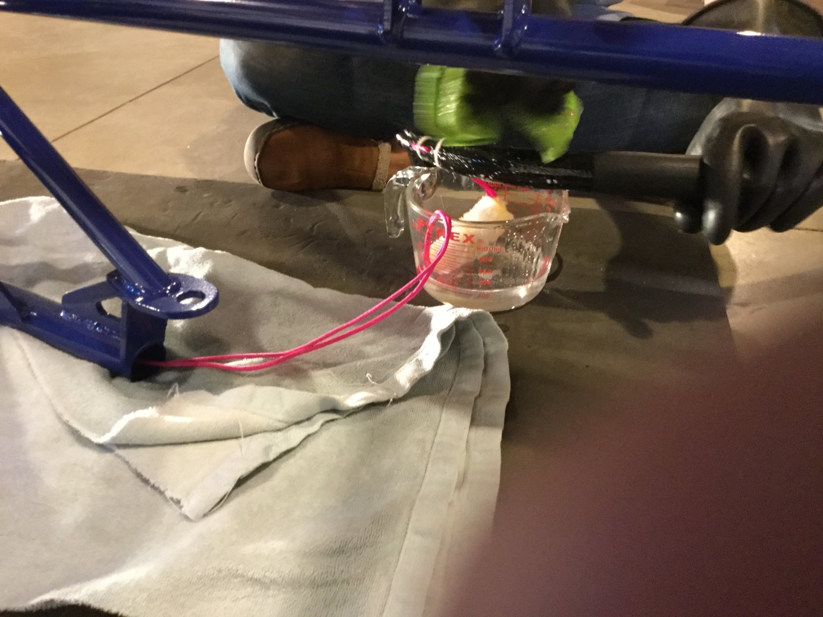

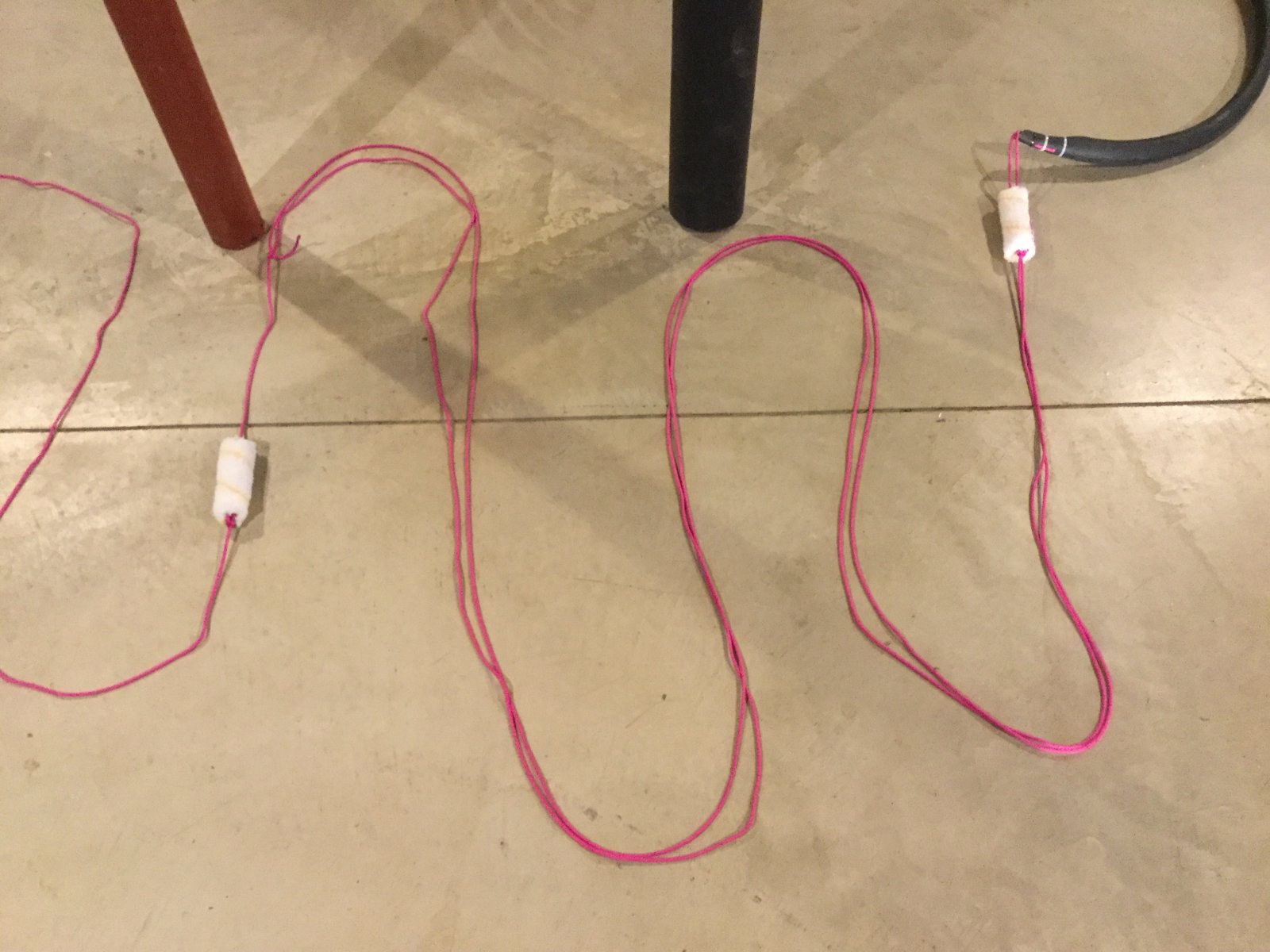

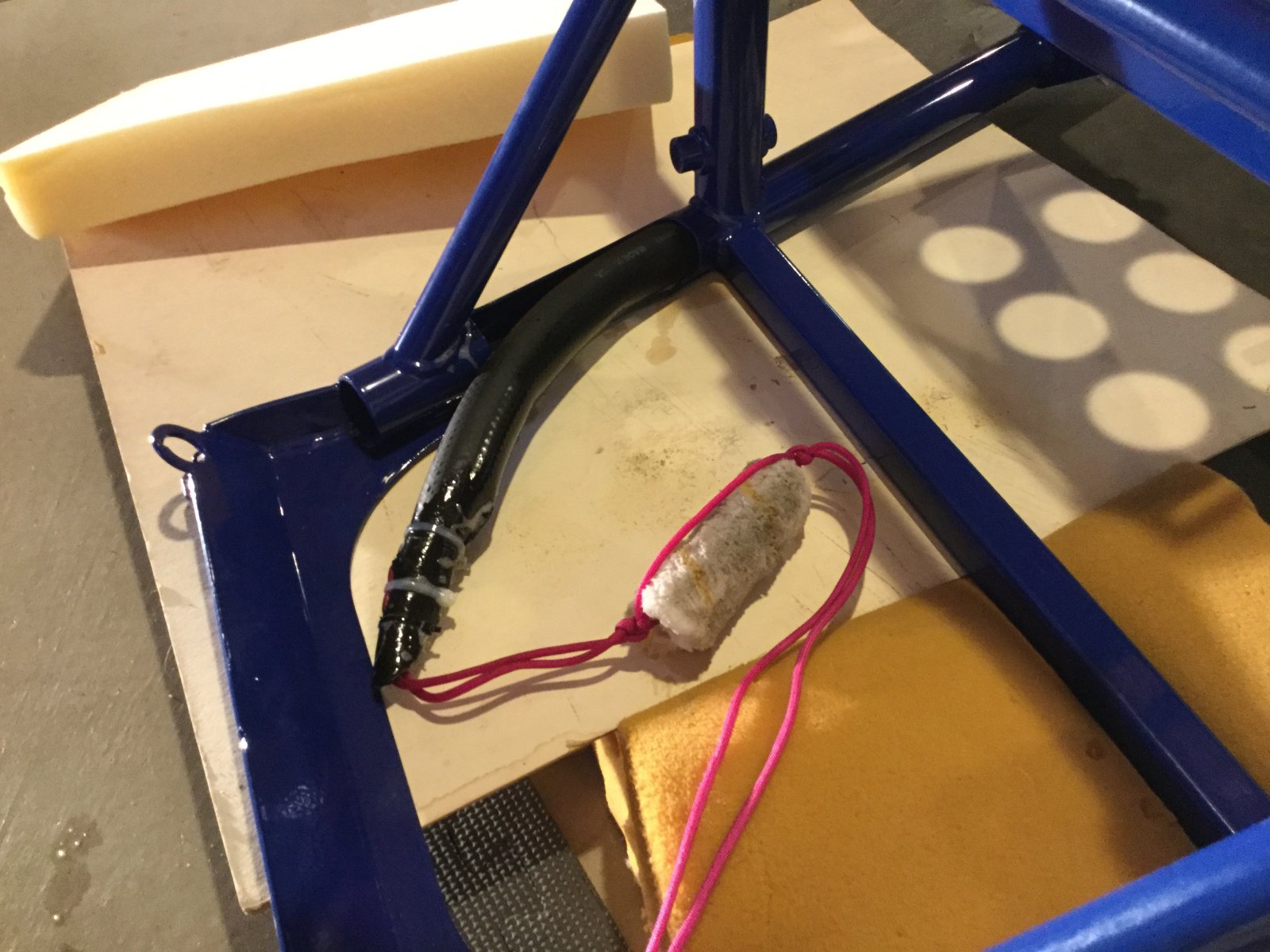

Trying to up load some pictures but unable to at this time. Pulling the radiator hoses through should not be that big of an issue. (The only thing that could be an issue is different manufacturers of the hose could have a higher OD. I seem to remember Adam or Lonny mentioning that). We have done two frames the first we heated the hose up ran tire slick through the tubes added two small paint rollers onto the pull line soaking them and the hose as we pulled it through the tube. I don't want to say it was easy (a little messy) but not as hard you are making it out to be. The second Nate did with some of his friends when I was out of town. They could not find the tire slick in the garage (they were working at about midnight) so they shot the tube and the hose with WD40 and pulled it through and that was with only slicing the hose to make a vee and holes in the hose to wrap the cord through. *only injury Nate had his feet on tube pulling (in socks!) WD40 on tube. Needless to say feet off tube upper arm into tube very nice bruise.... but final result radiator hose in tube lesson on proper footwear priceless.... (Adam was supplying hose collars never got one but they would help with not tearing the pull cord out of the hose.

Would suggest getting the ring/collar from Adam. Then take the radiator hose and leave it in the sun on some nice black asphalt on a nice sunny day. The tire slick works just fine plus it's cheap run some down the tube. I used two of the small paint rollers one at the beginning of the pull line and one just before the radiator hose totally load both with the tire slick as you pull the first one into the tube pore more tire slick into the tube that will keep the tube well lubed. Begin to pull the second paint roller into the tube again saturated with tire slick we also had a basin filled with tire slick so that one person was feeding the radiator hose through the tire slick in the basin and keeping it going straight into the tube. Only catch pull only the length of radiator hose that you need per side and once you start pulling you CAN NOT STOP it doesn't have to be fast but it did need to be one continuous motion.
If I can get pictures up I will later. It really wasn't bad I think with the radiator hose warm/hot it will stretch down to a reasonable size to fit through the tube.

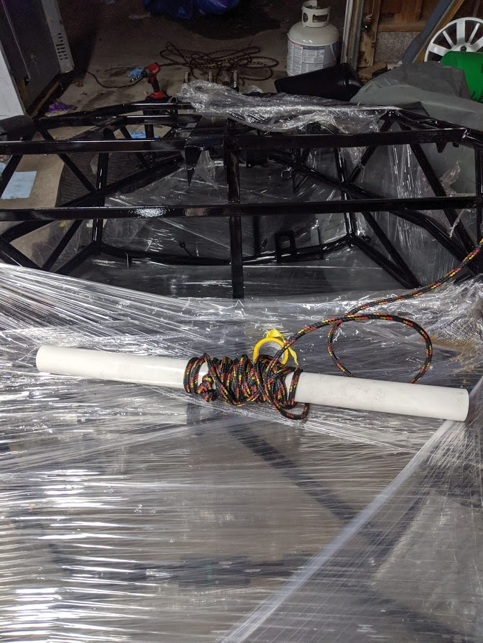

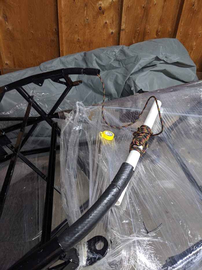

I found a much easier way of pulling the rope through (after ripping a little skin off my hands). I used two separate ropes (not trimmer line) to do mine. One rope was about 20 feet long with the paint roller in the middle. The other was about 12 feet long with a 1.5" PVC pipe on the other end. The PVC pipe was just one of those short pre-cut sections you can get at Home Depot. I drilled a hole straight through it, put the rope through it, and knotted both sides. On the other end I put the slug. From there I did it kind of backwards. I ran the paint roller back and forth and on the last swipe I pulled it straight through, with the free end of the PVC attached rope taped to the end. I already had the pipe prepared on the other end. I had 3 hose clamps in a line. After the slug made it through the end, I slipped it in the tube. Then I tightened all 3 hose clamps. After they were all clamped down, I removed the center one, and zip tied it tight. I then removed the remaining two hose clamps, lubed up the tube, and put it in the frame. Then all I had to do was go to the other end and use my PVC handle to yank it through. I used the frame as a brace for my foot for extra leverage. The PVC worked great because all I had to do was yank, roll up the excess rope, and repeat. Hope this helps someone planning to do theirs!
