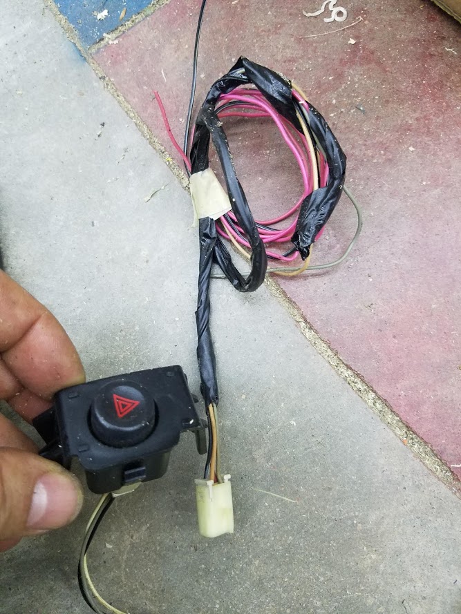

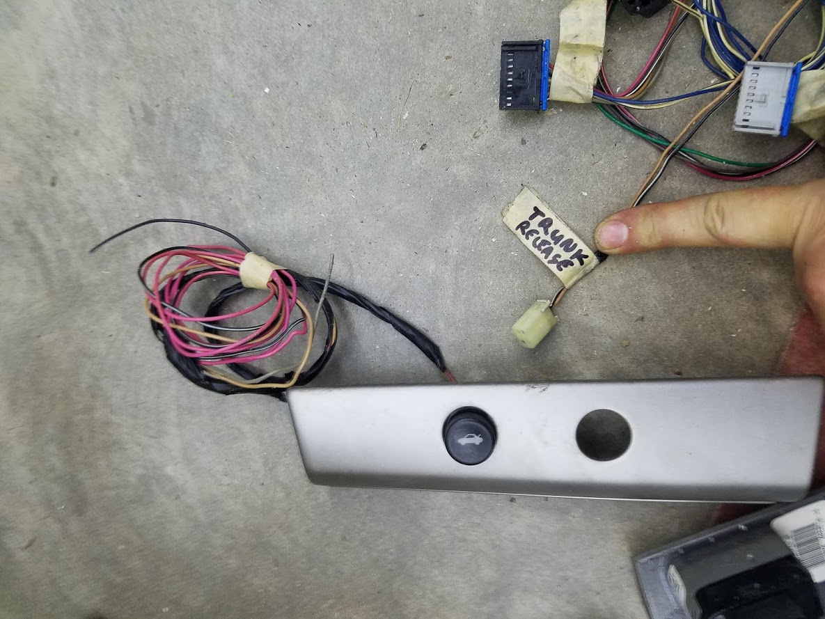

@5:21 Lonnie mentions to "use the trunk release button to identify and cut the wires".
So I did... but later I found out that my wiring harness (2006 SS) had 3 connectors that all fit the trunk release button.
I cut out the wrong one. Not sure what it was suppose to be connected to.
Here is the connector that I cut out. Anybody know what it is suppose to connect to?
8740
Here is the connector that I found later, that I labeled "Trunk release"
8741
Here is the 3rd one that fits this connector:
8742

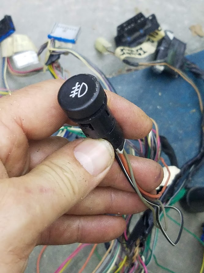

@5:08 Lonnie mentions "Our donor didn't have fog lights or traction control, but if yours did, identify ... and remove them"
So is this the fog light button?
8743

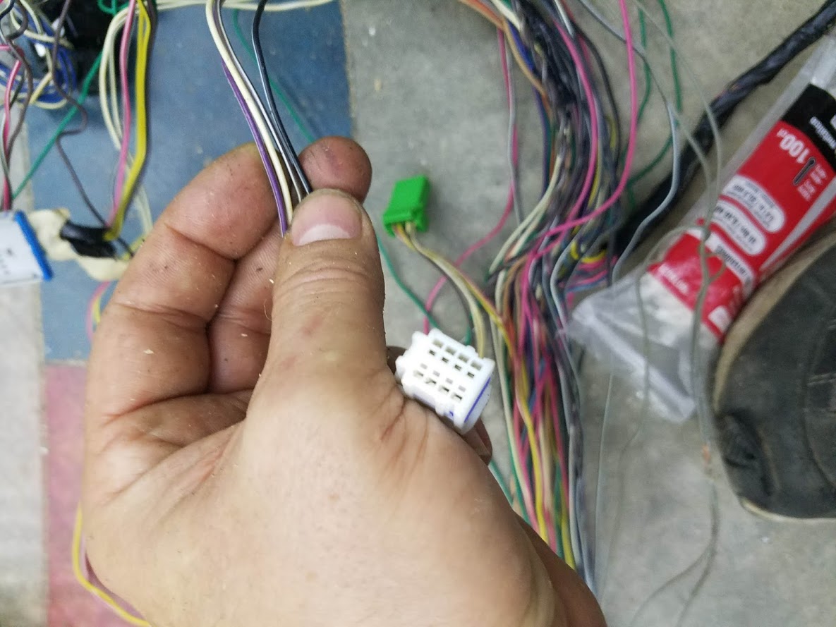

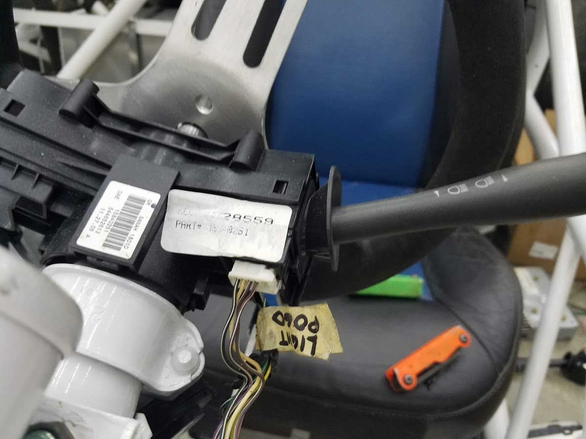

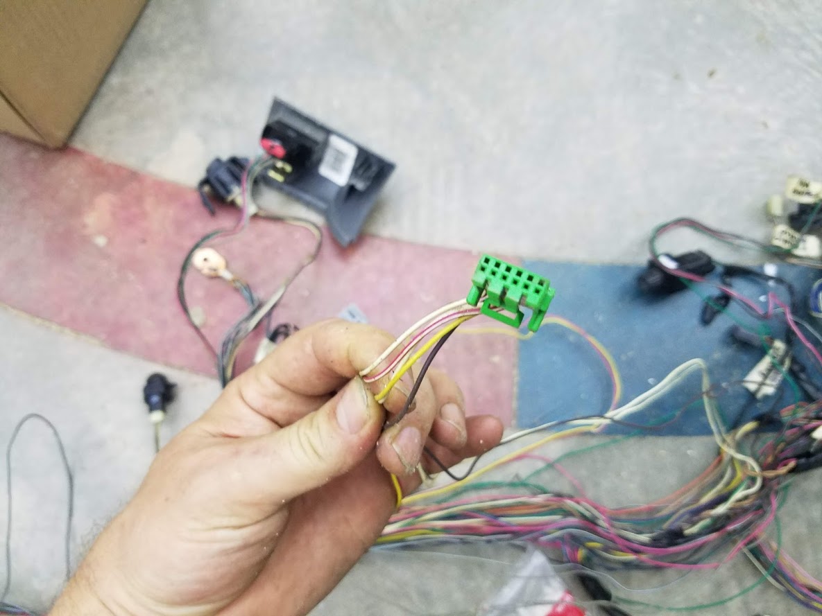

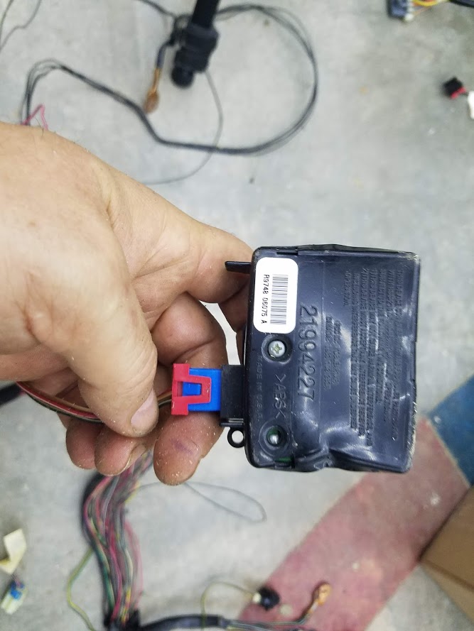

After I finished the video, I had a few extra connectors that I'm not sure what they are.
Like this white one:
8735
and this green one:
8736

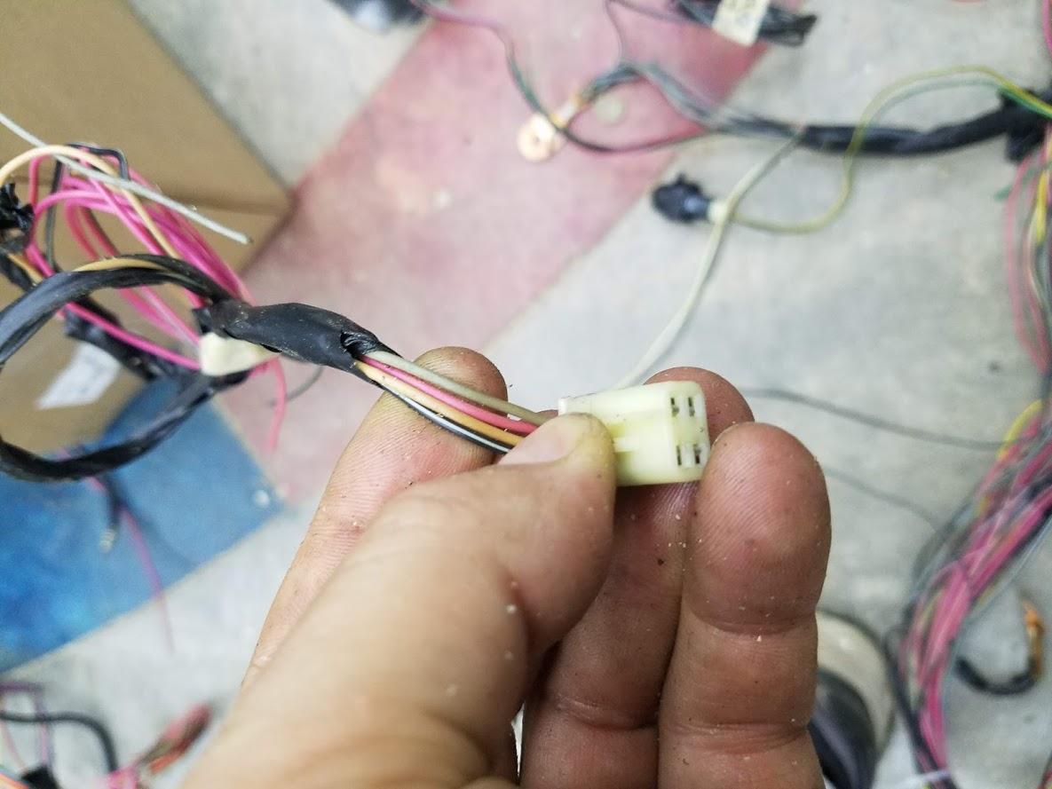

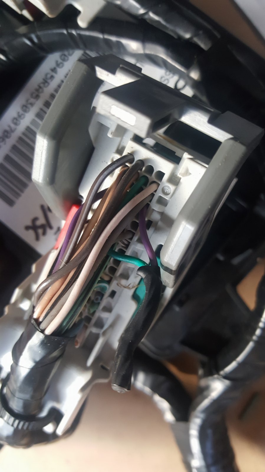

This slightly melted one:
8737

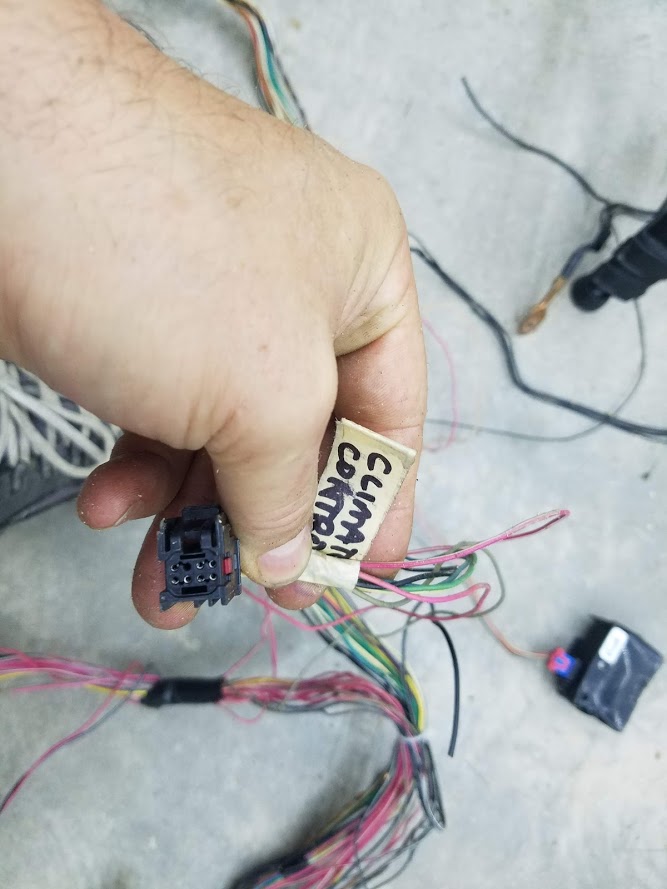

and an extra Climate control one that wasn't mentioned. I guess it can be eliminated.
8738

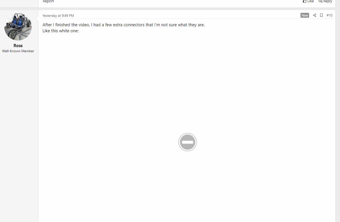

Am I the only one that never sees Ross's photos? I just get a do not enter sign.
Same.
As far as the first question though, the Traction Control, Hazard Lights, and Trunk Release all use the same connector. The only one you need to keep is the Hazard Lights, and the wires for it are black, gray, and white.
Thanks for telling me. I edited my posts, so hopefully you can see the pictures now. I was using Google Photos to store my phone pictures up in the cloud, then using my laptop to post those cloud pictures.... but that only worked for me :(
I just downloaded the pics from the cloud, to my laptop, and used those to edit my post.

Works now!
and this green one:
The white one went to the pogo stick for the lights, the green one went to the ignition switch, I eliminated the climate control one, and the melted box I think is the TPMS (Tire pressure monitoring system), but I'm not sure...
8745

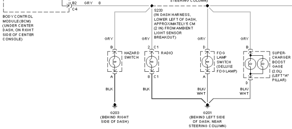

I think this is your boost gauge plug.
Dang, I think you are right. I need to solder that back in, but I am finding my ALLDATAdiy.com membership to be less that helpful.

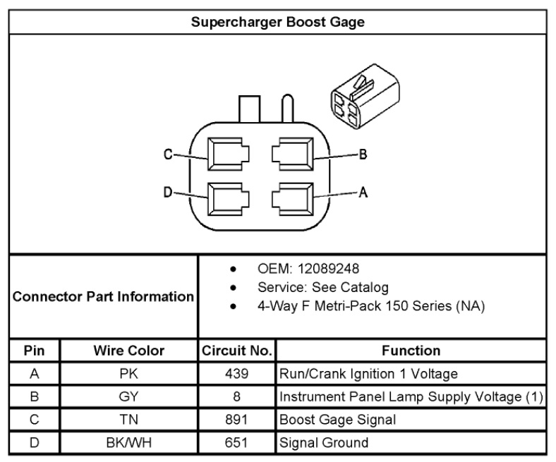

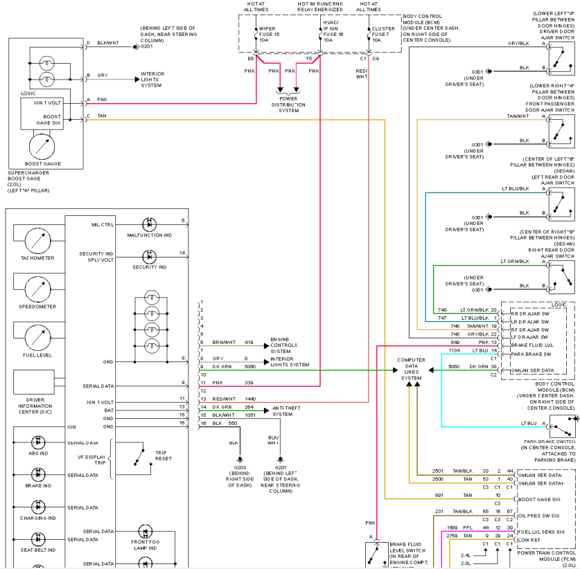

So far I have found the diagram for this connector:
8752
But no way to find the circuits that the wires connect to. Heck, they don't even know how to spell "Gauge".

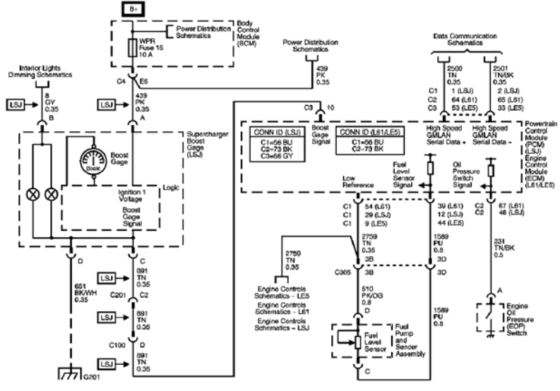

Tony, thanks for trying, but I'm not sure how that helps. Is there some section of that diagram that has one of the wires?
The boost gauge is outlined on the left. The four wires are labeled and you can follow where they go. Here's some more from the wiring diagram.
8754
8755
