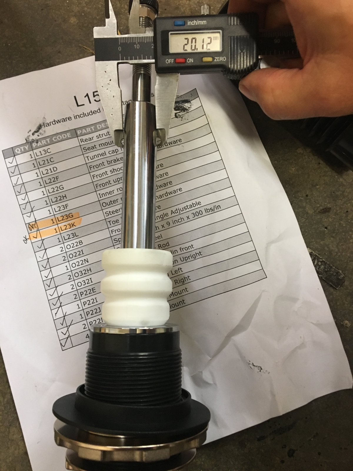

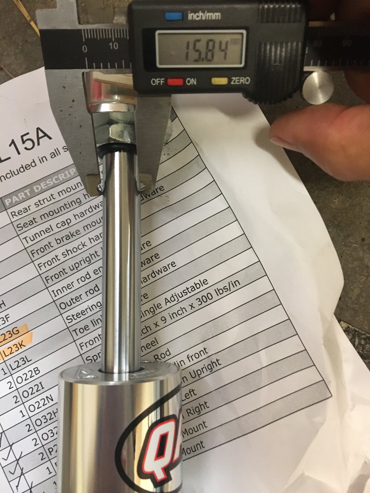

The BC kit that I added from DF did Indeed come with bumpstops just under the boot. The front QA1’s did not but I have a set that will fit.
