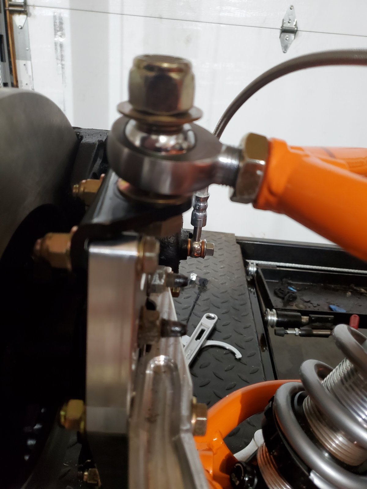

Trying to adjust camber, but don't have enough adjustment in the joints. The best I can do is about -4°. The top joint won't even reach the control arm when I move it out to where it needs to be to be at - 1.5. Anyone else have an issue like this?

take some picture further back... you probably have something not assembled right.
I would like to see the swing arms, springs, & spindle assembly.
Make sure you are zeroing out your gage on the floor before you make your measurements.
don’t forget, the top can come out, but the bottom can also go in. You also have some adjustments at the joints where the control arms mount to the frame.

Don't think you are using the right bolt through the rod end and bracket. Doesn't look like there are any exposed threads coming through the nylon on the nut.
K
Yeah, it's the right bolt. I just didn't have it tightened all the way when I took the pic.
