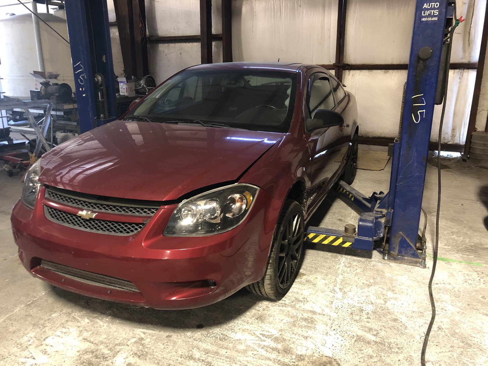

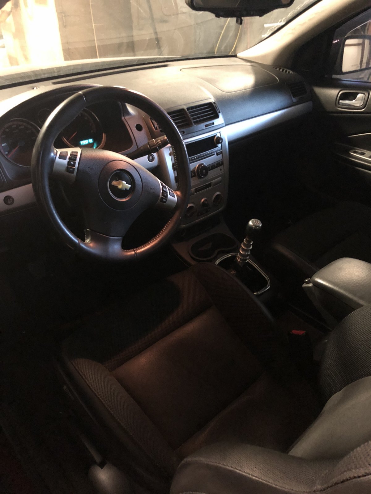

So in January I started searching for a donor. I wanted a turbo with less that 100k miles. Unfortunately I wasn’t patient enough to find a wreck that met my criteria. I found a 09 SS on eBay with 77k miles. The price wasn’t great and the car looked abused but since I wanted to rebuild the engine with forged components anyway and I couldn’t find anything else in the price range, I went ahead and bought it. The car came in even rougher than it looked in pictures however it ran well.

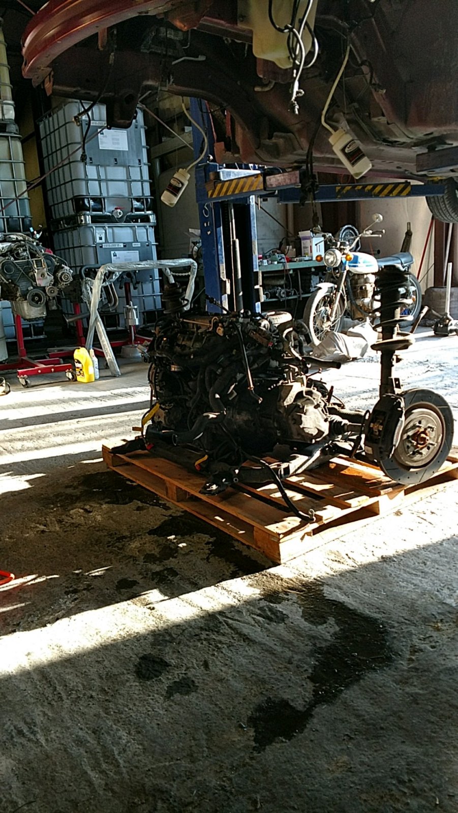

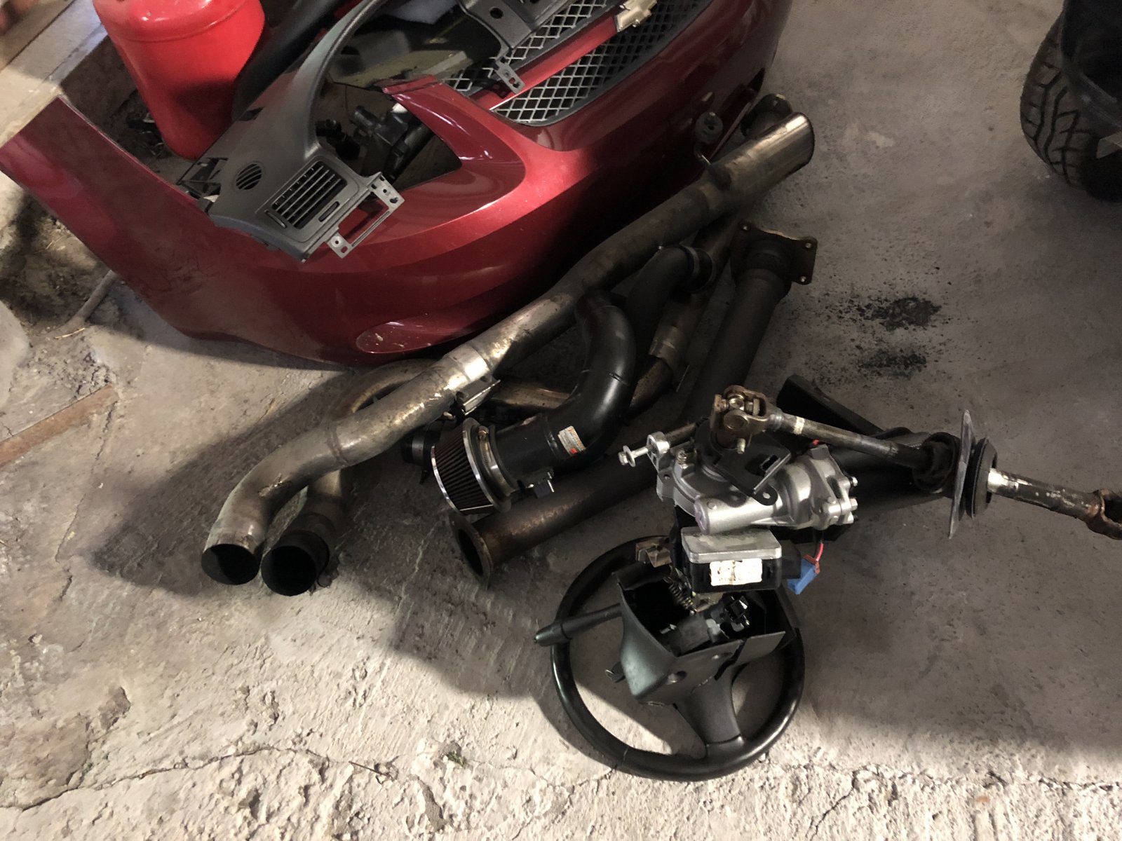

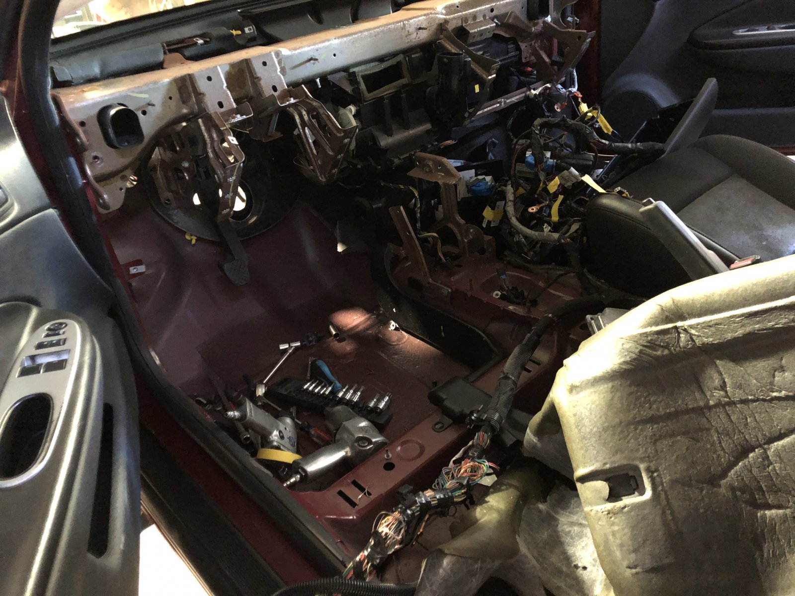

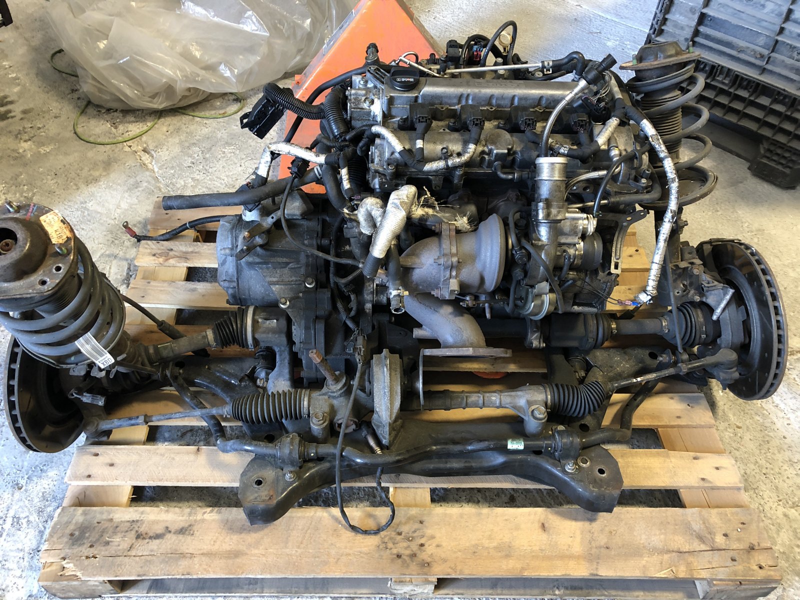

I employ a talented mechanic at my manufacturing plant so I have enlisted his help with the teardown and build as I am fairly inexperienced. So far it has gone well. We’re 6 hours of work in and getting close to finishing the teardown. My build will be very similar to dperkins build. I pick up the whole kit next Friday May 18th.

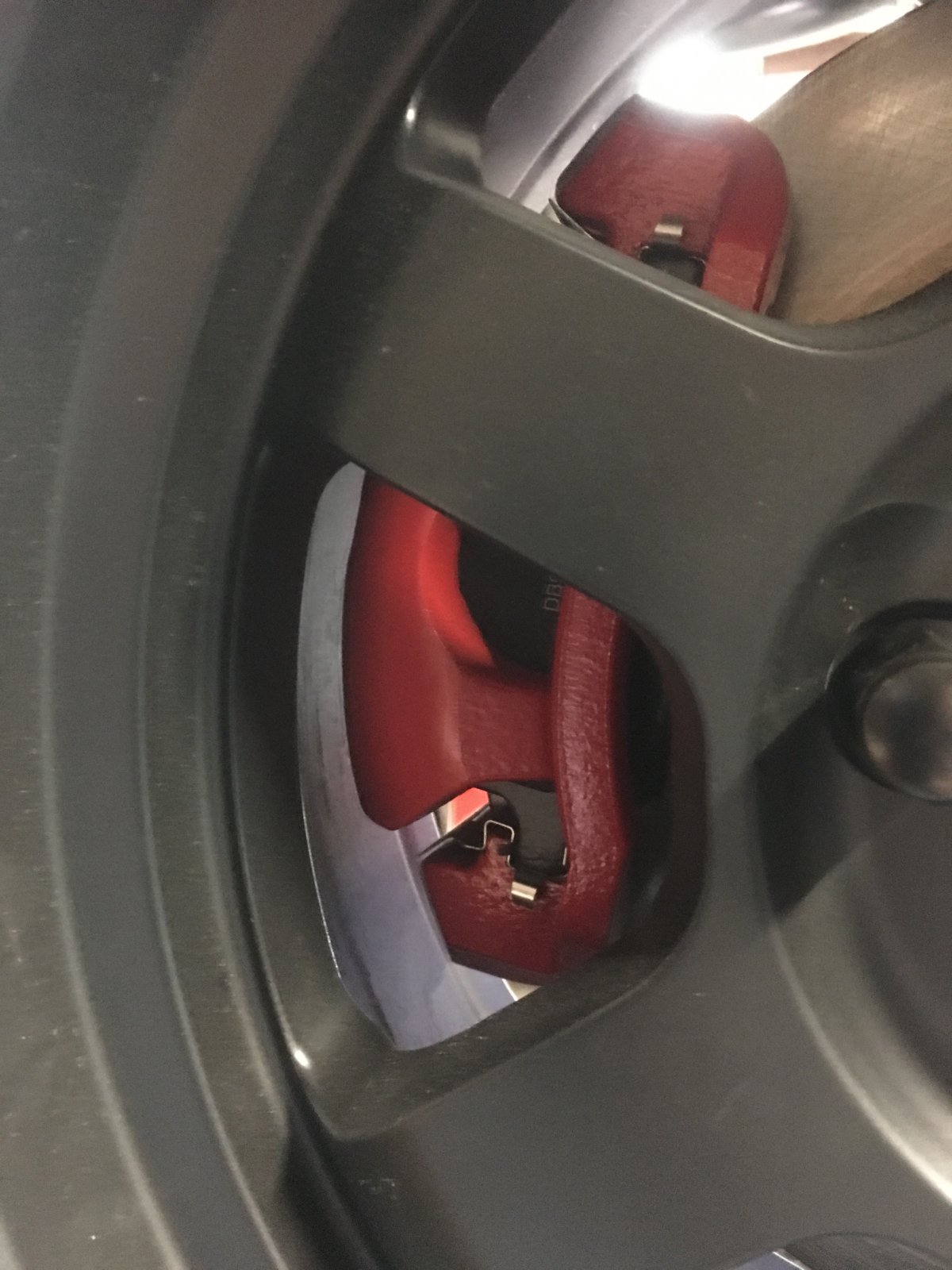

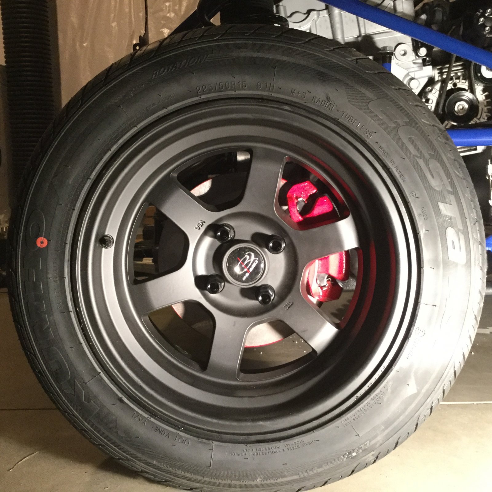

I really like the look of the 4x100 hubs and 15” wheels on my build “BLUE” but with all the interference issues with the front brake calipers I would not recommend them. Nate’s car we still are using 4x100 hubs but 16” wheels on the front (bolted right up no issues whatsoever.
15” Rota rim and wheel on my build. That is after re shaping the calipers and adding a spacer.
Nate’s 16” no where even close to hitting the calipers.

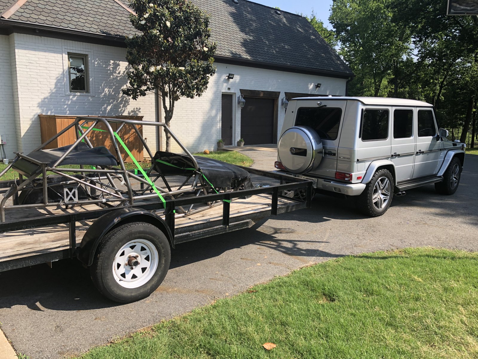

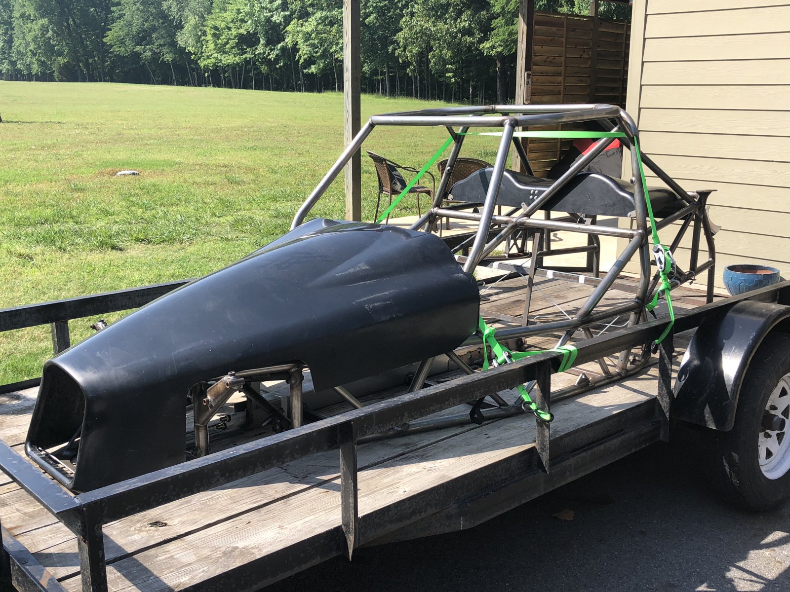

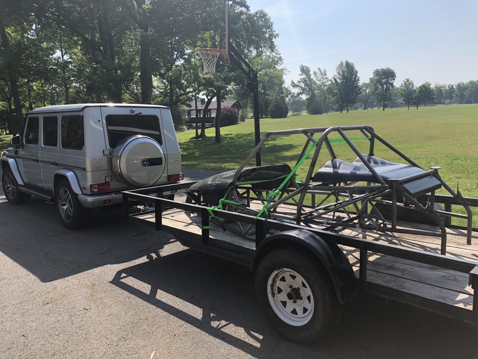

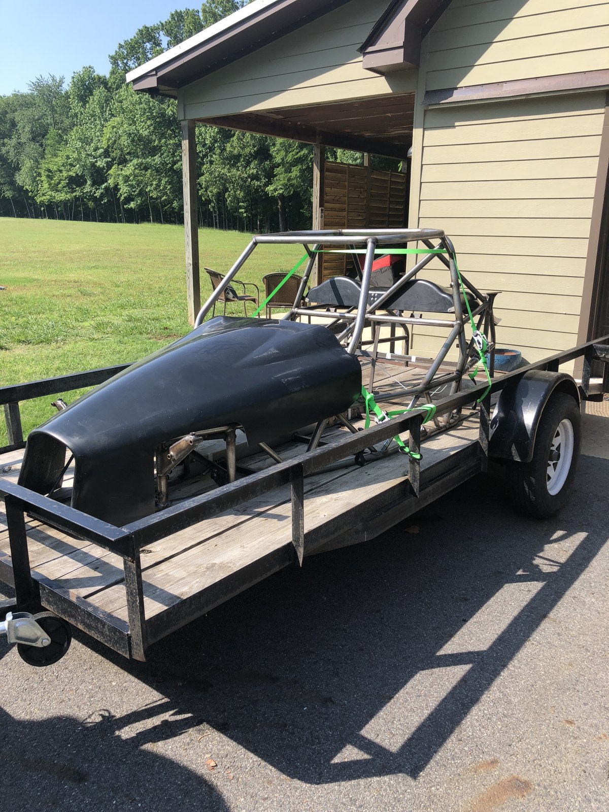

Picked up the frame and all parts! Anxious to get started with the build. Enjoyed meeting Adam and Lonny. They were very knowledgeable and clearly have spent an incredible amount of time developing and refining the design.
On another note I’m pretty sure I am now the record holder for worst fuel mileage while towing a Goblin
