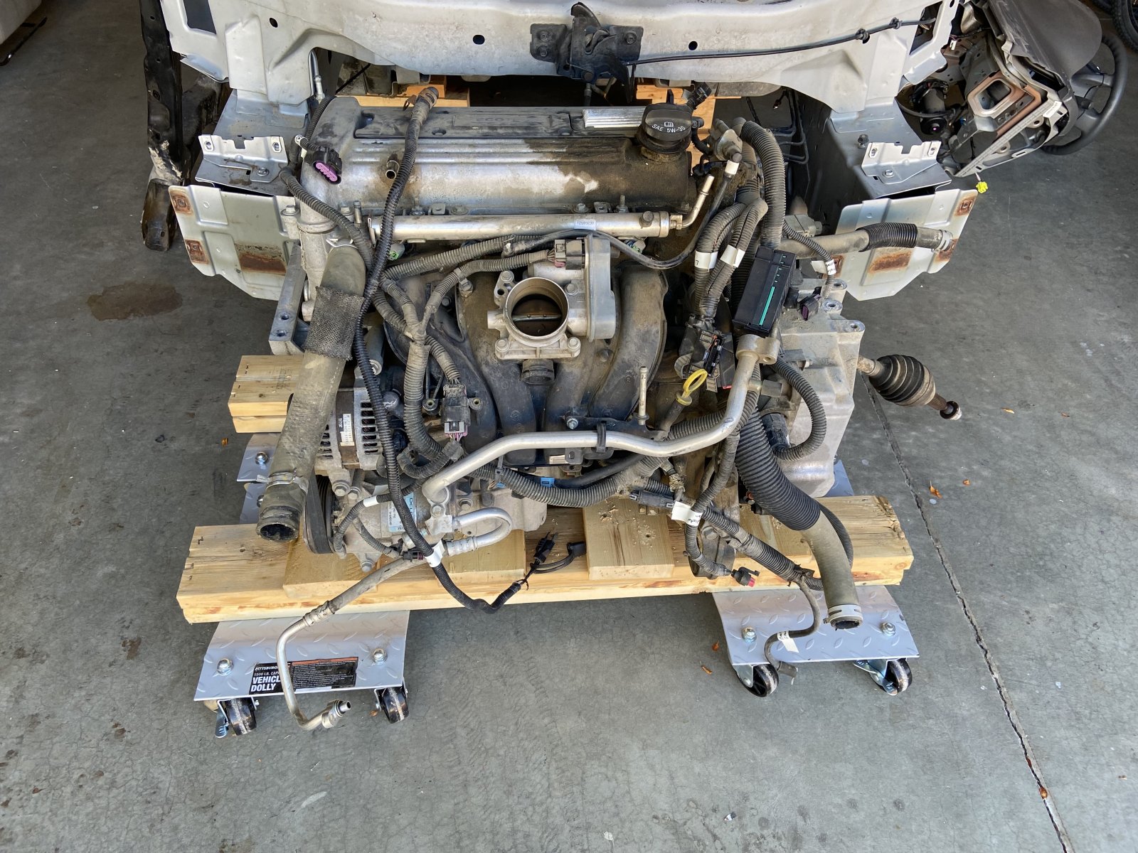

I am going to be cleaning the donor engine I just pulled from a 2005. I heard it both ways. Would I be okay to pressure wash that? Is the guidance different if the engine is out versus in place?
Tape off ports and other holes so water doesn’t get in the engine. Then be careful around all the electronics.
I used walmart plastic bags stuffed into each open port or hose, to keep water out. Degreaser, scrub brush, pressure wash, repeat.
GoblinGuyZ
Personally I dont think pressure washing an engine is ever a great idea. I would just spend the time with a brush and a good cleaning agent and then shower on a hose and repeat till I get it as clean as I want. Alot more control that way.
