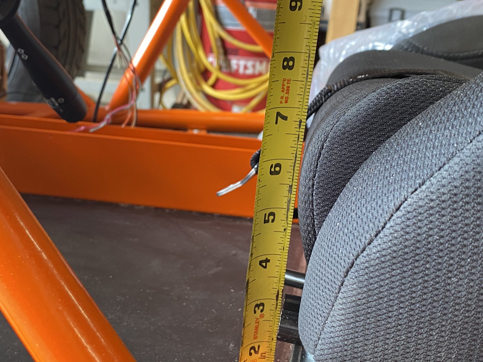

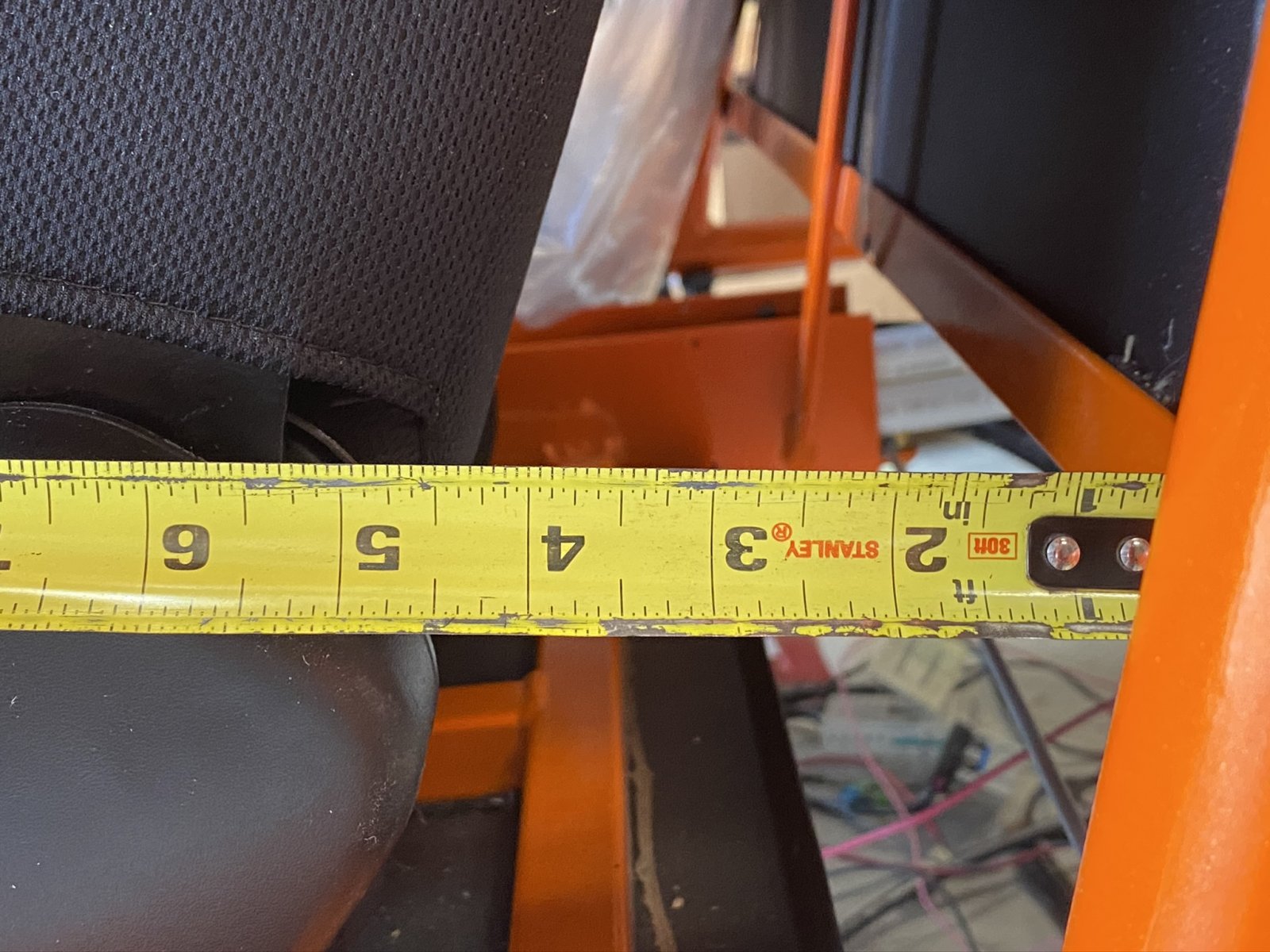

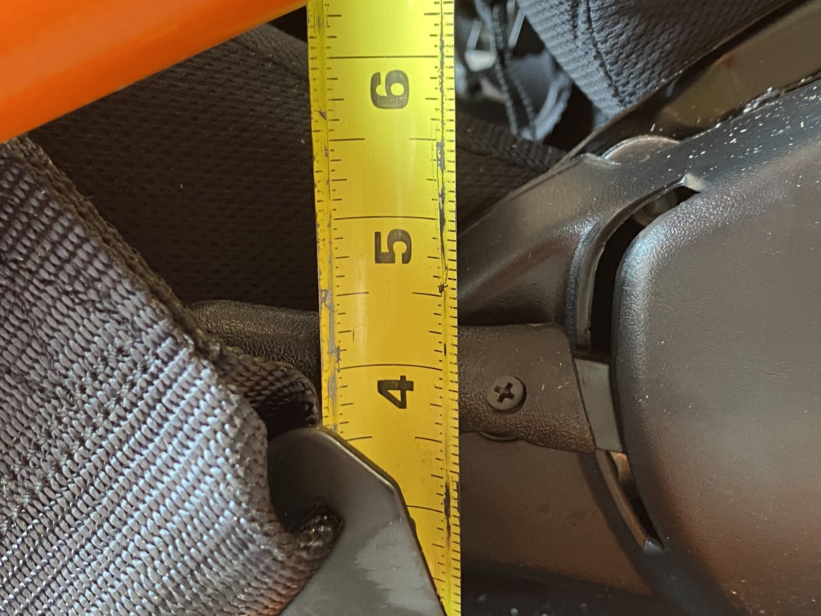

I have the A4 seats and their Cobalt sliders. Their sliders move the seat forward a few inches compared to the stock seats or the DF supplied seat brackets. I don’t think they’re taller than stock brackets but have not directly compared them. the FX1 holes might be in a different place...

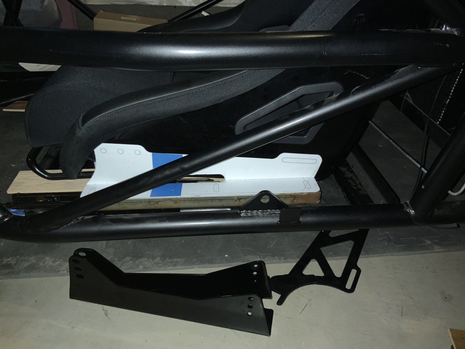

Take a look at my build thread... using stock sliders with FX1 seats...
View attachment 19141View attachment 19142
