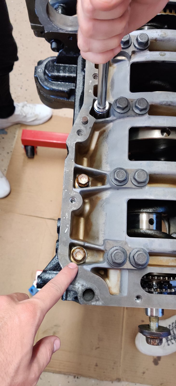

Hey everyone, there's two different bolts for the lower crankcase to main block. I know the inner bolts are 15ft-lbs then 70deg, but I can't find a torque spec for the outer 10 bolts.

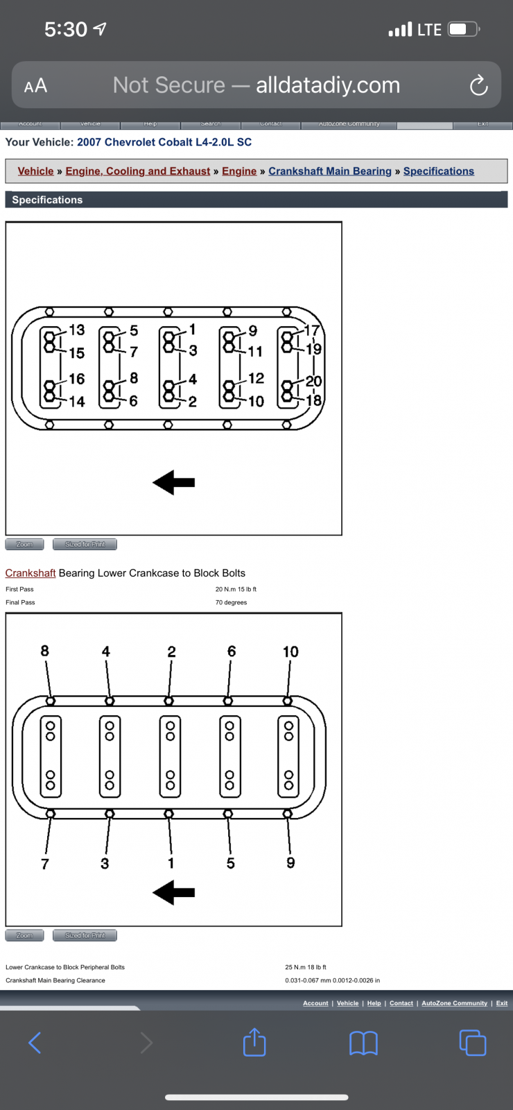

jayrolls
You should add your donor year and model to your signature. Make it easier to help look in ALLDATA. Here is what I have for what mine is, 07 SS/SC 2.0 LSJ.

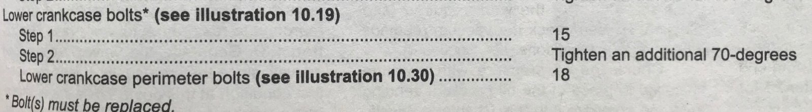

CaptFrank2001
That's the same Torque sequence from my Haynes manual for my 2.4L engine. Also says to use NEW Bolts. (Note: All in Ft. pounds)
