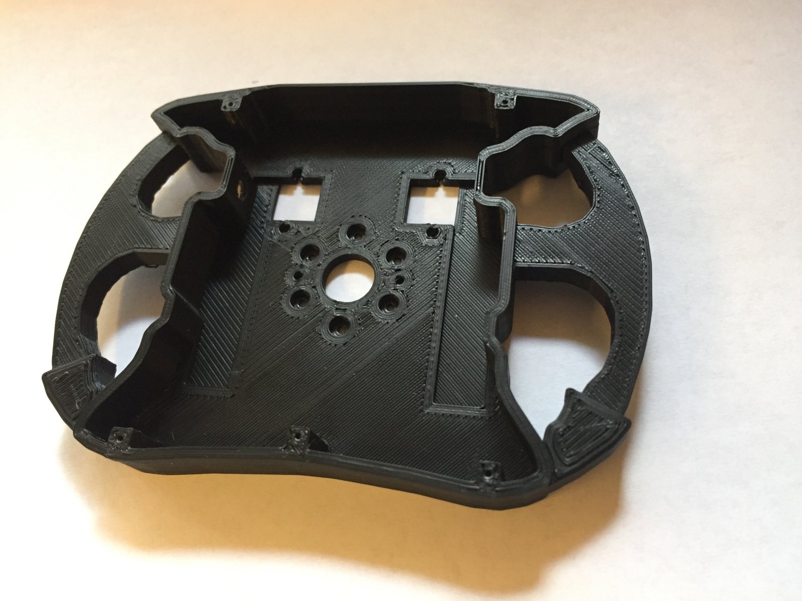

Oh my gosh I'm doing the exact same thing. Except I'm using an IPad for the display. I'm nearly done designing a racing steering wheel which has a 16 LED array corresponding to different RPMs and they are programmed to flash at redline etc. A smaller LCD on the wheel displays numerical RPM, oil pressure and water temperature.
Found a racing sim wheel online which I'm modifying a bit. Will have a flat carbon fiber faceplate to mount the knobs, LEDs and such kinda like and electric guitar pickguard ala fender strat.
I'm going to CNC a few prototypes out of plywood. Then hoping to eventually convince Adam to mill me one outta 6061 ;)

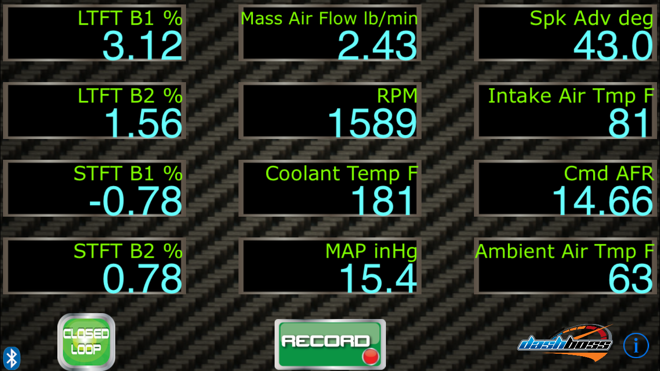

Also playing around with DashBoss. I don't think it will work as the main speedo/tach but misc values are logged pretty well.
This was playing around in my Ford.
(No idea why the spark advance is so high....)

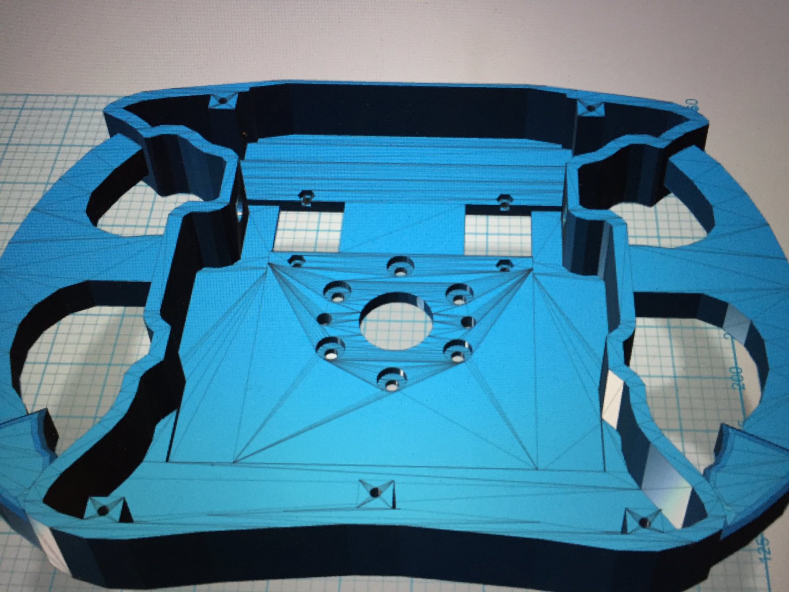

I printed a scaled down version for fun. My thought is I'll make the "handle" portion flat on all sides for easy machining. Then I will pin plywood to the handles like a knife scale. That way I can easily shape and contour it, and then wrap it in some nice tennis racket or handlebar tape.
Nuker do you have a specific screen you want to use? Maybe we could work together to get your Rasberry setup to display some info to a small screen on the wheel?

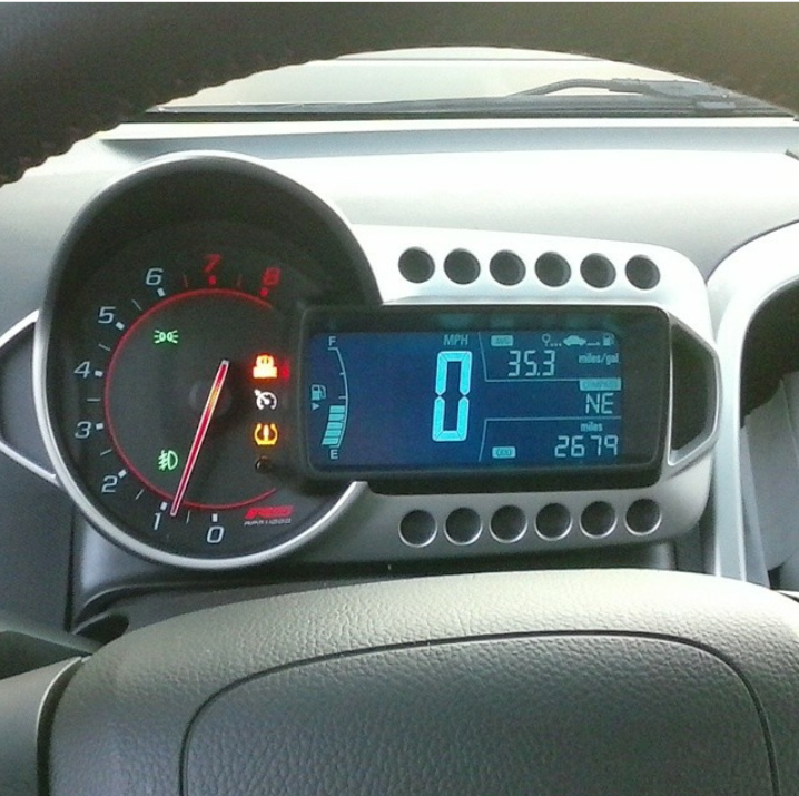

I really like the gauge cluster in my sonic rs, would be cool if there was a way to implement a different cars gauge cluster but i have no idea how or if it can be done lol
