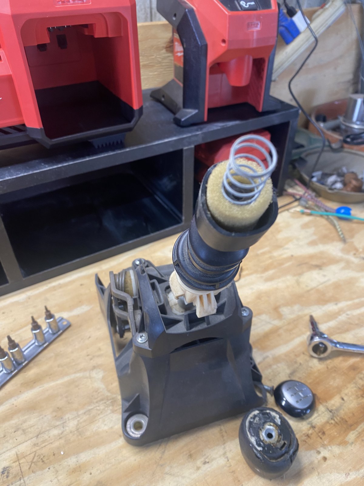

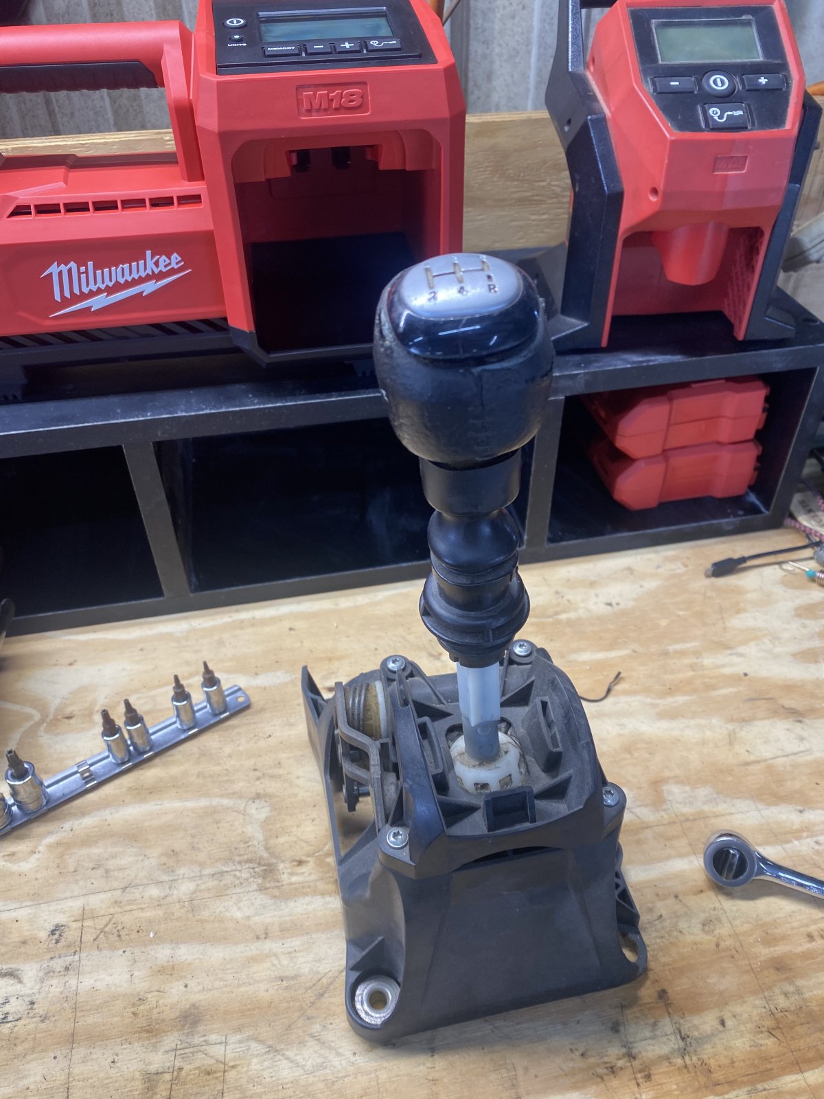

Is there a way to remove the reverse lockout mechanism on the stock shift unit. It’s annoying and would be really hard to shift into reverse while driving.

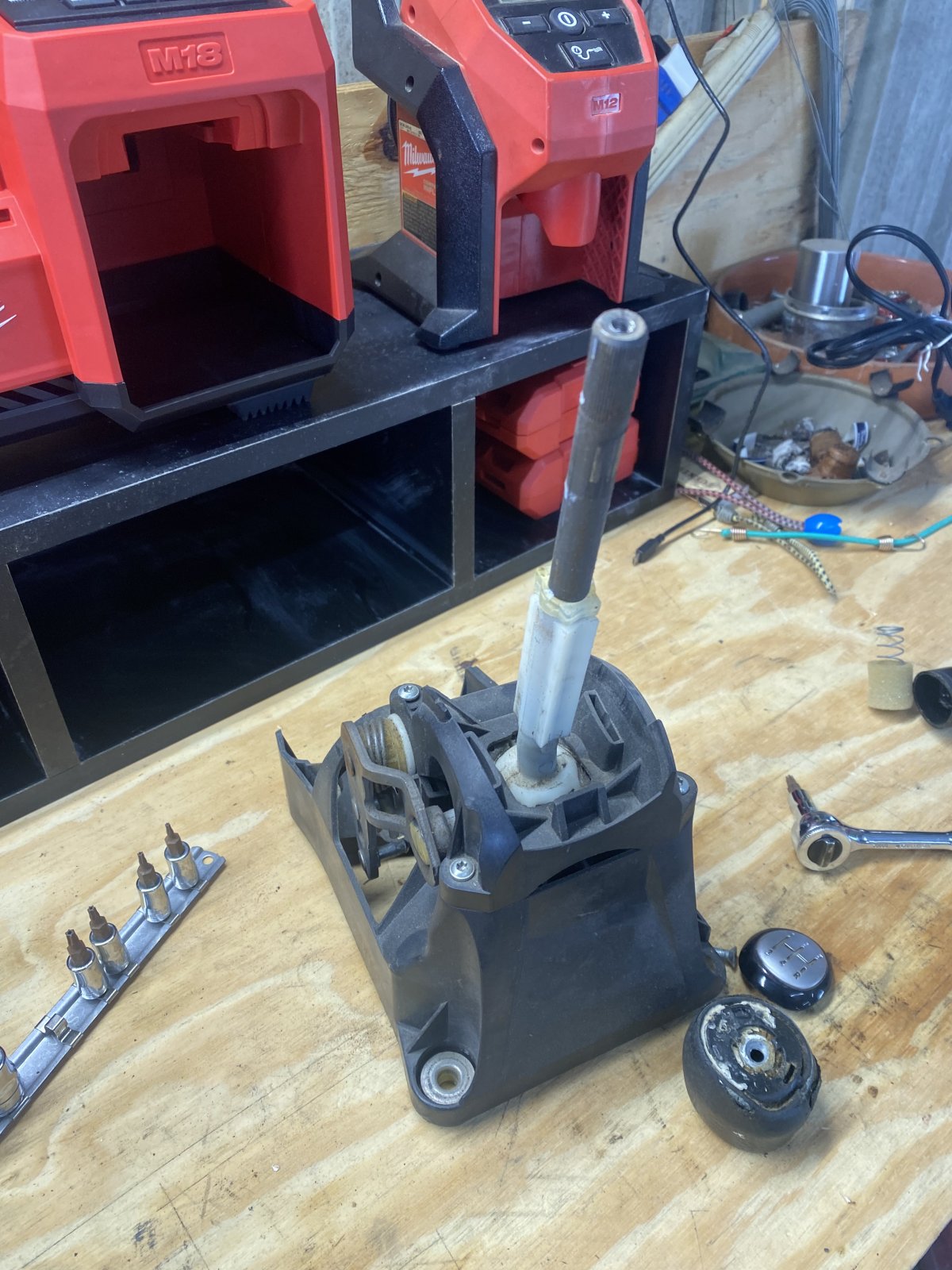

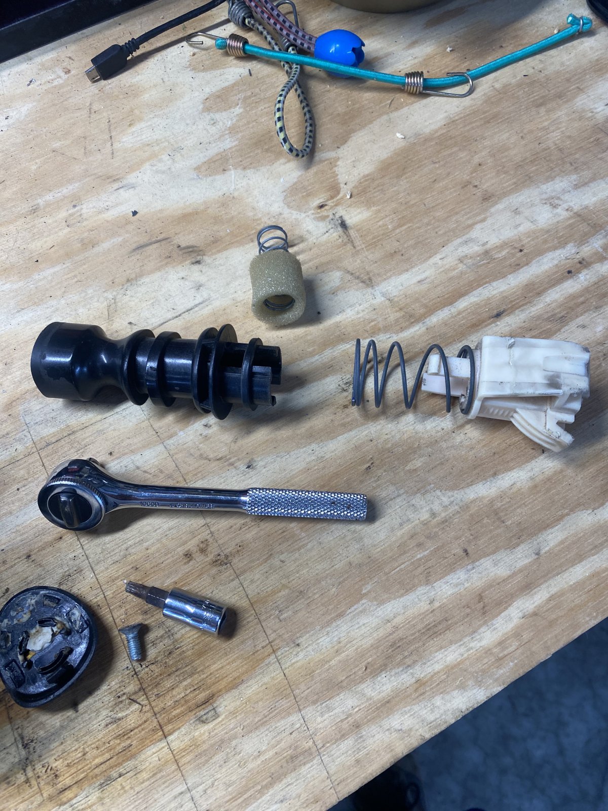

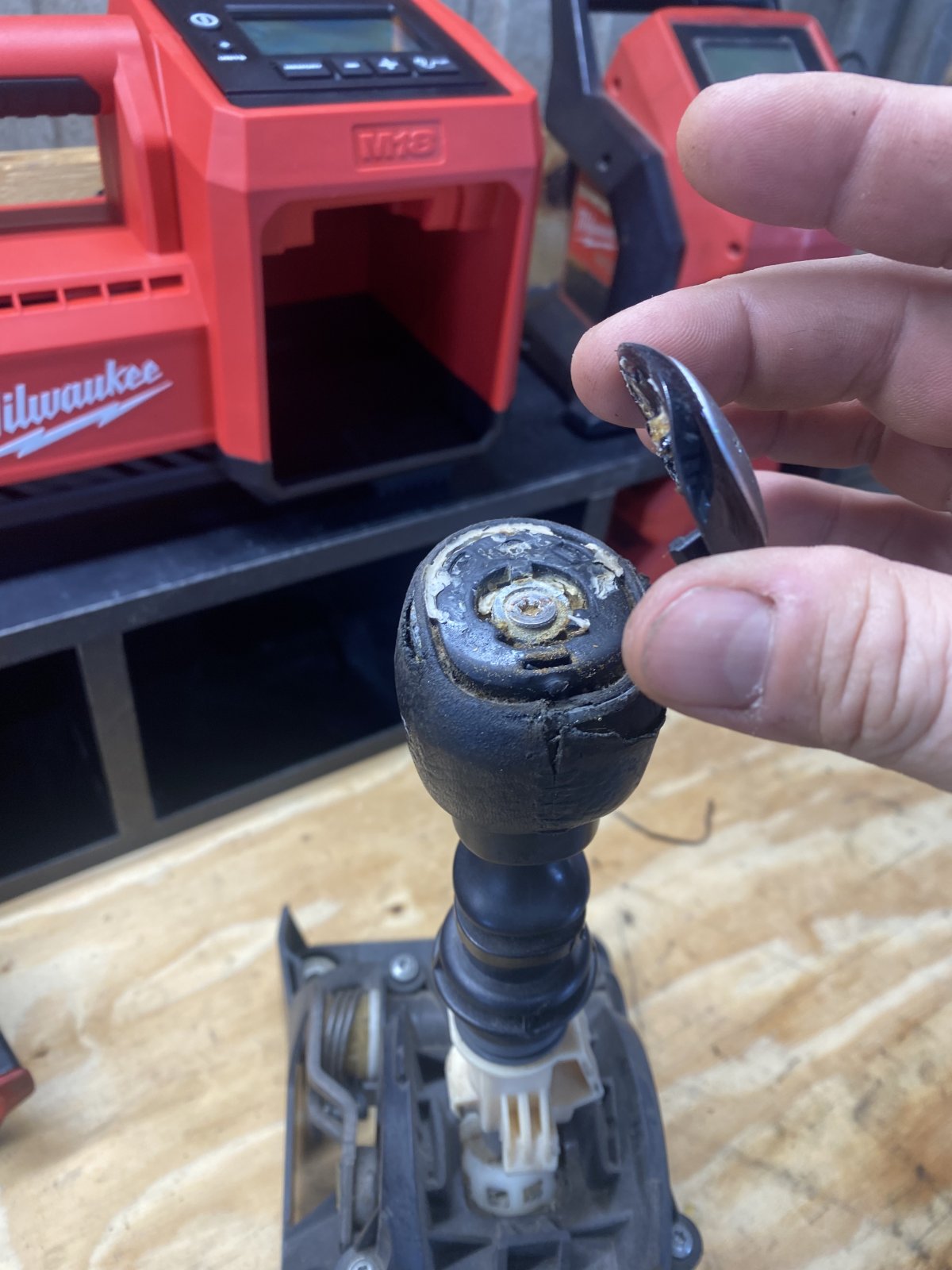

Fairly easy. Remove boot, if you have one. Pry off the shift cover, remove screw, pull knob. Then pull the interlock thingy off, remove bottom piece and go back together with it.

I wouldn't remove it, that's going to make finding 5th more difficult. Without the lockout you'll be able to push the shifter further to the right than needed to get into 5th.
